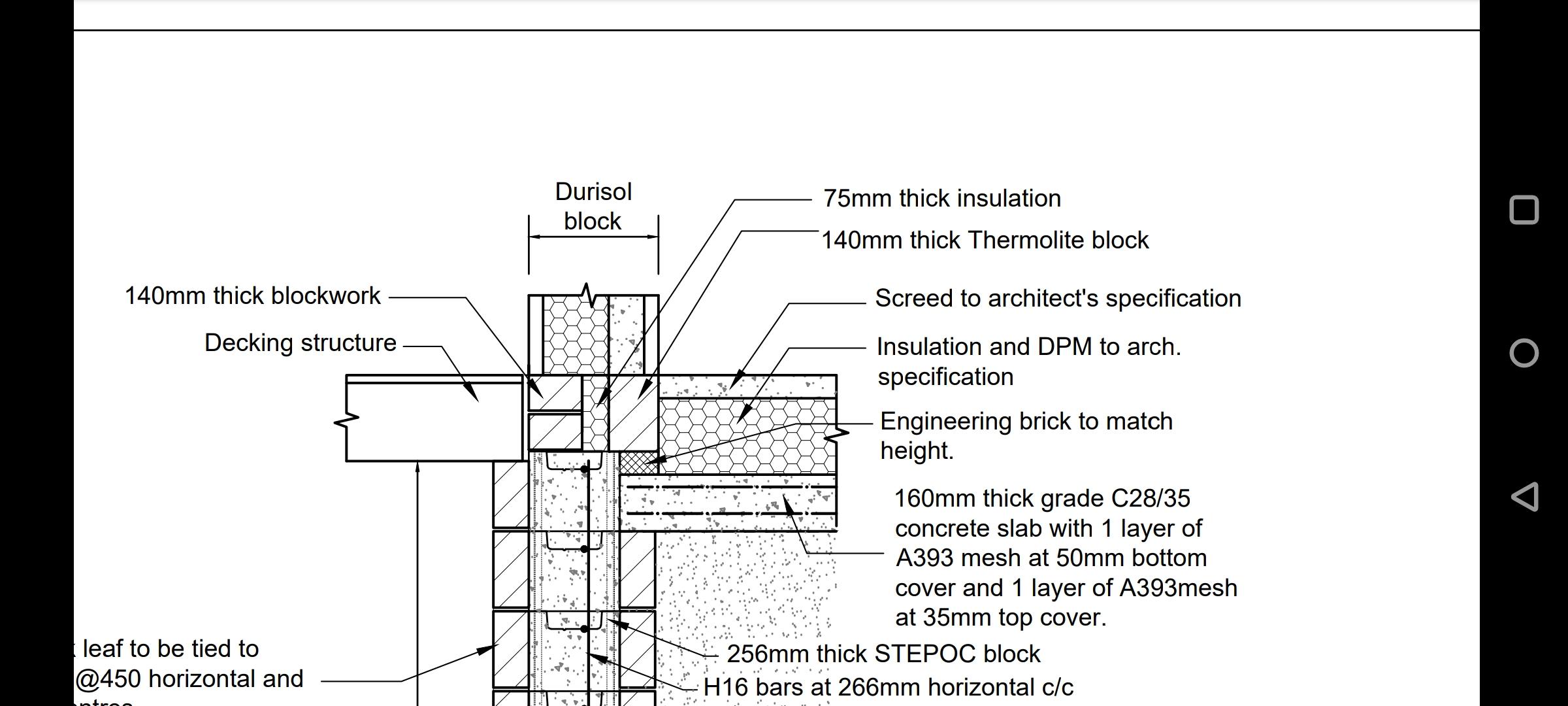

We couldn't find anyone up here so decided to do a modified version of some more traditional. We are on a sand hill so lots of belts and braces added. But a simplified version of this is doable with local labour for not much cost wise. Pretty much thermal bridge free. Not shown is a 70mm upstand I added to screed edge. Used 200mm of PIR insulation under a fibre reinforced concrete screed 100mm thick.

@Kelvin that's very generous of you, thanks! Will keep this in mind, though we're months away from digging.
@JohnMo thanks for sharing this, appreciated! It is looking like I'll probably have to go in this direction ultimately.
Cost wise, it's interesting.
The EPS formers aren't really very expensive (<£10K from all the suppliers who quoted on my 138m2 GF build) and really I'd be buying nearly as much sheet EPS for standard foundation insulation, other than the thickness of the upstand.
Suspect this will be more than ballanced by the cost of insulating blocks (marmox, mannok etc) - roughly £2k for my permieter, assuming I only need 1 block wide (MBC frame is 300mm wide - maybe it can overhang and I can have more upstand insulation internally?)
The concrete slab component may be 40mm thinner in the diagram above than a kore raft, which on my build would only be 5.5m, so £825 less.
Both require 2x A393 mesh layers.
The underbuild for the kore raft would be 800mm deep MOT3 & 50mm sand blinding on my plot. For me that's 110m3 so about £5k. No idea what trench dimensions or blockwork would be required for a more traditional found (my perimeter & internal load bearing walls are about 80 linear meters).
Then there's the top screed layer in the trad build.
I really wonder if it will work out pretty similar materials wise, and I'd be happy to pay a small premium for the easy to achieve U value of 0.1W/mK. It's just the lack of experienced contractors that causes the issue. Or my lack of bravery to go DIY 😕.
Did all the calcs and just couldn't justify Marmox as they adding nothing in real terms from the design I posted. The Thermolite blocks are in a dry space so thermally stable and twice the height of marmox.
Ours came out at 0.09 U value. As I said our was a standard ground work contractors, doing most of it, but I did all the insulation and UFH, they can back concreted over the top.  I then built the walls.
