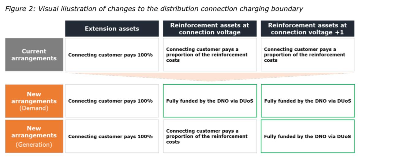

garrymartin Posted May 1, 2024 Posted May 1, 2024 The whole charging structure changed on 1st April 2023 - you have to pay for extension assets (connection) but should not have to pay for reinforcement assets (cable and transformer upgrades). https://connections.nationalgrid.co.uk/significant-code-review/ 3

New to this Posted May 2, 2024 Author Posted May 2, 2024 10 hours ago, garrymartin said: The whole charging structure changed on 1st April 2023 - you have to pay for extension assets (connection) but should not have to pay for reinforcement assets (cable and transformer upgrades). https://connections.nationalgrid.co.uk/significant-code-review/ Thank you for this - how can I tell whether it's classed as extension or reinforcement, as clearly it's better for me if it comes under the latter ... should I be asking them to increase supply provision to my existing home here perhaps (as new build is in garden)?

garrymartin Posted May 2, 2024 Posted May 2, 2024 Be careful that when I asked National Grid (Western Power) for an estimate, they included all the network reinforcements on my estimate. When I challenged that, they said they always include them on a desk-based estimate and I'd need to formally request the connection to get the more accurate cost that would just cover the extension assets. Seems to me to be a mechanism for putting people off that don't know about the charging structure changes...
Kelvin Posted May 2, 2024 Posted May 2, 2024 (edited) 51 minutes ago, New to this said: Thank you for this - how can I tell whether it's classed as extension or reinforcement, as clearly it's better for me if it comes under the latter ... should I be asking them to increase supply provision to my existing home here perhaps (as new build is in garden)? Regardless the new legislation states you don’t pay for the reinforcement just the extension assets. It’s a new connection to a new property (demand). Here’s a link to the full decision. My first quote £26.5k which I contested and this reduced £5k as they admitted they’d made an error. The final bill was £450. https://www.ofgem.gov.uk/sites/default/files/2022-05/Access SCR - Final Decision.pdf Edited May 2, 2024 by Kelvin 1
Kelvin Posted May 2, 2024 Posted May 2, 2024 This explains the difference between extension assets and reinforcement just in case it’s not clear. https://roadnighttaylor.co.uk/connectology/network-reinforcement-and-network-extension/#:~:text=Extension assets are new assets that are used to connect,where the metering is located
