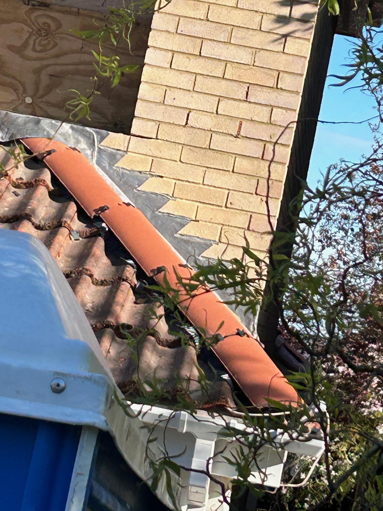

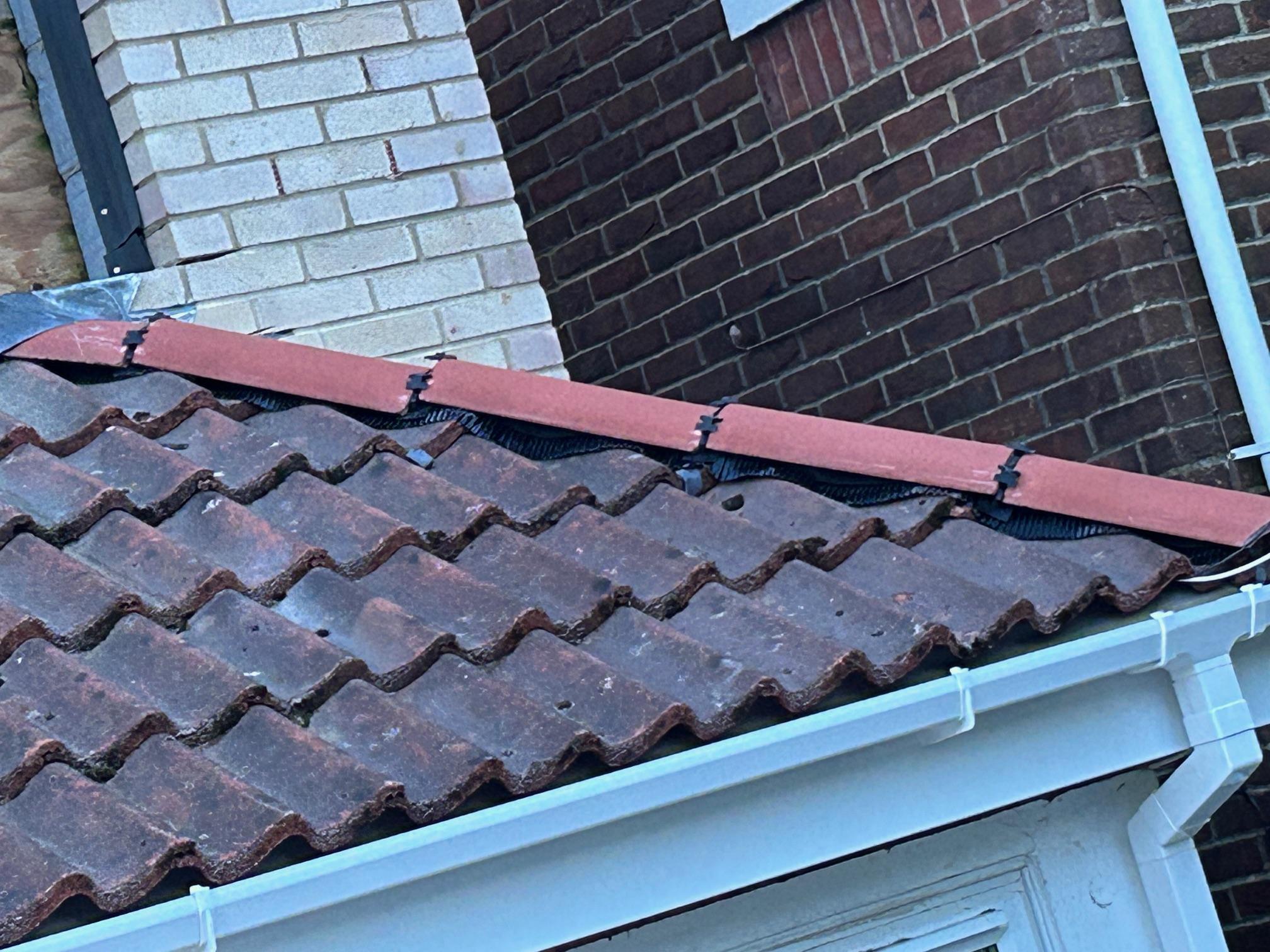

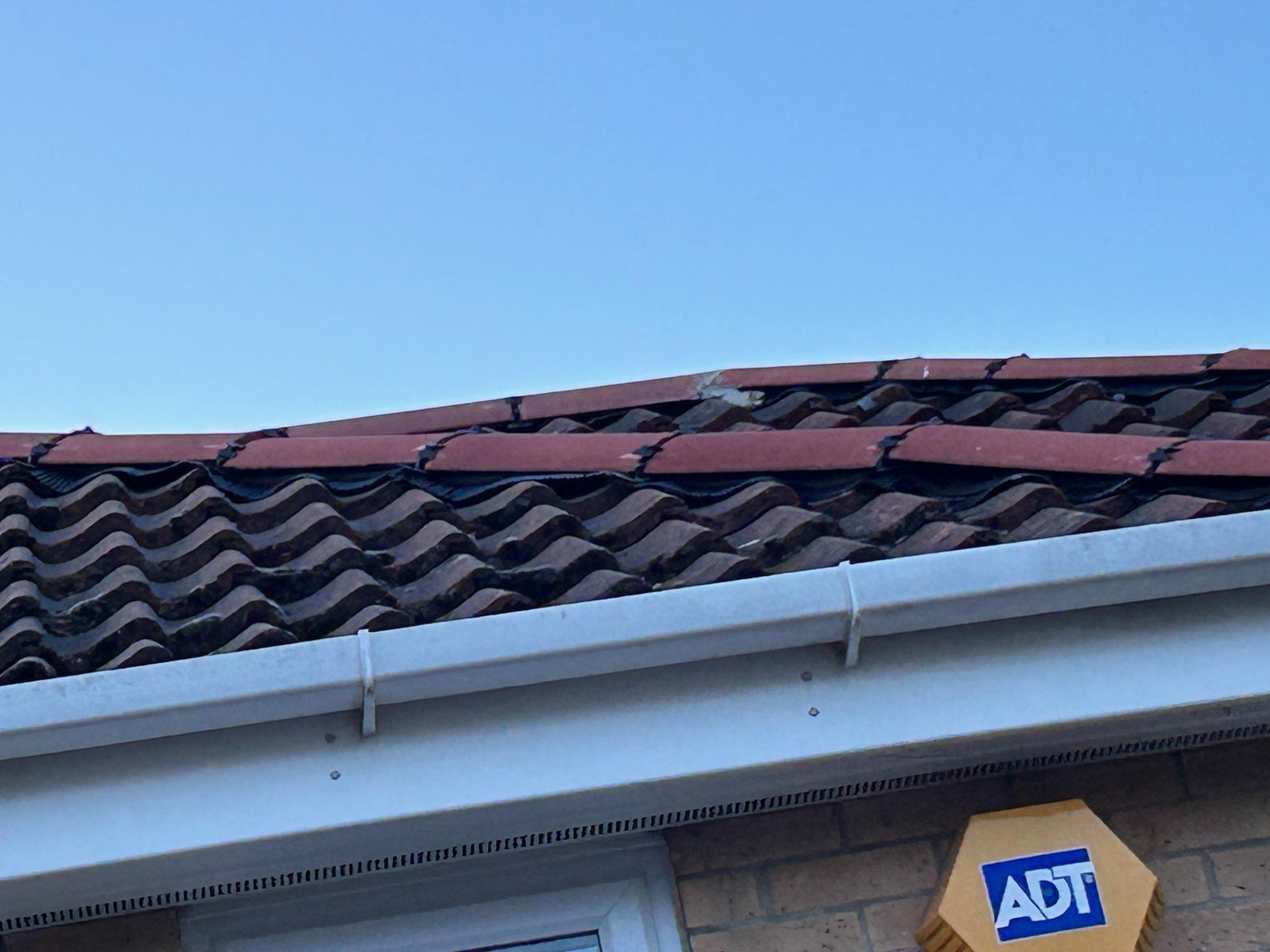

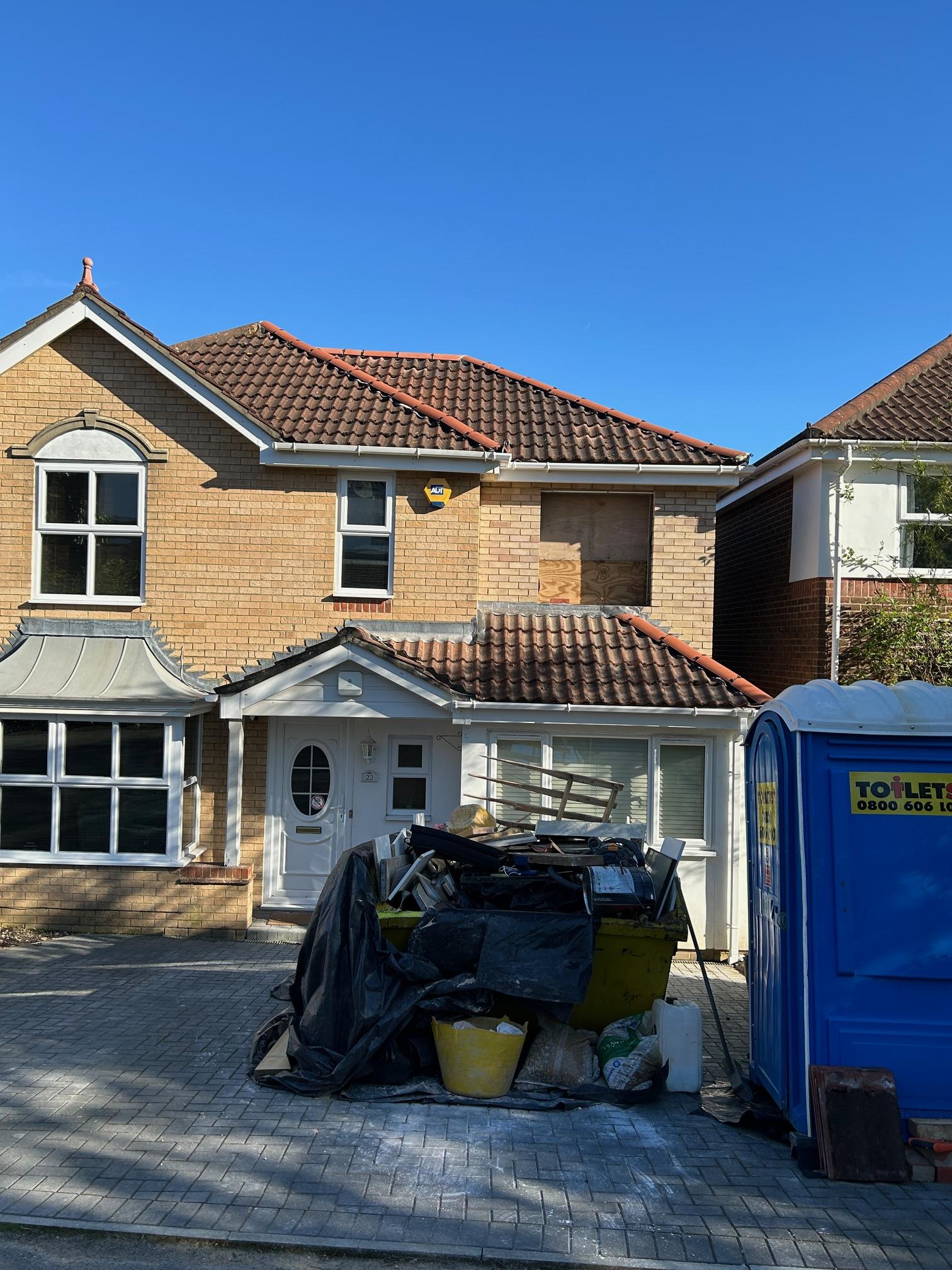

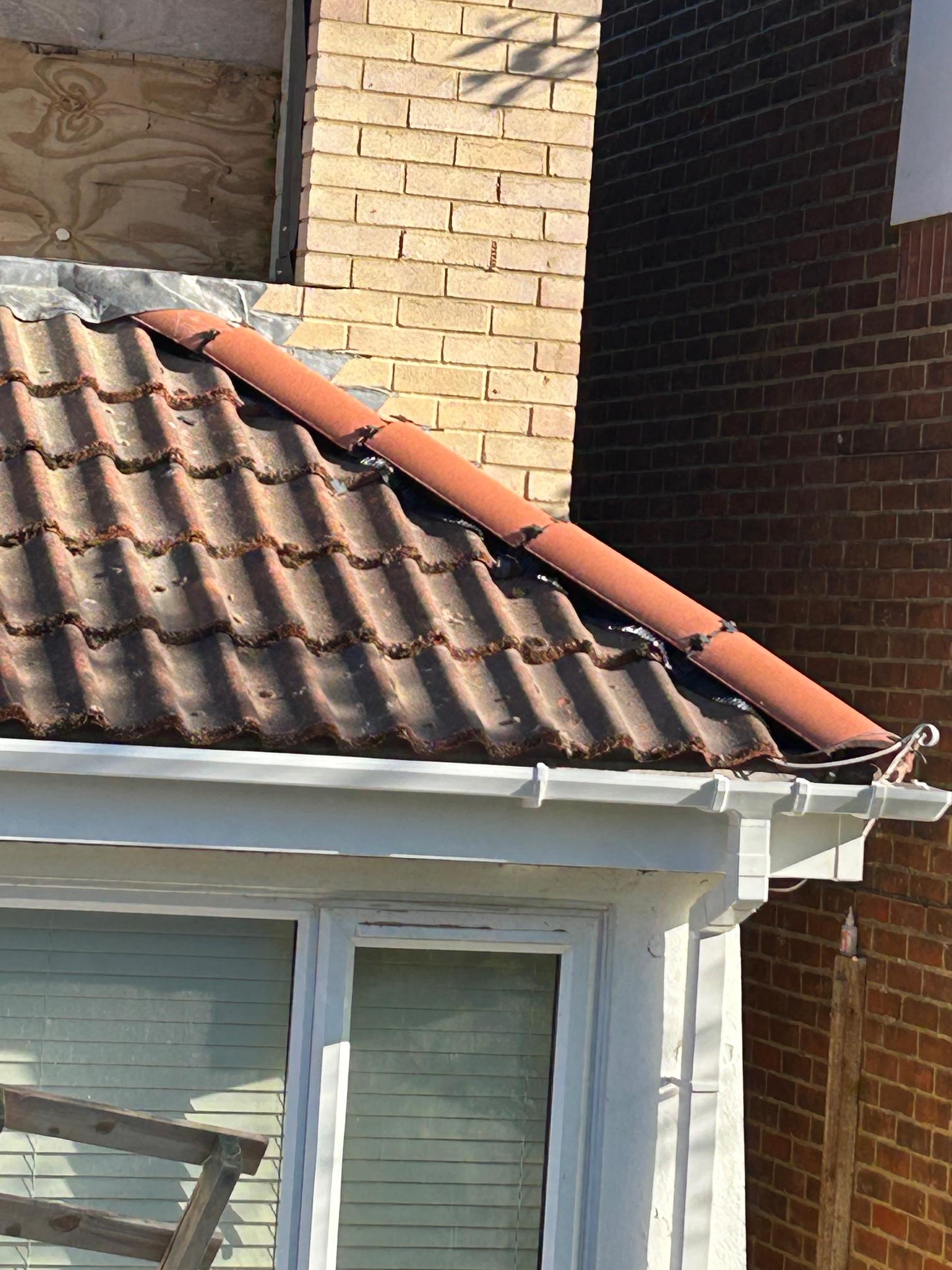

mark2123 Posted April 30 Share Posted April 30 (edited) Hi. I joined today to try to gain some views/advice from those more knowledgeable than me (I know nothing about building work) on some work that I'm having done to create a first floor extension on the side of the house. The builders have almost finished the work and are currently doing the inside. From the outside, I don't feel that the ridge work is of a good quality. They have rebuilt the roof over the extension (on the right) and added new ridges to the top of the house. The ridge colours are very different from the tiles so it draws your attention to them, and then, there is questionable quality. I was not consulted in any decisions re tiling, colours, styles etc as I'm a layperson and I trusted my builder to ask me any relevant questions - they had the architect's plan and they have gone off that and appear to have mostly re-used existing tiles from the deconstruction of the original roof that was on top of what was an integral garage conversion. Now that the scaffolding has been removed, not only does it feel like the ridges stick out like a sore thumb, but they don't appear to be straight, level or flush. Are my expectations too high and is this something that can happen when the whole roof isn't removed and built from scratch, or is this workmanship that I should not be accepting? As I'm not a builder/roofer, I would be interested to know if this kind of look/work/outcome should be challenged? Thanks. Edited April 30 by mark2123 Link to comment Share on other sites More sharing options...
stu w Posted April 30 Share Posted April 30 (edited) Colour match aside , the work looks poor from the photos Edited April 30 by stu w 1 Link to comment Share on other sites More sharing options...
Mr Punter Posted April 30 Share Posted April 30 The ridges don't look great. The one on the lower roof looks really dodgy. I would not worry about the colour. Link to comment Share on other sites More sharing options...
joe90 Posted April 30 Share Posted April 30 Poor? That’s really crap, I have done many re roofs including ridges and hips and cannot believe anyone calling themselves a builder would leave it like that. Ref colour what did the architects say, new or reclaimed ridge;hip tiles? I hope you have not paid them yet? Link to comment Share on other sites More sharing options...
Redbeard Posted April 30 Share Posted April 30 I think lots of BCOs are requiring 'dry' and mechanically-fixed ridge tiles now. You may have to live with the colour, but I am a believer in straight lines... Do you know the make? If so send pics to the manufacturer and ask if that complies with their expectations. Then invite the contractor back to tell you to your face that that is a good job. 1 Link to comment Share on other sites More sharing options...

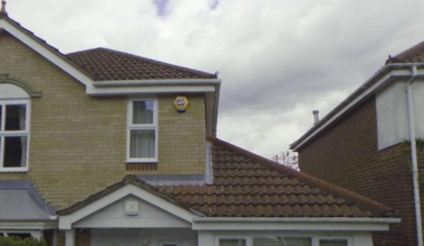

mark2123 Posted April 30 Author Share Posted April 30 This is how neat and tidy things looked before the work began. Link to comment Share on other sites More sharing options...

Redbeard Posted April 30 Share Posted April 30 4 minutes ago, mark2123 said: This is how neat and tidy things looked before the work began. Yes, but they appear to be 'wet-fixed' ridge tiles, which seem to me to look soooo much better than dry-fixed. Link to comment Share on other sites More sharing options...

EdHat Posted May 1 Share Posted May 1 It is going to look different as you've got dry ridge/hips now whereas previously you had a wet system (bedded on mortar). The British standard now requires ridges and hips to be mechanically fixed which is best achieved with a dry system, with wet systems generally only now used for repairs. You've quoted the planning permission but what did the architect's plans state regarding materials and fixing method? I wouldn't worry about the difference in the actual appearance of the tiles as they will weather in over time. The installation looks poor though. Note the following: - The hips shouldn't be unaligned like that. If they've fitted a hip batten I don't understand how that would have happened. - They haven't clipped the cut tiles along the hip. I can see what looks like 2 lead tingles, one is loose, but every cut tile should be clipped at bottom and top. - There are large gaps between the membrane and tiles which will be vulnerable to driving rain. The membrane should be dressed to and adhered to the tiles below. - The chases for the stepped lead flashings haven't been fully sealed. - Flashing looks like it might be too long and there isn't enough cover down over the tiles, particularly on the hip. Max length (assuming it's code 4 is 1500mm and there should be min 150mm cover over tiles. 1 Link to comment Share on other sites More sharing options...

Mjb Posted May 2 Share Posted May 2 I suggest you get the builder to put hip support trays under the ridge tiles, doesn't look like any are fitted. Link to comment Share on other sites More sharing options...
