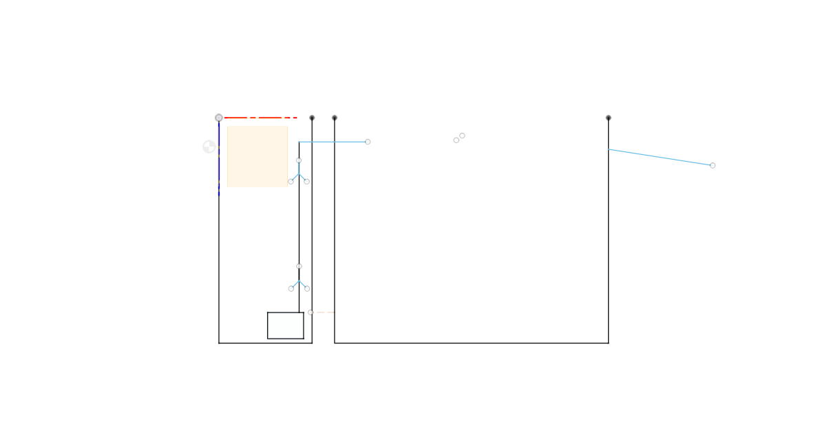

jpadie Posted April 30, 2024 Author Posted April 30, 2024 thanks both! 5 minutes ago, ProDave said: Yes almost certainly the capacitor, the question is how easy is it to access. Is it a submirsible pump? the pump is submerged in a 7m sewage pit. pumps out to town waste. however the control box is in the basement about 50m away. easily serviceable. which is annoying as I spent yesterday afternoon pumping out the sewage pit and lifting out the pump! the pumps mates with a concreted-in union and getting it to drop back precisely onto the mating pins is not something to do when the household has a swear-box policy. an irony is that this sewage pump went at the same time as a rain water evacuation pump. I serviced that yesterday too - working now but I discovered. that the cistern into which the rain water is pumped has magically sprung a hole into the sump. so the pump is pumping happily but the water is going straight back in the bottom (pic below). quikcrete it is, I think. at least that explains the higher than normal leccy bills.

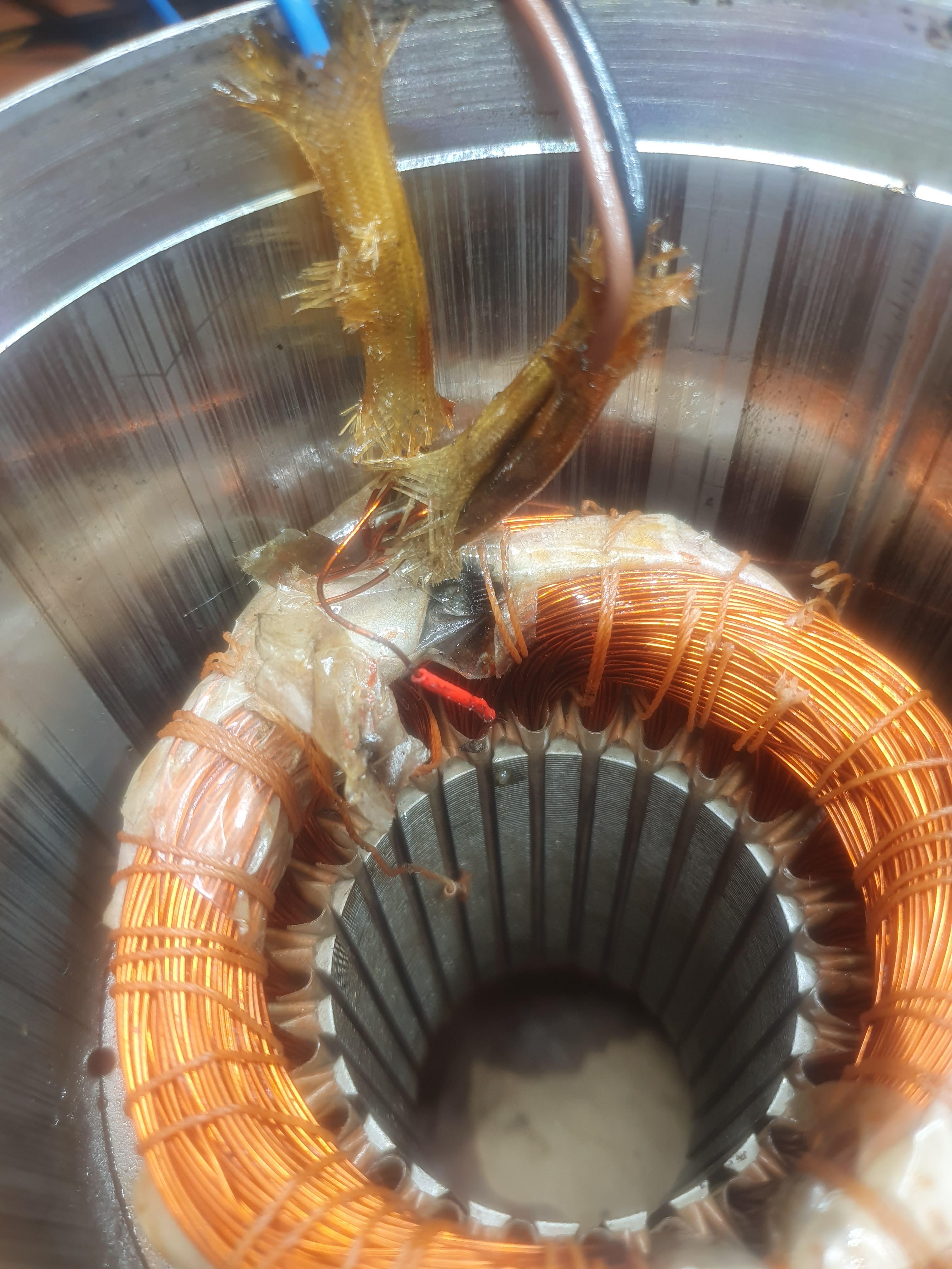

jpadie Posted May 1, 2024 Author Posted May 1, 2024 The pump came to bits surprisingly easily. Difficult to manhandle a 25kg pump whilst being delicate about disassembly. Even with the "foot" removed it's 18kg. In all the many times I've tried to chase faults in motor coils I've never been successful. This time I found the break close to the neutral and was able to create a good solder joint. The wire around the area is blackened and I don't know how compromised it is. The coil resistance is 7Ohms which is twice the other one. I've not tested black to brown (resistance across both coils) but that would be an interesting measurement to have. I will test the pump tomorrow. Fingers crossed it's resurrected.
jpadie Posted May 2, 2024 Author Posted May 2, 2024 22 hours ago, ProDave said: Keep us posted. Amazingly it all worked! The rotor was in perfect condition and the oil still clear and non viscous. Not bad for 15 years under water. Hopefully a new lease of life for a few more years 2
