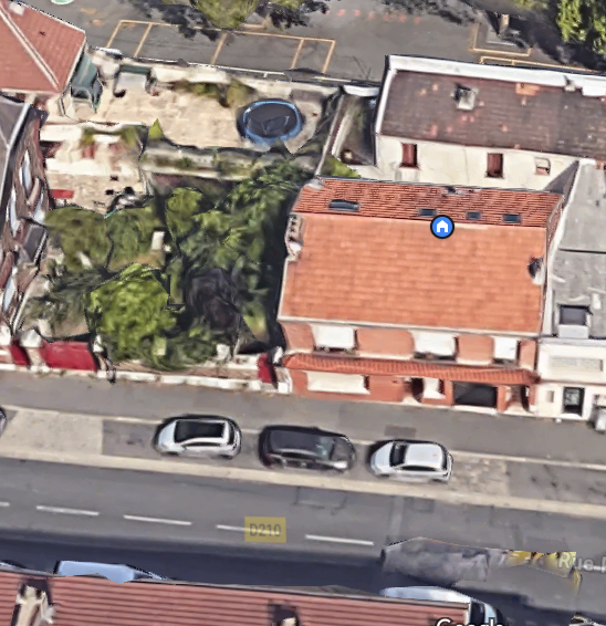

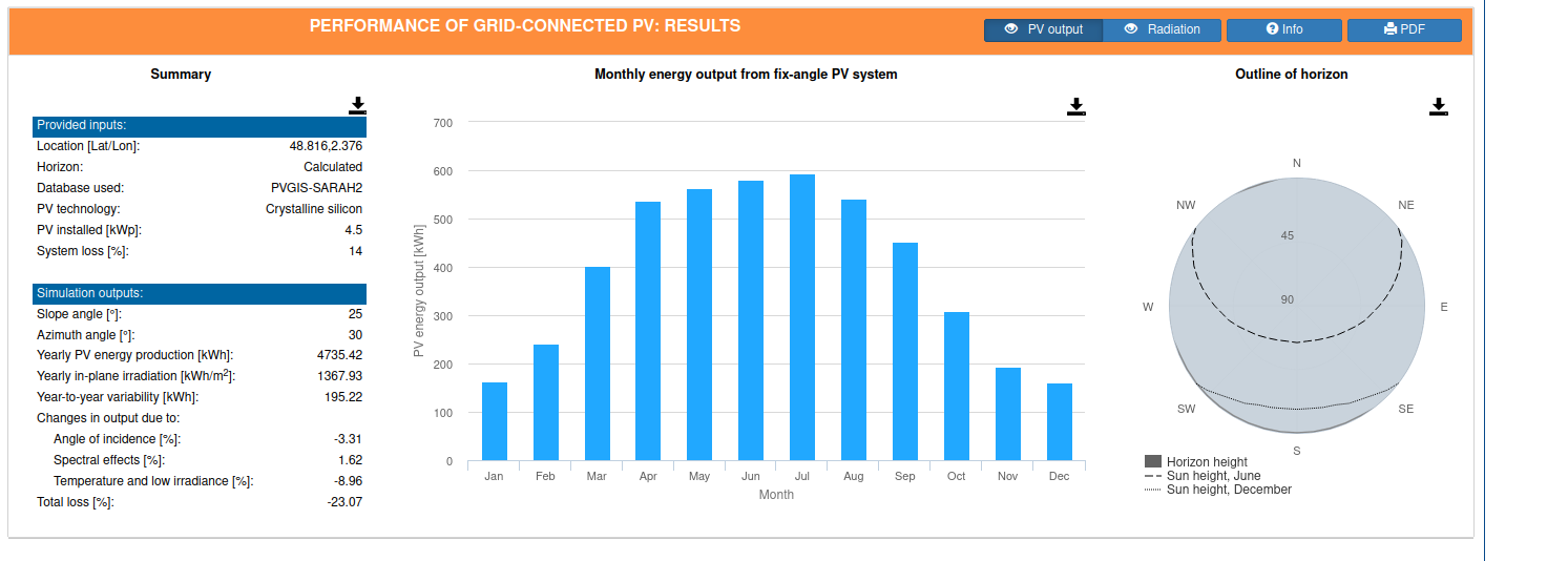

Garald Posted April 30, 2024 Author Share Posted April 30, 2024 (edited) 18 hours ago, SteamyTea said: Check out the prediction with PVGIS. This is what I get from PVGIS for a system with 4.5 kW peak: Is this too much? Roughly right? My consumption should stay beneath what is portrayed here except for December and January. I don't expect much shading. This is my place - or that this is what it looked like from above, before I put in a fair number of additional skylights, postly on the NWN side: I mean the red brick house. (The garden is not mine). Edited April 30, 2024 by Garald Link to comment Share on other sites More sharing options...
Garald Posted April 30, 2024 Author Share Posted April 30, 2024 Sorry, I meant: My consumption should stay beneath what is portrayed here between March and October Link to comment Share on other sites More sharing options...

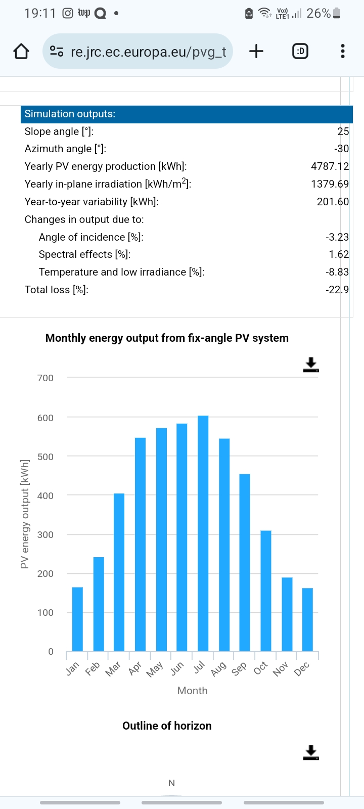

Dillsue Posted May 1, 2024 Share Posted May 1, 2024 Your azimuth figure should be -30 for a SES facing roof but that's not going to make a huge difference. Remember that to use PV, without batteries, you need to use it when the sun is out and generating. If you or your guests are out during the day and back in the evening to cook/wash etc then you'll be exporting lots of surplus PV during the day and importing in the evening. The only way to more accurately compare your usage with forecast generation is to use hourly figures. Link to comment Share on other sites More sharing options...
Garald Posted May 1, 2024 Author Share Posted May 1, 2024 11 hours ago, Dillsue said: Your azimuth figure should be -30 for a SES facing roof but that's not going to make a huge difference. Ah sorry. Yes, it makes next to no difference. 11 hours ago, Dillsue said: Remember that to use PV, without batteries, you need to use it when the sun is out and generating. If you or your guests are out during the day and back in the evening to cook/wash etc then you'll be exporting lots of surplus PV during the day and importing in the evening. Excellent point, though a hot water tank is a battery of sorts. Presumably things can be set up so that water in the tank is heated mainly when the sun is out. I understand batteries of the more conventional kind have become much more efficient as of late. I.imagine some folks with PVs here have batteries? What is their experience? Link to comment Share on other sites More sharing options...
