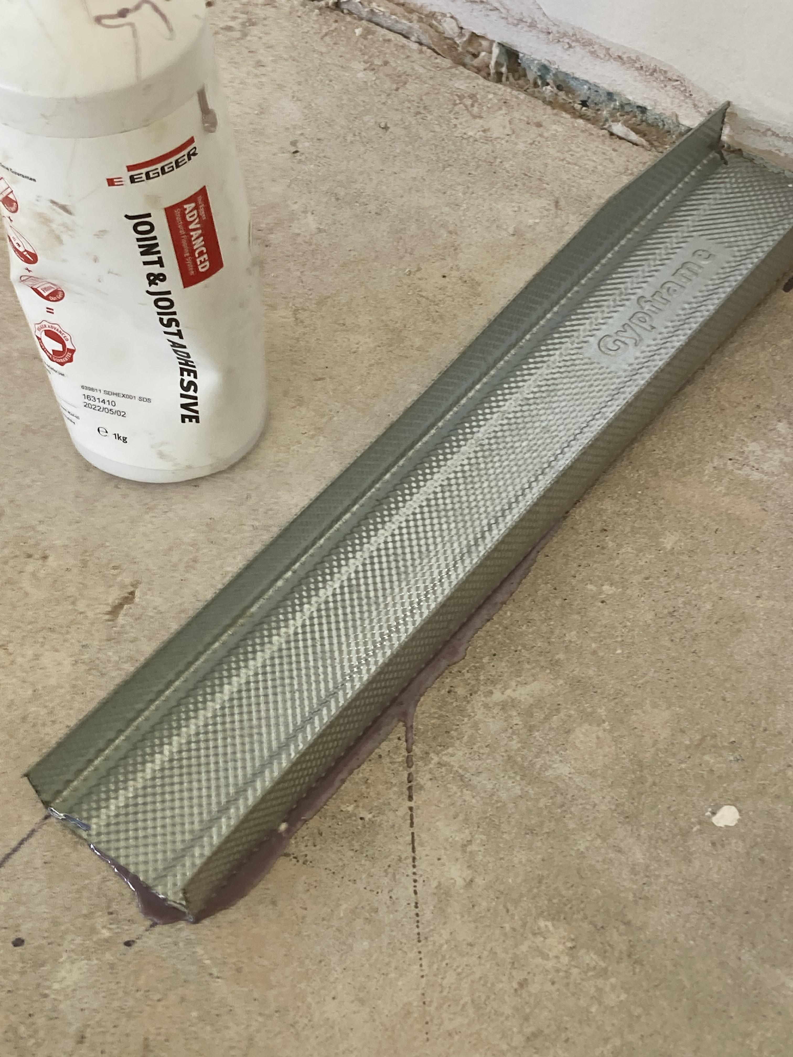

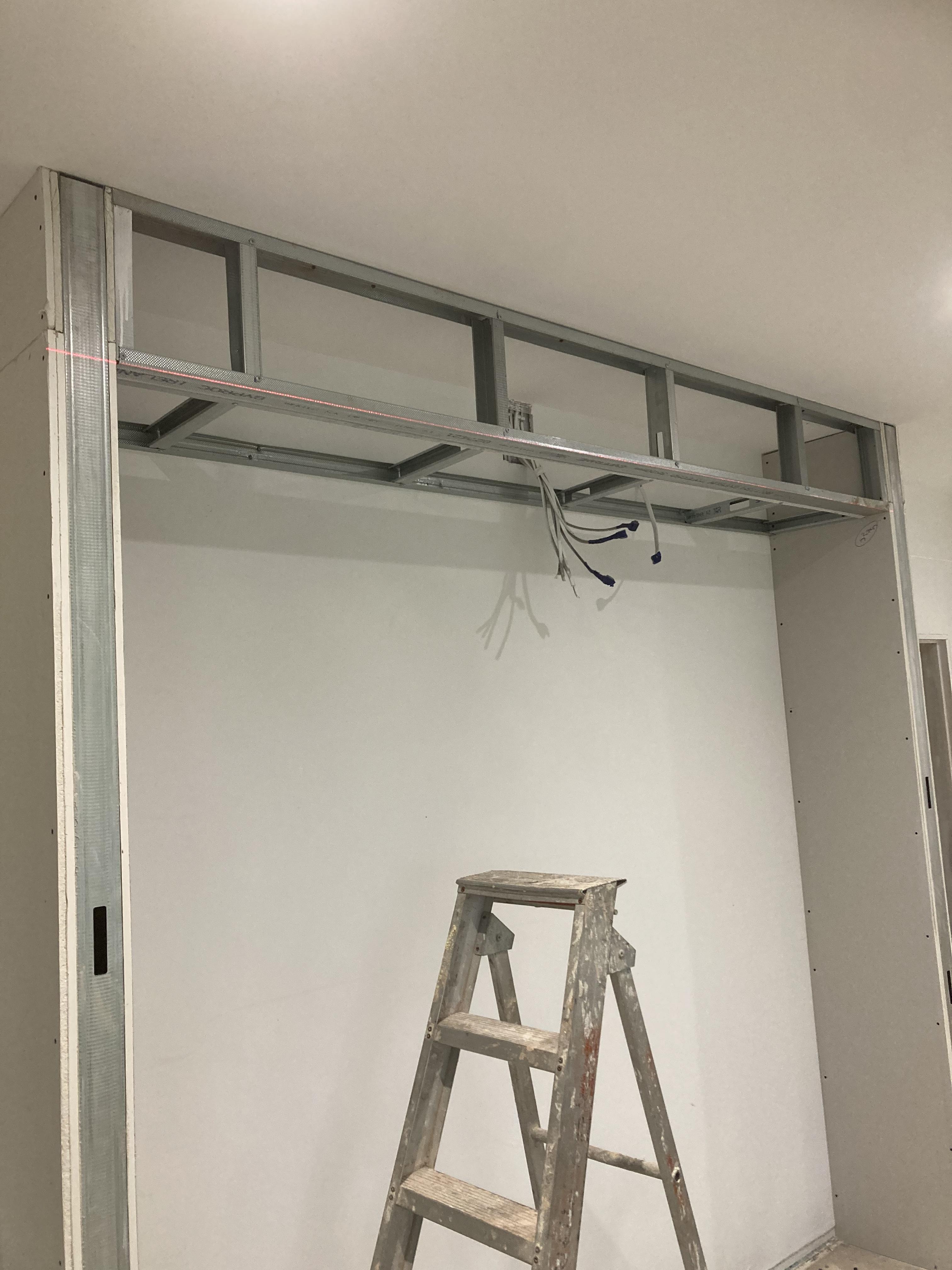

nod Posted April 19, 2024 Posted April 19, 2024 A question that is ask on a regular basis Fixing track or studs to a floor without drilling I found this stuff to be cheap and the most effective way to fix I put these two bits of track down at 4 and built the stud up a 6 1
Russell griffiths Posted April 19, 2024 Posted April 19, 2024 Tips don’t get it on your hands. sooper dooper tip. if you get it on your hands, don’t put your gloves back on. 😉 1
JohnMo Posted April 19, 2024 Posted April 19, 2024 Nice cupboard. I just avoided UFH pipes under walls, units, planned cupboards, and beds. Then you or someone else can drill holes without any worry. 1
nod Posted April 19, 2024 Author Posted April 19, 2024 1 hour ago, Russell griffiths said: Tips don’t get it on your hands. sooper dooper tip. if you get it on your hands, don’t put your gloves back on. 😉 Your not kidding
nod Posted April 19, 2024 Author Posted April 19, 2024 15 minutes ago, JohnMo said: Nice cupboard. I just avoided UFH pipes under walls, units, planned cupboards, and beds. Then you or someone else can drill holes without any worry. Thanks I’m trying to get this kitchen over the line I built it last night to house the tall units Before my wife changes her mind AGAIN 😁
