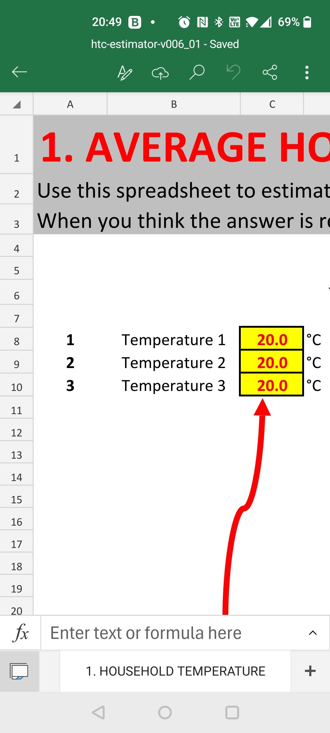

MrPotts Posted April 20, 2024 Share Posted April 20, 2024 4 hours ago, JohnMo said: Think your main reference accepted the rule of thumb wasn't that good and produced a spreadsheet. https://protonsforbreakfast.wordpress.com/2023/04/02/another-heat-pump-spreadsheet-beyond-the-rule-of-thumb/ I have had a look at the epreadsheet but it doesn't work for me. If I change the default temperatures I get the #ref error. Link to comment Share on other sites More sharing options...

JohnMo Posted April 20, 2024 Share Posted April 20, 2024 4 hours ago, MrPotts said: I have had a look at the epreadsheet but it doesn't work for me. If I change the default temperatures I get the #ref error. That's because you changed the temperature in the wrong cell, you change the temperatures in cells C8, C9, and C10 only. You change the yellow and with red text cells as it says in the intro tab. Link to comment Share on other sites More sharing options...

MrPotts Posted April 20, 2024 Share Posted April 20, 2024 (edited) 1 hour ago, JohnMo said: That's because you changed the temperature in the wrong cell, you change the temperatures in cells C8, C9, and C10 only. You change the yellow and with red text cells as it says in the intro tab. That is where I changed them. When I then selected which temperature for morning, afternoon etc that is when I got the #ref errors. I will have another go tomorrow. Edited April 20, 2024 by MrPotts Link to comment Share on other sites More sharing options...

JohnMo Posted April 20, 2024 Share Posted April 20, 2024 7 minutes ago, MrPotts said: That is where I changed them. When I then selected which temperature for morning, afternoon etc that is when I got the #ref errors. I will have another go tomorrow. Just leave it all 20, keep it simple, your either going to batch charge the house or run on Weather Compensation. So 20 is close enough or your average temperature. 1 Link to comment Share on other sites More sharing options...
