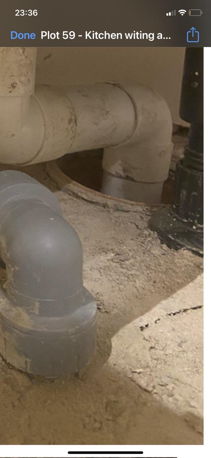

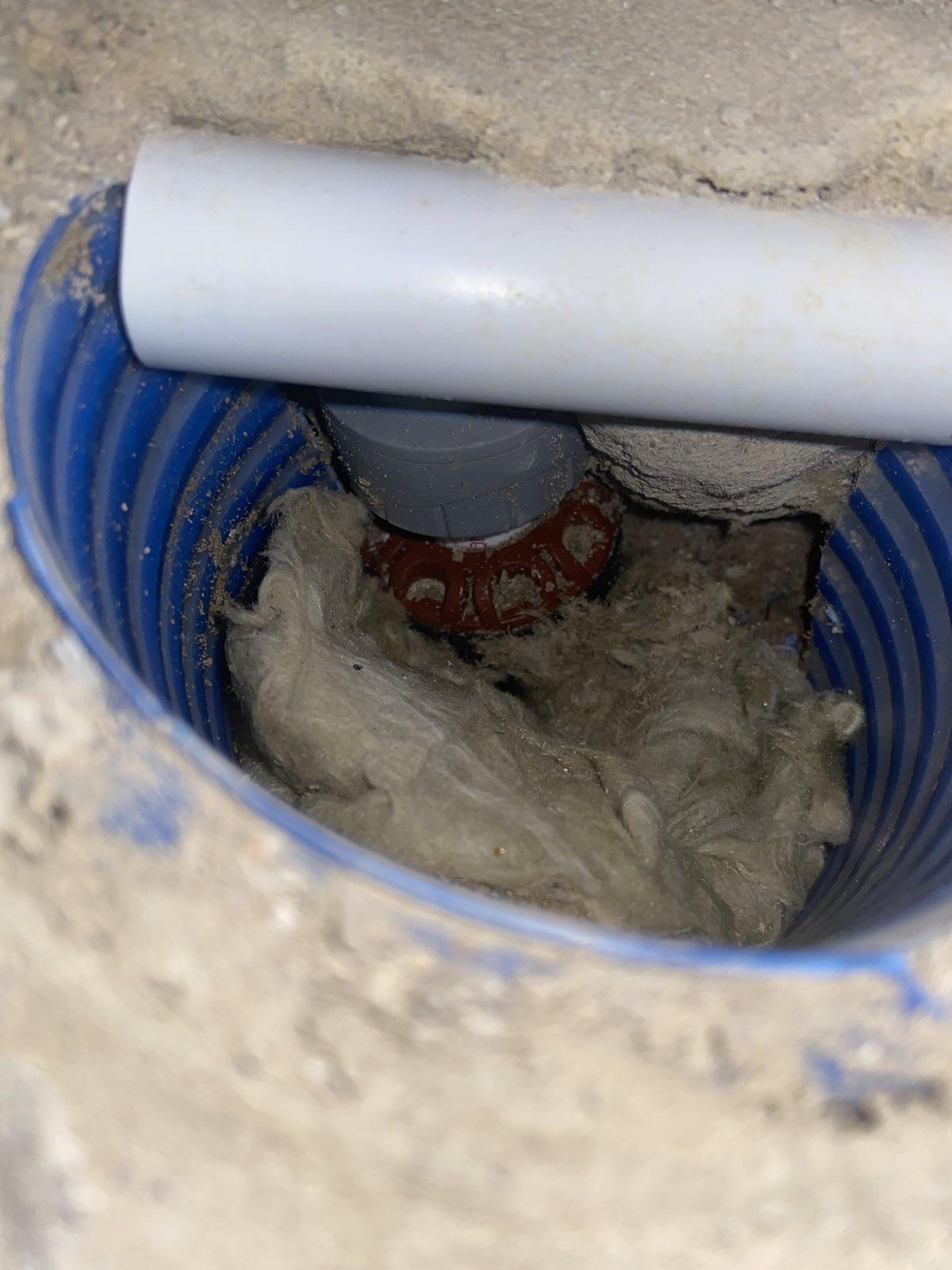

Firstly, the main supply pipe into the house isn’t in conduit or a sleeve. A good friend of mine who is a chartered building surveyor noticed this issue after the dishwasher needed an Engineer. (Photo of water pipe). The hole is under the dishwasher and the pipe has at least 6 connectors.

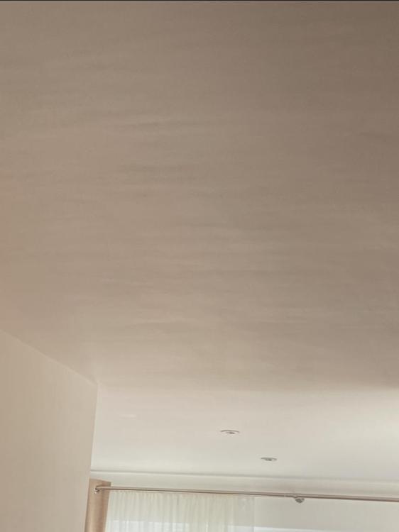

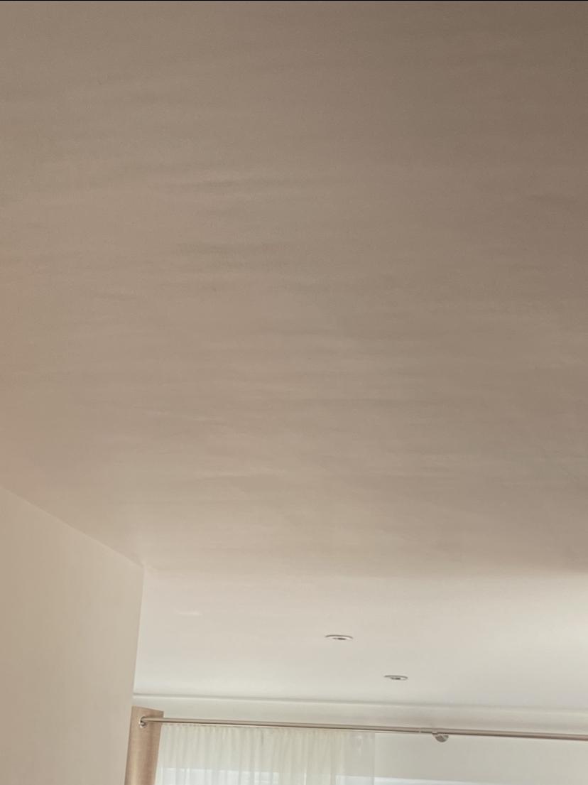

The photo of the plastering on the open plan kitchen ceiling is taken in natural daylight 2 meters distance.

The plastering isn't immaculate but without seeing it from different angles it's not too bad. The light oblique from the window is making it look it's worse. Open the curtains or take a picture from below and it'll look better.
If you hold a torch along any of our walls they will often appear with ripples. As much from my spray painting as anything else. And we had really good plasterers.
It's just a fact of any hand made product. Imperfections will be there.
I have no idea about your other pipe issue or what even is wrong sorry.
