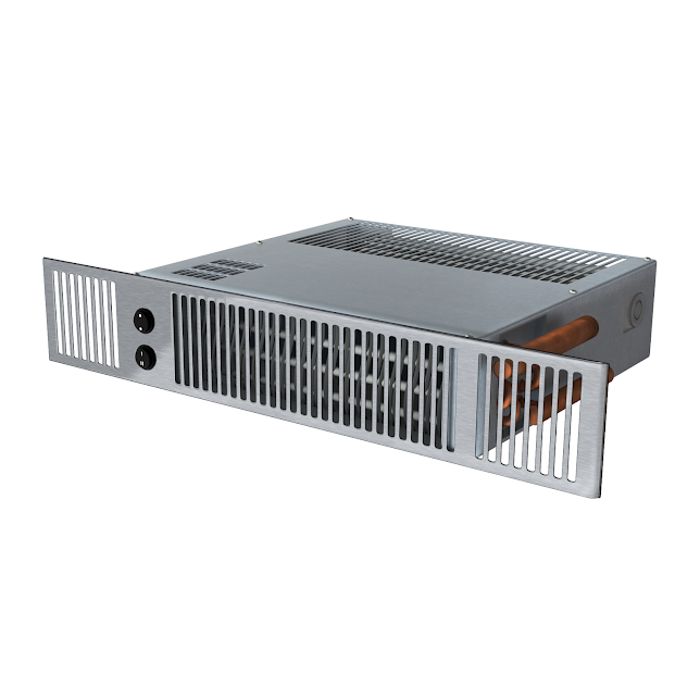

SteamyTea Posted April 18, 2024 Share Posted April 18, 2024 (edited) If you don't mind a bit of noise, how about plinth heaters. Edited April 18, 2024 by SteamyTea Link to comment Share on other sites More sharing options...

nwnw Posted April 19, 2024 Author Share Posted April 19, 2024 20 hours ago, SteamyTea said: If you don't mind a bit of noise, how about plinth heaters. Direct electric? I prefer the idea of a 4+ COP over the next 25 years. 🙂 Link to comment Share on other sites More sharing options...
SteamyTea Posted April 19, 2024 Share Posted April 19, 2024 (edited) 1 hour ago, nwnw said: Direct electric No, they are just fan assisted radiators that are small. You can just plumb them in to the existing system. https://www.plumbworld.co.uk/smiths-space-saver-ss55-hydronic-plinth-heater-with-brushed-steel-grille-1304-1261300 Edited April 19, 2024 by SteamyTea Link to comment Share on other sites More sharing options...
Super_Paulie Posted April 19, 2024 Share Posted April 19, 2024 For what it's worth I've got 2 plinth heaters, Smiths SS5. The heat they throw out is great, or at least the feeling of warmth is. I've got them as a backup incase the underfloor struggles in winter but they also can be set to just move air which is nice and cooling. Link to comment Share on other sites More sharing options...
SteamyTea Posted April 19, 2024 Share Posted April 19, 2024 29 minutes ago, Super_Paulie said: For what it's worth I've got 2 plinth heaters, Smiths SS5 Is the noise intrusive, they show a low level 27 dB I seem to remember. Link to comment Share on other sites More sharing options...
Super_Paulie Posted April 19, 2024 Share Posted April 19, 2024 Just now, SteamyTea said: Is the noise intrusive, they show a low level 27 dB I seem to remember. On setting 1 you have to be right next to them to know they are even on. I previously had a SS7, which I got based purely on the wattage they move but it was too noisy for me, I've got tinnitus so really sensitive to noises and I just couldn't get away with it. Basically brand new in the box, tested for 5 minutes and that was enough for me. Even that is not particularly loud but it would drive me insane if I could hear it, the SS5 are borderline silent. Link to comment Share on other sites More sharing options...

nwnw Posted April 20, 2024 Author Share Posted April 20, 2024 18 hours ago, SteamyTea said: No, they are just fan assisted radiators that are small. You can just plumb them in to the existing system. https://www.plumbworld.co.uk/smiths-space-saver-ss55-hydronic-plinth-heater-with-brushed-steel-grille-1304-1261300 Ah, ok sorry. Had a look at the SS5 and at 45degC ASHP temps it only puts out 0.6kW at the 'normal' setting (or 1.1kW at 70degC). The existing double convector in my living area is rated at 2kW. So I guess I would need at least 2. I assume the heat from them is better distributed, given that it is blown rather than convected?...what are people's experience of this? Or do they create a 'wind-chill' effect? Link to comment Share on other sites More sharing options...

Super_Paulie Posted April 20, 2024 Share Posted April 20, 2024 1 hour ago, nwnw said: Ah, ok sorry. Had a look at the SS5 and at 45degC ASHP temps it only puts out 0.6kW at the 'normal' setting (or 1.1kW at 70degC). The existing double convector in my living area is rated at 2kW. So I guess I would need at least 2. I assume the heat from them is better distributed, given that it is blown rather than convected?...what are people's experience of this? Or do they create a 'wind-chill' effect? Absolutely warm as toast. I'd imagine any pet you have would just permanently position themselves in front of it whenever it's on. Link to comment Share on other sites More sharing options...
