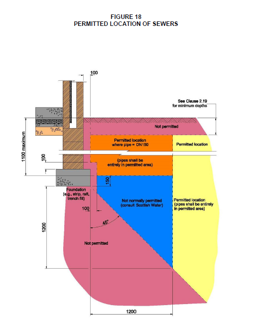

Gus Potter Posted April 18 Share Posted April 18 10 hours ago, mrmckenzie74 said: I'm one of those that lurk on the forum religiously but have nothing of value to add... so far. But you have now! Below is a screen shot from the Sewer for Scotland guide, same pretty much applies all over the UK. It's pretty clear that moving the sewer is not an option.. too expensive and where would you move it to? Also any type of deep foundation strip / trenchfill directly under the side extension could well compromise the existing house foundations due to it's depth.. you are getting into complex / costly Civil Engineering territory. The manhole up the side of the house is a big issue as you need to maintain access. However, this is worth a look at in principle. Say up the side of the house you put in two or three carefully bored piles near the boundary and then run beams / make a cradle from the gable of the house to the piles near the boundary. Your side extension then sits on part of steel cradle but avoids the manhole and doesn't extend over the line of the drain. At the rear, as you are piling anyway you just do the same maybe with a cantilever concrete ring beam. This could work and reduces the risk that if something goes wrong the water board come along and demolish your extension. It would only be two steel beams that span over their drain which you could dig under. I would draw this but have clocked off the day job. Sometimes it can work where you bridge over a sewer with a bit of structure (not a monhole) and negotiate access with the waterboard. In the round though.. unless you have a very high value property then it's unlikely going to fly cost / benefit wise, unless you work for / own a piling company.. I see this quite a lot where plans get draw by an Architect.. the SE does a design based on the plans.. but no one does a bit of due diligence to check the drains! The professionals should be much more alert to this early on. But often a Client doesn't want to pay for this fundamental early work. Some of the checks are really simple.. a site walk over, a walk round the surrounding area, topography of the ground and a service check. 10 hours ago, mrmckenzie74 said: What you'd do differently if you faced a similar situation again? Undertake due diligence! The sewer may even be mentioned in your title deeds. Your drawing needs a bit more detail as dimensions of what you propose vs what you have are critical. In other words a decent plan existing and proposed plan is required. Link to comment Share on other sites More sharing options...

George Posted April 19 Share Posted April 19 Agree piles and cantilever beams the most likely viable solution. Rafts wouldn't be suitable as although they wouldn't damage the sewer, the water company is more concerned about getting access to the sewer in future and they wouldn't want to undermine a raft. 1 Link to comment Share on other sites More sharing options...
