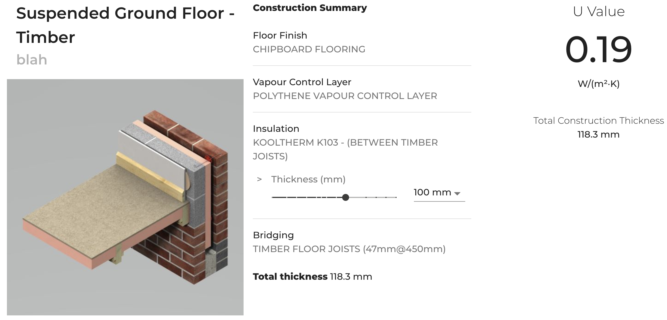

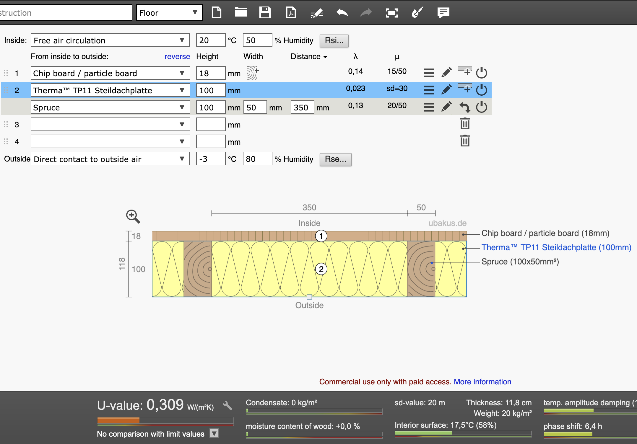

This is doing my head in. I've done a suspended floor build up accurately in Ubakus and get a U-value of over 0.3W m–2 K–1 which seemed high; then did the same in Kingspan's calculator and got 0.19W m–2 K–1 .
Is there some obvious error I've made? Trying to work out if I can comply with Part L for upgrading existing floors...

Your joists are on different centres, one at 350 the other at 450mm, so they wouldn't be the same.
Neither seem very good.

Is Ubakus German, or did I make that up?! If it is, I wonder if they do not use the IP/90-type Perimeter/Area convention, which gives a lower 'base case' U value than the old 'Uninsulated floors are 2' - IIRC then you'd expect a higher U value. But then I may be talking rubbish since, even if it's German, this appears to be the English version, so maybe it does use IP/90
Is Ubakus treating this as a suspended ground floor? Does not appear to be.

It is German, and I can't see what they're using for permiter/area, if anything. Kingspan by contrast required those two values before calculating the results.
They only have an option for "floor", not ground floor. I can choose the space at the bottom to have air or earth in it, but AFAICT restricting what's at the bottom to those two settings is the main change vs modelling as a "wall" or "roof".

It is, the options on the Kingspan calculator are very limited (only this material, only 450mm joist centres) so it's going to come out better than the other.
But - I was hoping to verify on 2 calculators that 100mm PIR plus flooring would at least get me to 0.25?
