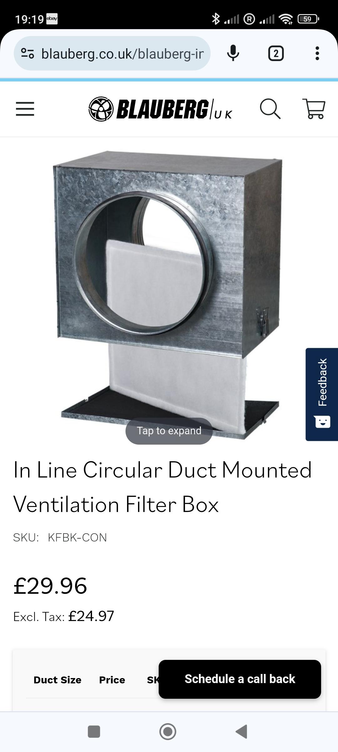

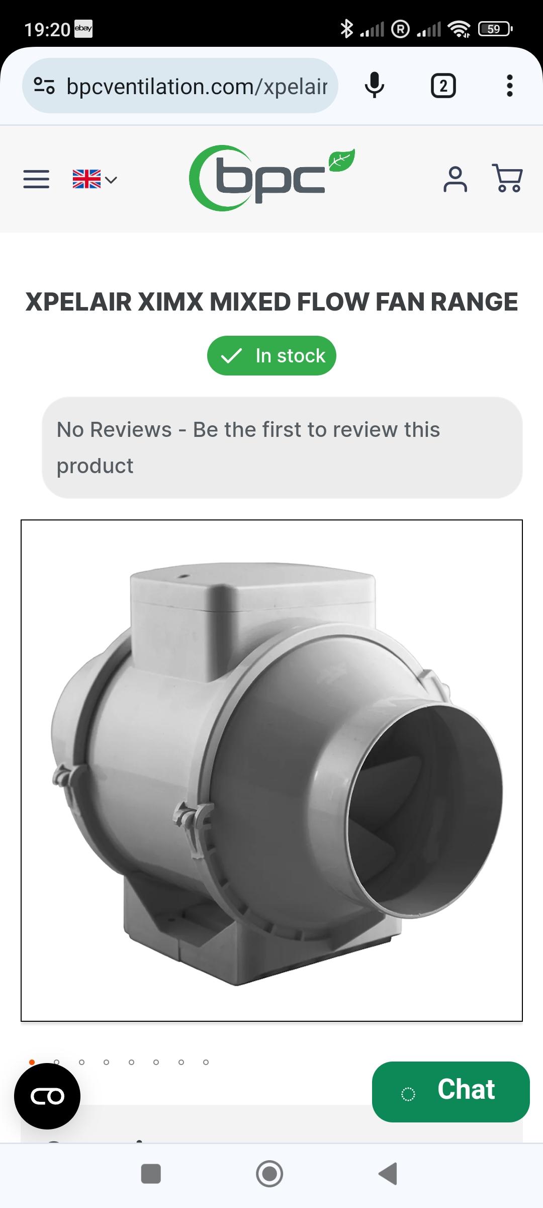

Iceverge Posted April 16 Share Posted April 16 PIV with some good filters would work. You can make your own pretty cheaply. You'll need a few bits of ducting too. Suck in front the garden and allow the air to be expelled via the bedroom vents. No heat recovery but at least you'll have filtered fresh air. Link to comment Share on other sites More sharing options...
