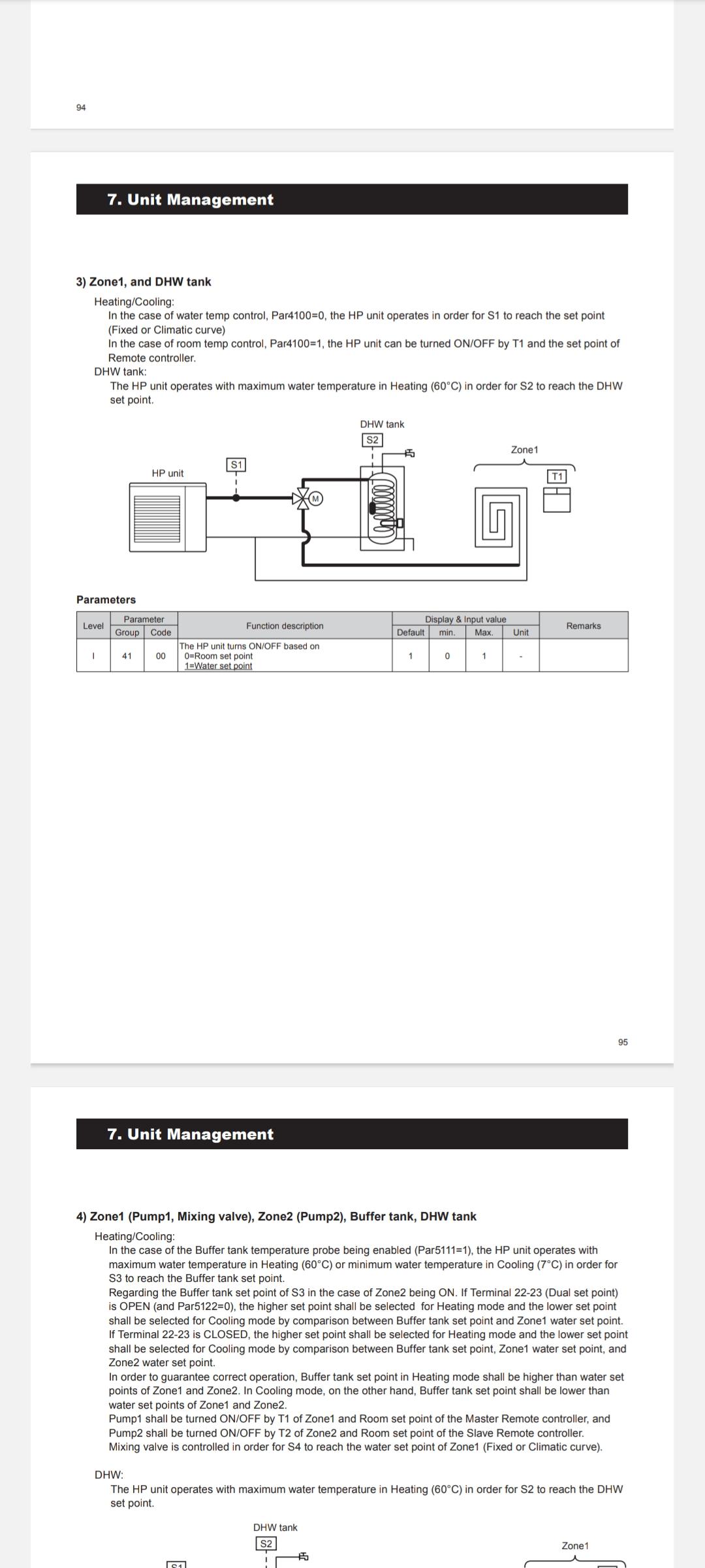

JohnMo Posted April 10 Share Posted April 10 There really is nothing to the design of a heat pump plumbing. Single zone (if you want zones you need a buffer). You need around 40 to 50L of water engaged at all times. Let's say a 6 kW heat pump. Flexible hose attached to heat pump, then 28mm pipe to a 3 way diverter valve (not a mid point). Normally open port to heating system, normally closed to cylinder heating coil. If UFH either direct to manifold (from diverter) or via a mixer and pump (general it needed. Common return pipe. Heat pump cylinder (3m2 coil). 2 Link to comment Share on other sites More sharing options...
JohnMo Posted April 10 Share Posted April 10 Here is an image from the Chofu manual Chofu-Operating-Installation-Manual.pdfby Link to comment Share on other sites More sharing options...
JamesPa Posted April 11 Share Posted April 11 I largely agree but there are a couple of matters to consider 1. Get the sizing right. The industry seems, from what we hear (and what I have experienced) tend towards gross oversizing to the detriment of performance for the majority of the season. 2. Decide on the design flow temperature and check the actual output of your candidate pumps at this and your design OAT. The actual output can be quite different (up or down) to the sticker capacity. Link to comment Share on other sites More sharing options...
