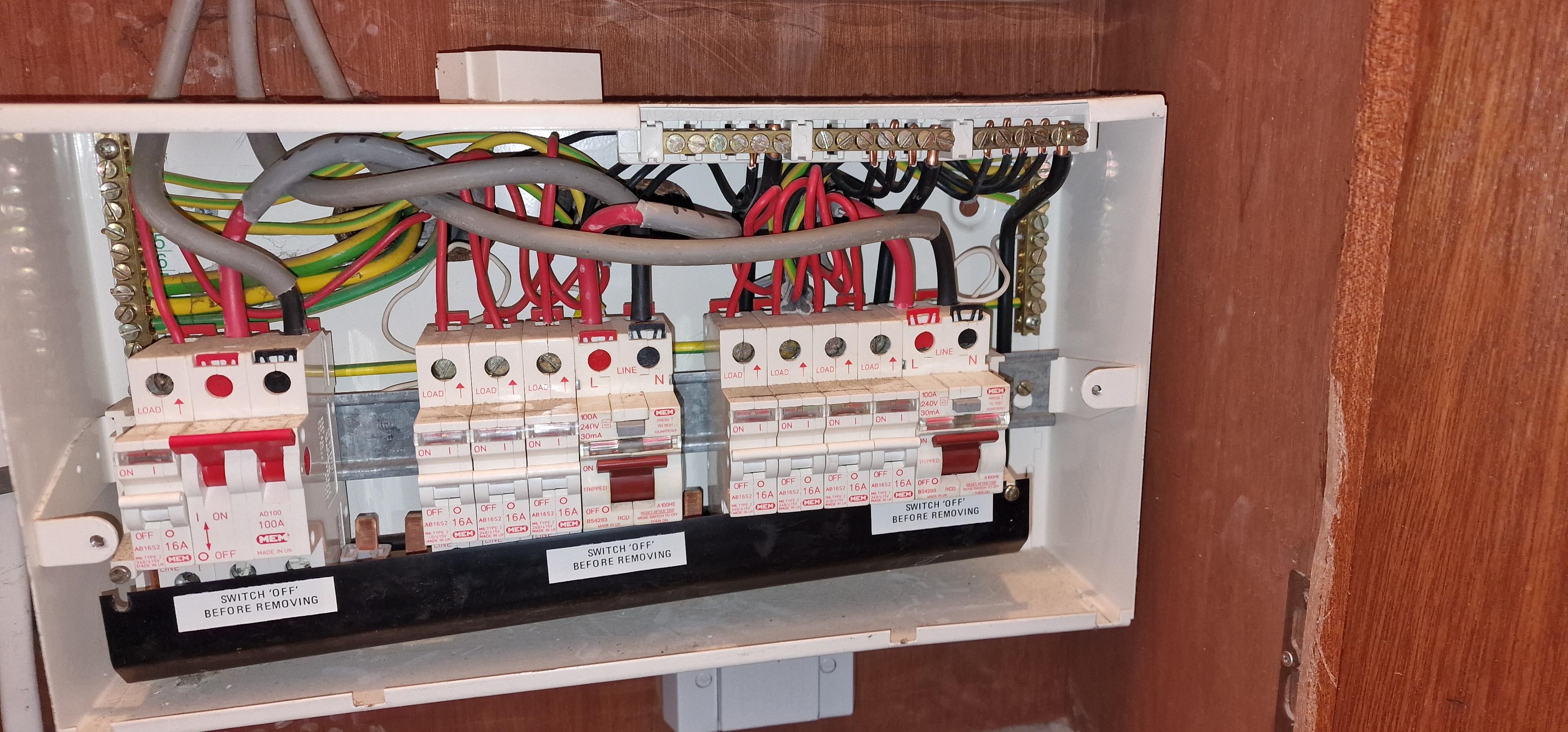

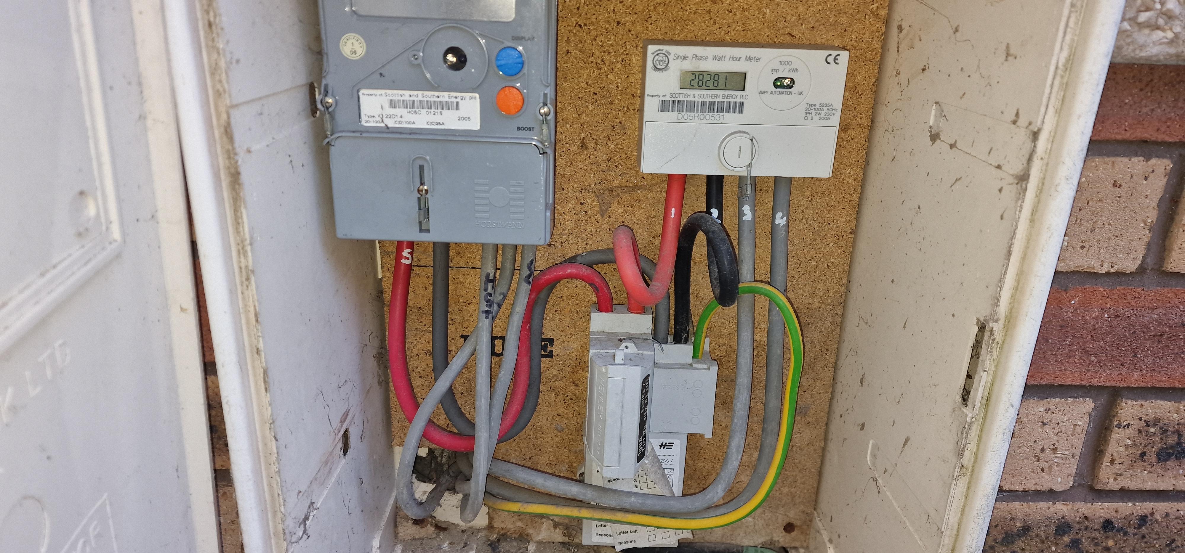

Ray Shields Posted April 7 Share Posted April 7 My flat has an old SSE THTC setup. Basically one meter (on the right) feeds the top CU (both are metal) which covers all the sockets, lights etc. The Radio Teleswitch on the left supplies permenant power to the water heater and 4 convectors. There is also a permenant supply to a Heater Boost button for heating up hot water quicker. The Teleswitch also tops up at various times 3 storage heaters. So, 4 different live feeds. I recently had an EICR done, it has been given a C2 (521.5.1) because there is one neutral which goes through from the meter box onto a Henley block and then 4 feeds into the CU in the top. Thus live and neutrals not going through the same holes, classed as a C2 as the lives come in through the rear of the CUs. To sort this I suspect the Henley block will have to go back to the meter box and the 4 neutrals then follow the live cables in through the rear of the CU. Not sure there's enough hole space to allow this. My question, though, is that this is an original installation from about 25 years ago, it must have passed its initial installation certification. The last EICR I had done was in 2017, and it did not fail on this, not even a comment. When did this requirement first appear, could it be that this was legal at the time but not now (if so this is a C3, not to current spec). Could the electrician feed one neutral into the lower CU and daisy chain it across the 3 MCB/RCD? If so it would mean only one new additional neutral fed from meter box rather than 3. Link to comment Share on other sites More sharing options...

Ray Shields Posted April 8 Author Share Posted April 8 Sorry, I attached photos or so I thought. Meter cupboard in outside of building Link to comment Share on other sites More sharing options...

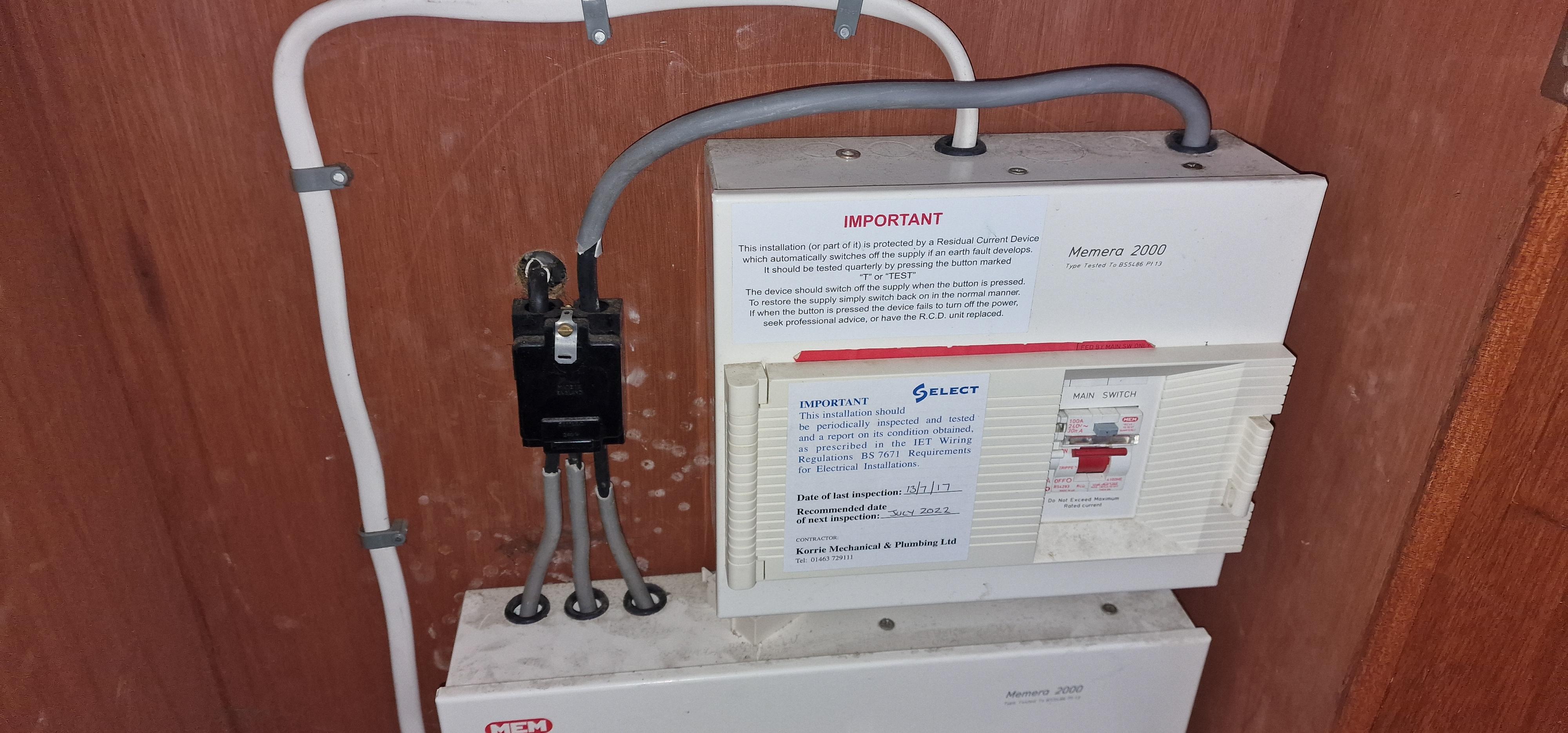

Ray Shields Posted April 8 Author Share Posted April 8 2 consumer units in side, note the neutrals going in top, the lives go in the rear. Top CU is for normal rate bottom one for all heating and timed supplies Link to comment Share on other sites More sharing options...

Ray Shields Posted April 8 Author Share Posted April 8 On 07/04/2024 at 19:13, ProDave said: Picture please. I am struggling to understand why one through the side and one the rear matters. Is it a case of the hole the cables go through is too big and not the correct IP rating? Pics posted, sorry thought I had. There is just one neutral coming through, distributed via Henley block, suppose they couldn't fit 4 live and 4 neutral meter tails (so just put through 4 live and 1 neutral.) through the brick wall hole from the meter box to inside CU. Lives come in the rear. Link to comment Share on other sites More sharing options...
Ray Shields Posted April 8 Author Share Posted April 8 The inspector quoted 521.5.1 that states for a metal box live and neutral must pass through the same hole to stop eddy currents causing heat. So basically he says each neutral must come through each corresponding live hole in the rear. Link to comment Share on other sites More sharing options...

Mattg4321 Posted April 9 Share Posted April 9 He’s correct in that it’s against the regulations. However in practice it’s unlikely to cause a problem at a domestic level with relatively low currents. You’ve also got issues there with basic insulation of the meter tails being visible and cable thus not mechanically protected. The meter tails are not properly supported and also quite likely IP rating to top surface of consumer unit not to IP4X. Nothing major, and all could be argued C2 or C3 depending on exact circumstances. It might just be worth getting someone to tidy them up - doesn’t have to be original inspector, you just append the invoice\certificate for the work to the original EICR to show the remedials have been carried out. Link to comment Share on other sites More sharing options...
ProDave Posted April 9 Share Posted April 9 The fix to that, is power down, remove the tails, put a hacksaw cut between each of the holes, replace and re connect cables. But if there is no actual evidence of heating, and it has been like that for probably 30 or more years, I would challenge the tester to justify a C2 rather than a C3 Why did you have the EICR? If it is just for information, you are not obliged to have it fixed. Only if it is something like a rental do you have to have a satisfactory EICR/ Link to comment Share on other sites More sharing options...
Ray Shields Posted April 10 Author Share Posted April 10 On 09/04/2024 at 09:00, ProDave said: The fix to that, is power down, remove the tails, put a hacksaw cut between each of the holes, replace and re connect cables. But if there is no actual evidence of heating, and it has been like that for probably 30 or more years, I would challenge the tester to justify a C2 rather than a C3 Why did you have the EICR? If it is just for information, you are not obliged to have it fixed. Only if it is something like a rental do you have to have a satisfactory EICR/ Yes it's a rental so can't have any C2. I had 6 C2s, I agree with them all apart from the neutral one which I feel is a C3. Does the hacksaw slot work when they are all neutrals? I thought it was if one was live, one was neutral. Thanks. Link to comment Share on other sites More sharing options...
ProDave Posted April 11 Share Posted April 11 You want a hacksaw cut between L and N Can you not get the rogue cable that enters in the back re routed to enter the top like the rest, thena hacksaw cut between all the holes will solve the problem. Link to comment Share on other sites More sharing options...
