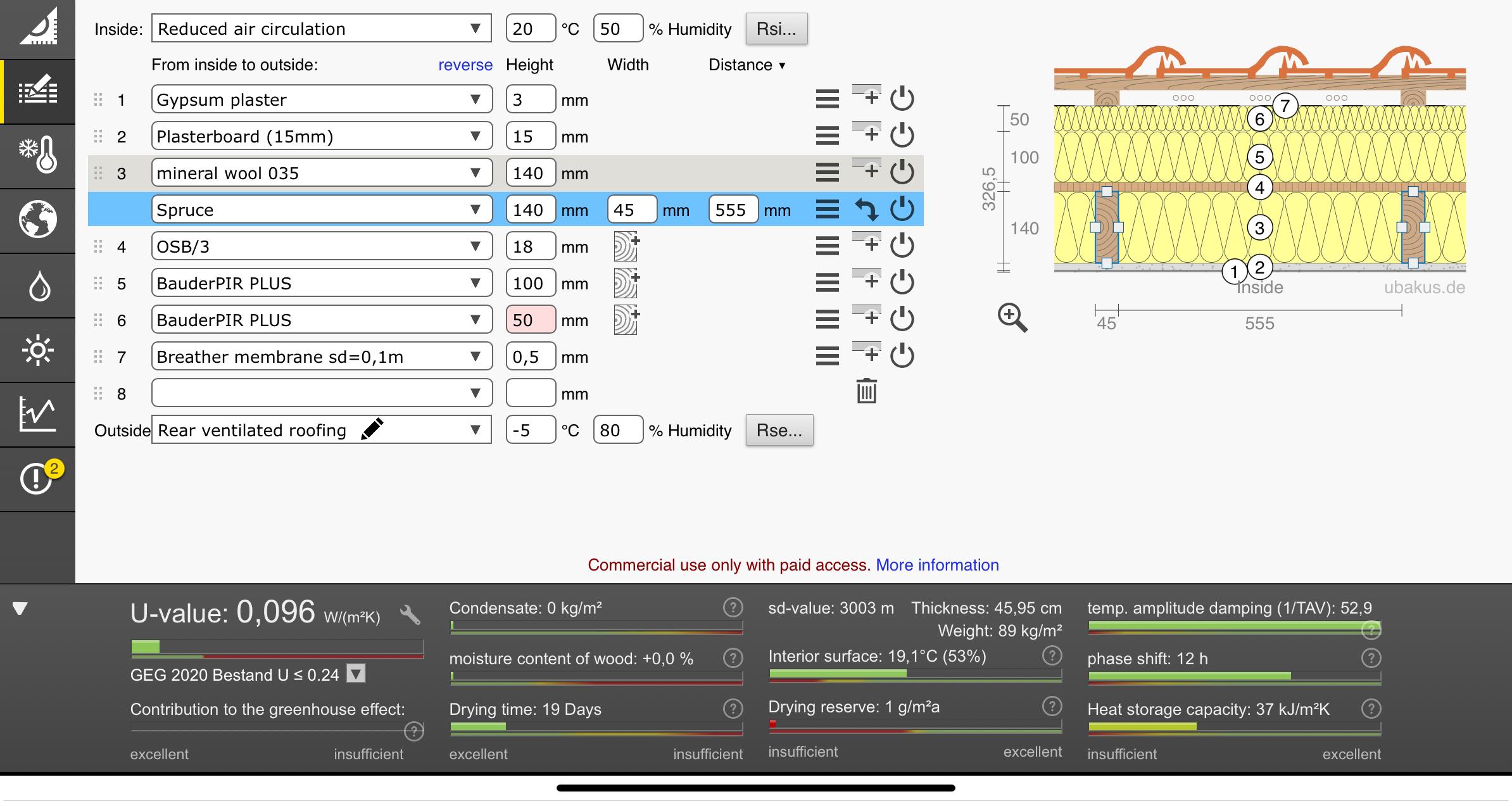

flanagaj Posted March 29 Author Share Posted March 29 So this looks like the best solution as it means you can install a door into the void for storage and also means the complete envelope of the structure is insulated, where as the image at the bottom does not look that efficient and also means you lose the valuable storage space if you wanted to utilise it. Link to comment Share on other sites More sharing options...

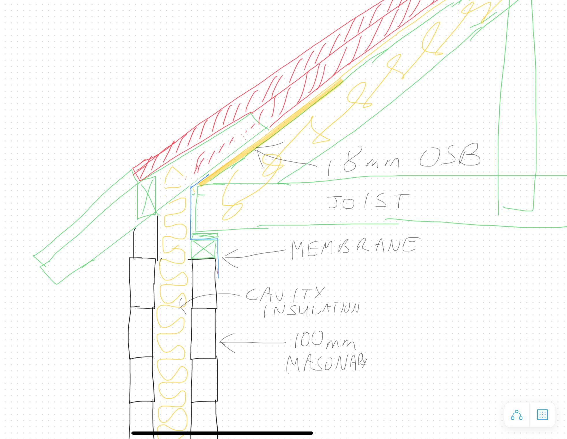

Iceverge Posted March 29 Share Posted March 29 (edited) Ok I see where you're at. Not a simple junction re airtighness to do as drawn. My preferred way for this would be to take the airtighness layer up the inside of the wall, across the top of the wall to the outside plate and up the top of the rafters. Then insulate between and above the rafters. You'll need to screw on rafter tails on top of the rafters. This way you've no timbers breaching the airtighness layer which makes it far far easier to construct. I'll do a sketch in the next hour or two if I get a chance. Edited March 29 by Iceverge 1 Link to comment Share on other sites More sharing options...

Iceverge Posted March 29 Share Posted March 29 Heres a rough sketch, 1. Fix your 100*75 wall plate as normal. 2. Put blue membrane in place as shown. Something like a good woven external breather membrane would do best. VP400 maybe. 3. Add a 100*25 board on too to protect the membrane. 4. Roof as shown with no rafter tails. 5. Screw 18mm osb on top of the rafters as you aritight layer, tape all joints and tape the wall palte membrane to it to complete you AT layer. 6.Add 100mm rafter tails as shown and insulate in between them with 100 mm rigid insulation. EPS or PIR. 7. Add a second layer of 50mm rigid insulation to reach over the tails and cover the top of the cavity. 8. Add 50mm timber to the top of the rafter tails to make level with the insulation. 9. roofing membrane. 10. counterbattens 11. tile battens 12. tiles 13. Below the OSB add 150mm flexible insulation. 14. Allow the cavity wall insulation to join up to the underside of the 50mm top layer of insulation too. Link to comment Share on other sites More sharing options...
