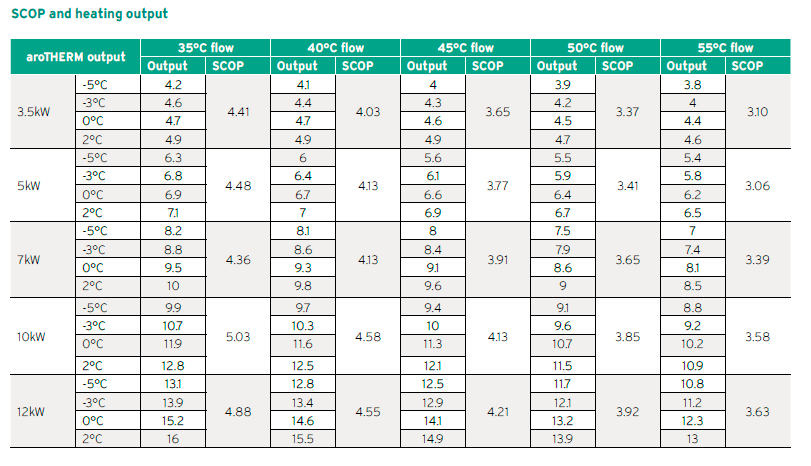

sharpener Posted March 29, 2024 Share Posted March 29, 2024 3 hours ago, jimboflint19 said: I know that I used 18500kw/h of gas heating the house in 2023, so considering they suggested an 8kw heat pump, is there anyway of making a rough calculation on how much electricity it would use over a year? 3 hours ago, Gary68 said: For a rough estimates divide by 2900 so yours would be 6.3kw so your looking for a 7 or 8kw heat pump Depends quite a lot on your emitter setup. If you have (or fit) rads suitable for a 45C flow temp then from this table a 5kw Arotherm plus would do the job down to -2 OAT (southern England). Further north you would defo need the 7kW unit. With a SCoP of 3.77 your 18500 kWh would require 4907 kWh of electricity to generate, which is what you originally asked, multiplied as @SteamyTea says by maybe 70% to account for the (in)efficiency of the boiler. Depending on yr HW usage (which I assume is included in the 18500) you may also need to make a correction for the fact that producing HW will be at a lower CoP, I do not know if this is included in the SCoP formula. The 7kW unit has a higher SCoP so would use less, the downside would be more cycling in warmer weather, unlike a gas boiler they only modulate down to about 50% rated output, then they cycle. Link to comment Share on other sites More sharing options...
John Carroll Posted March 29, 2024 Share Posted March 29, 2024 aroTHerm seem to have a strange way of sizing their units, I generally see them specked to the standard 7C/35C, air/water, the output then falls at lower air temps or/and higher water temps. I wonder what standard, air/water, are they using?. Link to comment Share on other sites More sharing options...

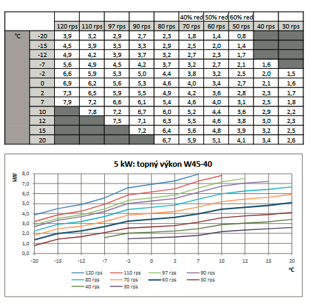

sharpener Posted March 29, 2024 Share Posted March 29, 2024 (edited) Yes, rated more generously than many other mfrs. Hence I have been quoted for a 12kW Vaillant unit in place of a 15kW Stiebel Eltron. Full performance tables (in Czech) are here starting at p34. Extract for 5kW unit at 40 - 45C flow temp (modulation is better than I thought): Edited March 29, 2024 by sharpener Link to comment Share on other sites More sharing options...
