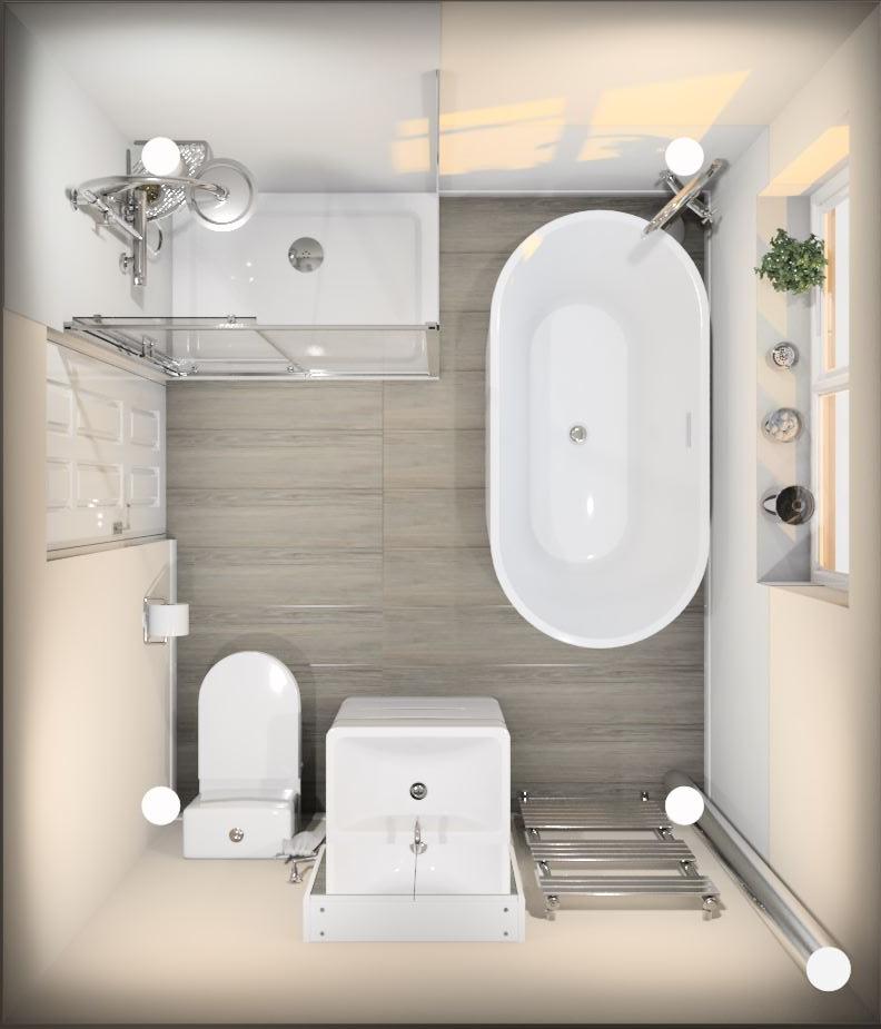

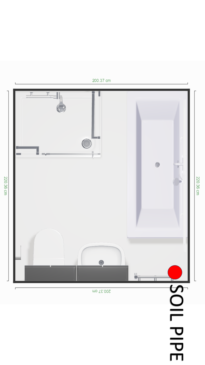

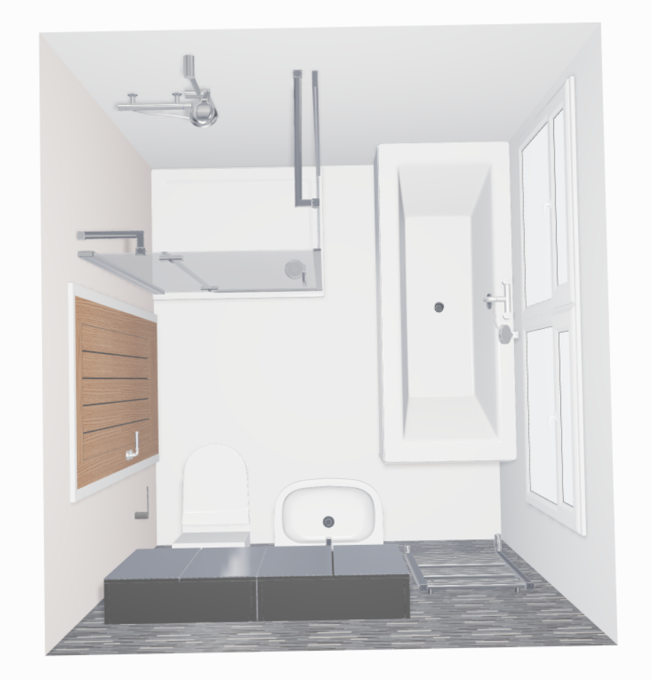

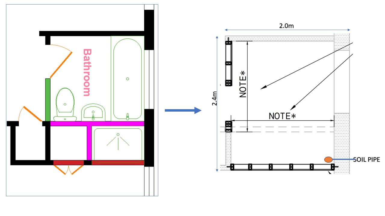

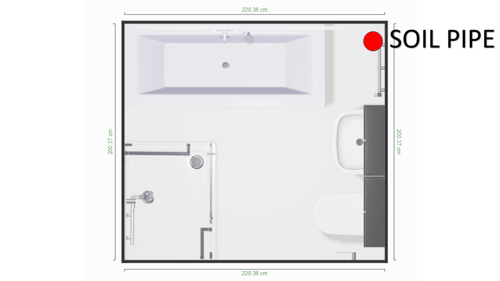

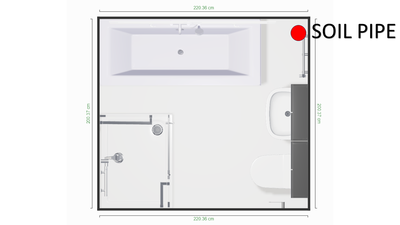

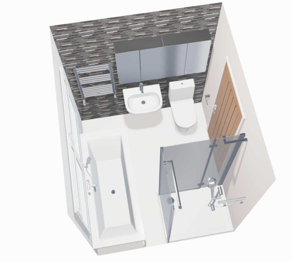

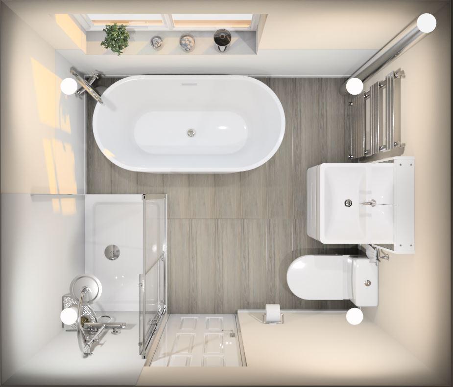

Richini Posted March 25, 2024 Share Posted March 25, 2024 Good morning, I'm really looking for comments or suggestions for our bathroom renovation. The plan as it currently sits, is to take a wall down a move the door to create a larger space. Our requirements are to have a separate shower & bath. Young children so wet room isn't really practical, and to have everything as accessible for repairs / maintenance as possible. Can anyone suggest any layout alternatives please? Should the door open against the toilet or shower? Taken note of the Mcalpine traps for the shower and bath, are there any other top suggestions for things to incorporate into a new bathroom? Thanks. Link to comment Share on other sites More sharing options...
Mr Punter Posted March 25, 2024 Share Posted March 25, 2024 It would be helpful if the plans you have posted were all oriented the same way. Don't plan the bathroom just for your young children. You may soon be at a stage when several people want to use the loo, brush teeth, have a shower etc. at similar times. Morning rush hour before school / work can get congested. We once had a double sink and that worked well for face wash and teeth brush for 2 at once. You may find that a small ensuite or at least a separate loo would be handy. A shower bath can combine 2 functions and save space. Link to comment Share on other sites More sharing options...

Richini Posted March 25, 2024 Author Share Posted March 25, 2024 Mr Punter, point taken thanks. Pictures now to same orientation hopefully. - While I have seen a few good over bath options, I've never seen an over bath option that properly contains the water when having a shower. So my preference is to eek out room for a dedicated shower if possible. - We do have a separate WC elsewhere to hopefully help alleviate the morning rush. Link to comment Share on other sites More sharing options...
Richini Posted March 25, 2024 Author Share Posted March 25, 2024 RichardL, thanks for your comment. I guess my main concern with the over bath shower is water getting absolutely everywhere. My experience of over bath showers is typically that that water has one way or another ended up all over the bathroom floor. For my sanity I'd just rather know leak damage was being minimised as far as possible. 1 Link to comment Share on other sites More sharing options...

Richini Posted March 25, 2024 Author Share Posted March 25, 2024 ProDave, no issues with a wet room, infact I really like how you've done your bathroom. The rest of my household is unfortunately pretty care free when it comes to splashing water everywhere and can just see a wetroom leading to water making its way out the bathroom and into the adjoining hallway. Link to comment Share on other sites More sharing options...
