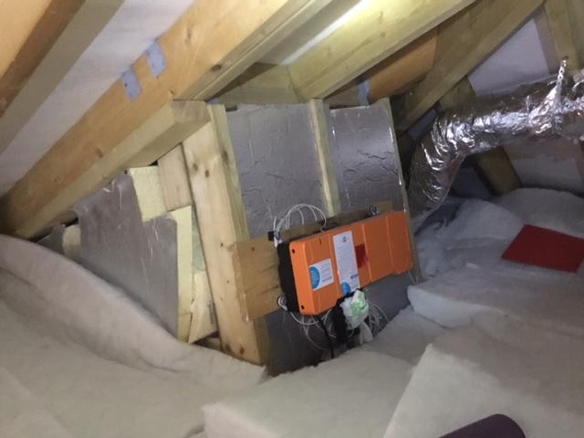

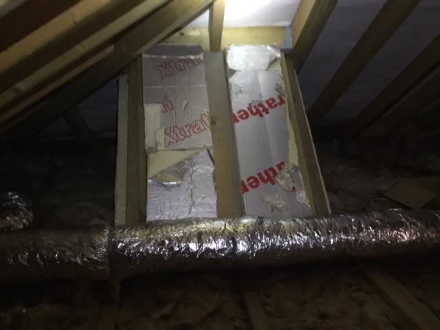

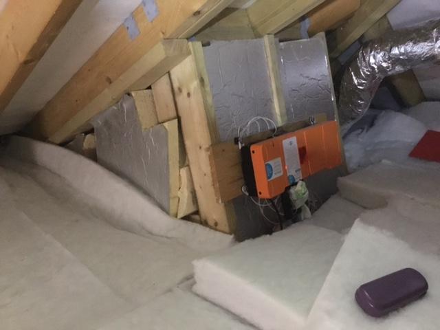

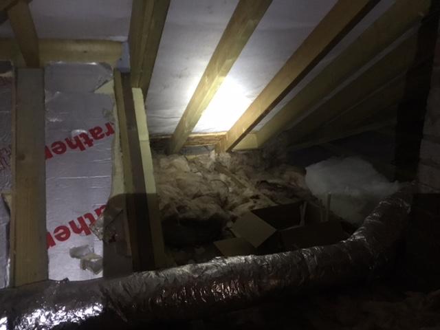

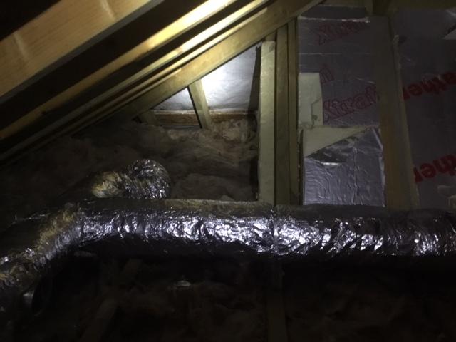

Novice Becky Posted March 20, 2024 Posted March 20, 2024 Any ideas how to insulate my Velux windows? The ceilings below are horizontal with vaulted shafts for the Velux. The bathroom Velux is especially bad. Ignore the orange box attached to bathroom Velux - it's a digital shower processor no longer there Cover what's there with more PIR sheets and tape joins? Would air gaps pose a problem for interstitial condensation? Rip off PIR and start again? Other materials? What thickness of insulation (I know this will depend on thermal conductivity). Thank you.
Iceverge Posted March 20, 2024 Posted March 20, 2024 1 minute ago, Novice Becky said: . The bathroom Velux is especially bad. In what way? Drafts, condensation mold?
Redbeard Posted March 20, 2024 Posted March 20, 2024 I take it there is plasterboard on the bathroom side of the 'tunnel'? Does it have a vapour control layer (VCL) on the cold side? If not, rip it out, install a really-well-taped VCL and re-plasterboard. Then build up from the cold side, filling any gaps with *air-tight* foam. Butt up tightly to any timbers, and at least one further layer over them. 150 - 200mm of PIR is not, in my view, too much. Keep all the joints tight, and tape them too, with decent air-tightness tape, not just foil tape. The existing does not seem to terminate very tightly at the top where it meets the rafters and the noggin. Make that bit better, and keep it all as tight as the btm of the proverbial duck.
nod Posted March 21, 2024 Posted March 21, 2024 I’ve similar setup in two places I used multi-foil to rap them Then taped the seams
Novice Becky Posted March 21, 2024 Author Posted March 21, 2024 16 hours ago, Iceverge said: In what way? Drafts, condensation mold? Thanks @Iceverge. Condensation and mould. This has been cured by the MVHR going in in December but it will still be a cold bridge (or cold mountain?)
Novice Becky Posted March 21, 2024 Author Posted March 21, 2024 Thanks @nod. Foil wrap sounds quick and straightforward but quite a lot less insulation than the 200mm of PIR suggestion. Thanks @ Redbeard. I didn't quite get the re-plasterboard after VCL. Can you explain please? If I Take off the PIR that's there then there will be the plasterboard exposed. Can I just tape the VCL to the existing plasterboard and timbers and then build up the insulation?
nod Posted March 21, 2024 Posted March 21, 2024 6 hours ago, Novice Becky said: Thanks @nod. Foil wrap sounds quick and straightforward but quite a lot less insulation than the 200mm of PIR suggestion. Thanks @ Redbeard. I didn't quite get the re-plasterboard after VCL. Can you explain please? If I Take off the PIR that's there then there will be the plasterboard exposed. Can I just tape the VCL to the existing plasterboard and timbers and then build up the insulation? No the 18 layer foil is equivalent to 90 mil of rigid pri and far easier to seal with tape in awkward spaces Use two layers 1
