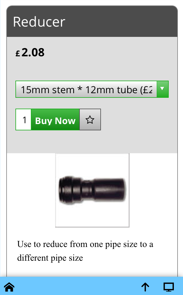

I'm just doing the final setup of my Airflow Androit MHRV unit and have discovered the condensation drain fittings requires "rust resistant 12mm OD pipework". BPC actually supplied some standard 21.5mm plastic drain fittings which are clearly not correct for the unit.
Before I call them today I thought I'd just ask if I'm missing anything obvious? My plan is to connect the drain outlets from the MVRV and the heat battery to a HEPvO waterless trap and into the stack.
I found this online: http://www.pipefittingsdirect.co.uk/contents/en-uk/d28.html which shows a nylon 12mm OD pipe suitable for compression and push fit. This with copper compression fittings?
So 12mm isn’t any type of copper I know of ...!
I’d use a 12/15mm nylon reducer and get it to 15mm and then use ordinary pipe fittings from there onwards
BES do a full range of 12mm copper pipe and fittings.
But, your solution is ideal! Ta!!
