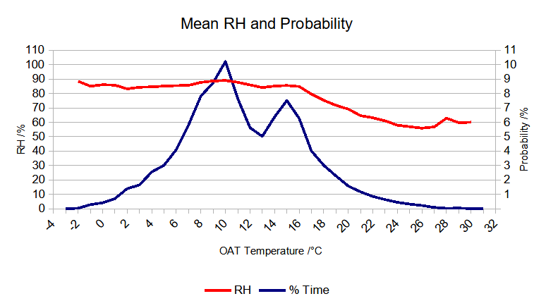

SteamyTea Posted March 14, 2024 Posted March 14, 2024 On 14/03/2024 at 07:54, Susie said: im not sure how future proof the calculations are though, especially for me quite near the coast with mist that can linger in the shoulder months, I can have 24hrs of mist/fog. Expand Mist is condensed water vapour, so needs to be treated differently. Needs to be treated as rain, not vapour. Below is the data near me for last year. At temperatures below 16°C the RH is pretty consistent at around 86%. That accounts for 79% of the time (don't tell emmets that it is really cold and damp in Cornwall). Say climate change raises the temperature by 1°C, from 12°C up to 13°C, the RH will reduce by 2%, to 84%, really nothing in reality.

Susie Posted March 14, 2024 Posted March 14, 2024 On 14/03/2024 at 08:28, SteamyTea said: Mist is condensed water vapour, so needs to be treated differently. Needs to be treated as rain, not vapour. Below is the data near me for last year. At temperatures below 16°C the RH is pretty consistent at around 86%. That accounts for 79% of the time (don't tell emmets that it is really cold and damp in Cornwall). Say climate change raises the temperature by 1°C, from 12°C up to 13°C, the RH will reduce by 2%, to 84%, really nothing in reality. Expand Thanks, So I better stop telling the other half its all in his head the feeling of being in constant high humidity because most of the time we probably are, I told him once that bit of the barometer was most likely broken as it didn't change much, he can't see the dial now without his glasses and the novelty has worn off.
SteamyTea Posted March 14, 2024 Posted March 14, 2024 On 14/03/2024 at 13:06, Susie said: I told him once that bit of the barometer was most likely broken as it didn't change much Expand Probably rusted because of lack of movement. 16°C and above only happens 21% of the time, and some of that is at night. And we had a really hot spell last year. 1
