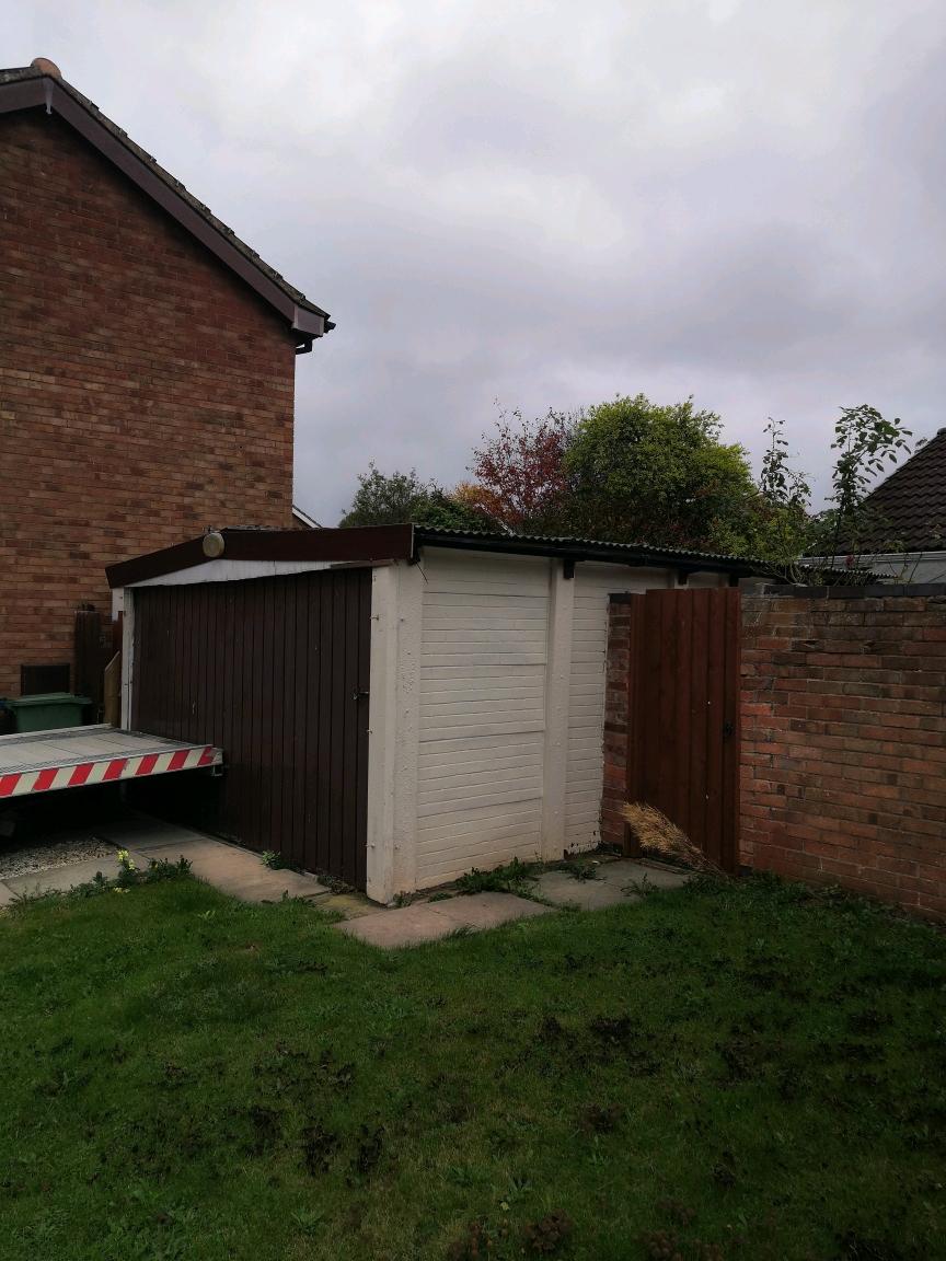

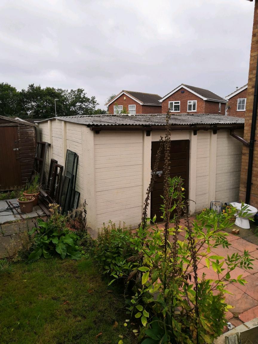

gaz_moose Posted March 10, 2024 Share Posted March 10, 2024 Currently I have this old asbestos roof sectional garage it is 4.6m wide and 6.2m long externally. I think whoever built it just used the froth on the top of their beer as a spirit level as the more you look the worse it gets. Basically it needs to disappear and be replaced by something much better, but im lost as to what to build to replace it, cost / value for money is a big decider as I will either have to build it myself or outsource it. I did look into those log lap cabins but think I would be in the same predicament when it starts rotting away. hiring a builder to build it out of brick sounds too expensive. Is a stick built replacement my best option? or is there something I've overlooked? Link to comment Share on other sites More sharing options...

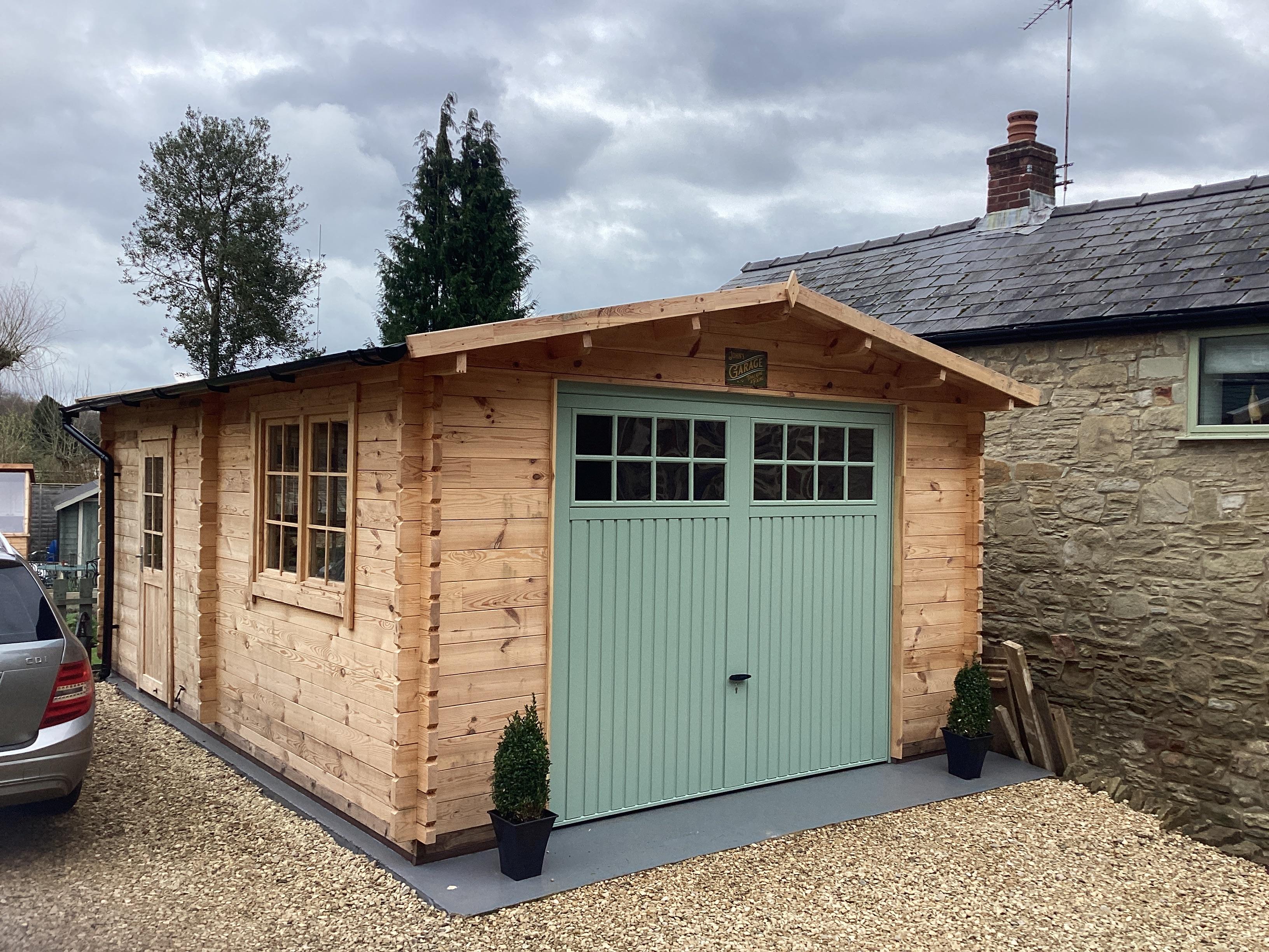

joe90 Posted March 10, 2024 Share Posted March 10, 2024 (edited) I recently built this, timber is 44mm thick and very good quality, it was cheaper than 19mm others on offer, came on one big pallet unloaded by forklift on the back of the lorry. Plus it looks nice and I get lots of comments from passers by. ( I didn’t want their timber garage doors and sourced my own and they deducted the cost of the doors). https://www.quick-garden.co.uk/single-wooden-garage-3-2m-x-5-2m-11x17-ft-44-mm.html?utm_source= Edited March 10, 2024 by joe90 Link to comment Share on other sites More sharing options...

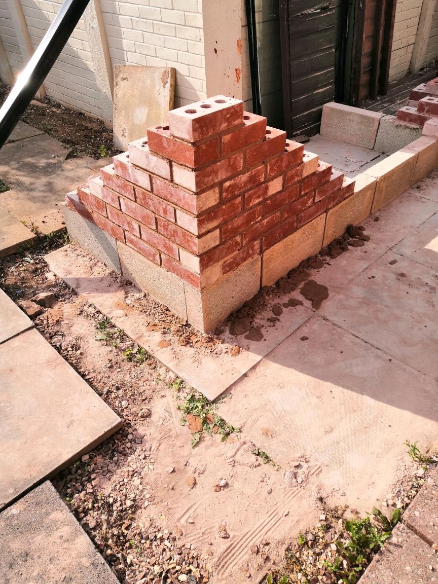

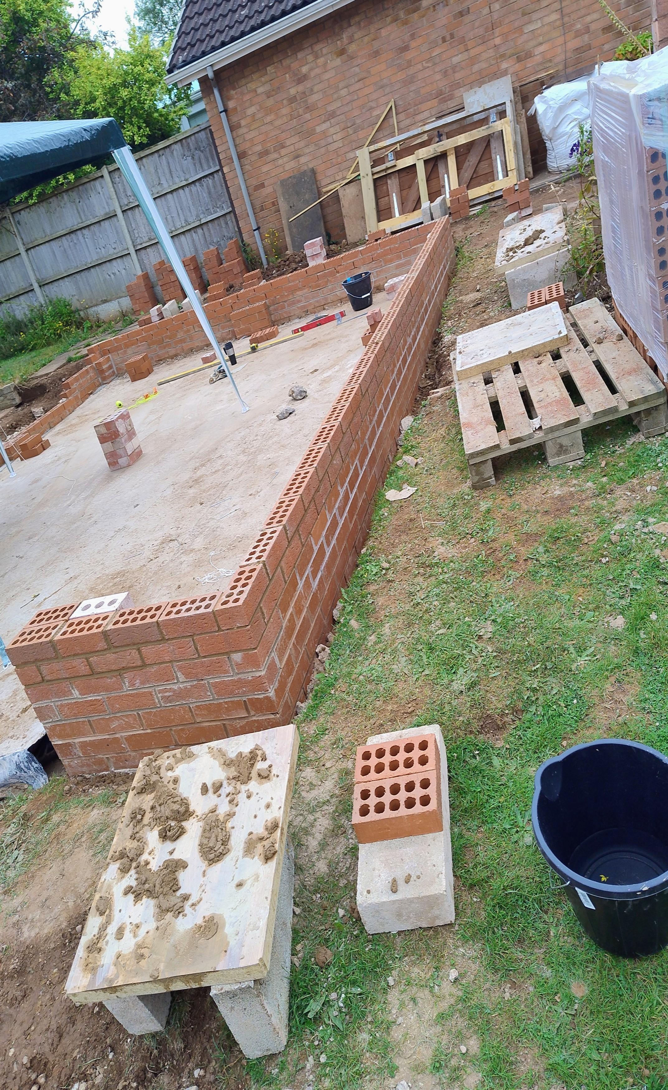

gaz_moose Posted July 14, 2024 Author Share Posted July 14, 2024 Well.. I knocked the old garage down and dug up the wonky slab. 2 grab trucks later a bit of concrete and this is where I am currently at. 1 Link to comment Share on other sites More sharing options...
gaz_moose Posted July 14, 2024 Author Share Posted July 14, 2024 the land is on a slope so the rear internal floor is lower than the external floor height. i built the back up higher in engineering bricks to compensate. i was planning on coating these brick in some bitumen tar type paint before i back filled it. is this my best option? i have just over a tonne of old gravel from my driveway ( round beach type stuff) that i was thinking of back filling with this on the higher parts to act as a kind of french drain. would this be a decent idea? Although its only a garage i do intend to keep stuff i like inside it so dont want it too be damp. Link to comment Share on other sites More sharing options...
saveasteading Posted July 14, 2024 Share Posted July 14, 2024 Thus is the third case of level problems this weekend. What membranes have you used sk far? Can you dig away the higher ground? Where could a drain go to, to empty? Link to comment Share on other sites More sharing options...
