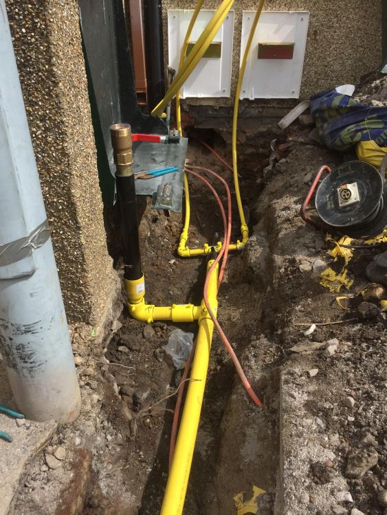

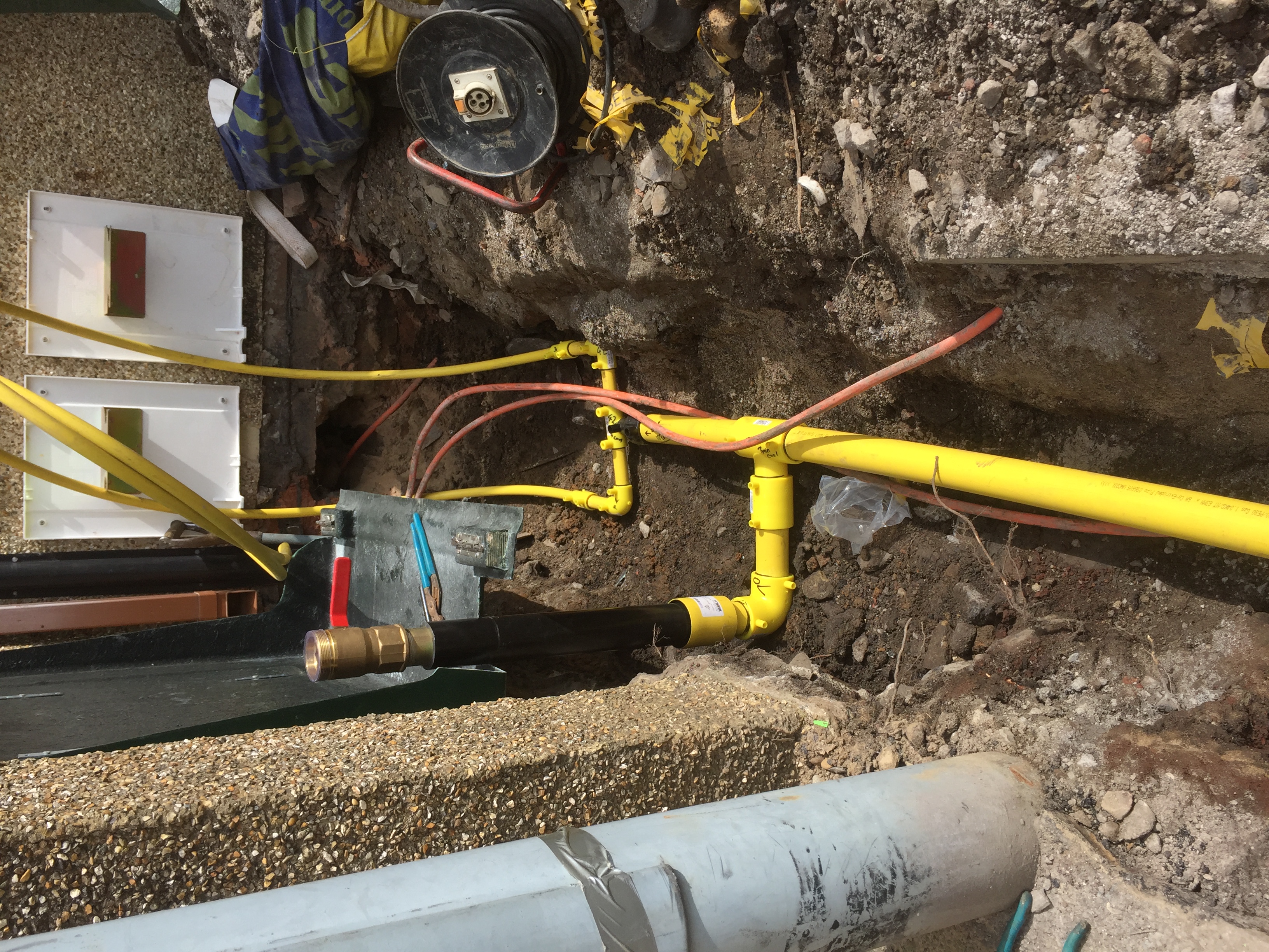

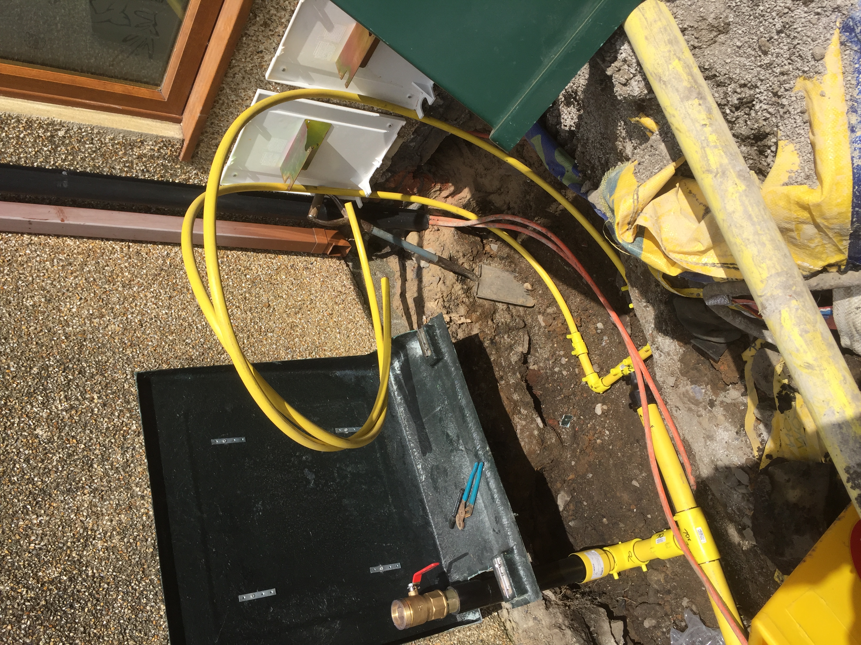

I have just had a chip shop, and two flats with 24kw combis connected by our local gas transporters WWU.
They came out and surveyed and the guy shook his head gently......."oh, that's a 2" galv pipe mate, were going to have to dig the road up as the main is in the opposite pavement".
Ok.?

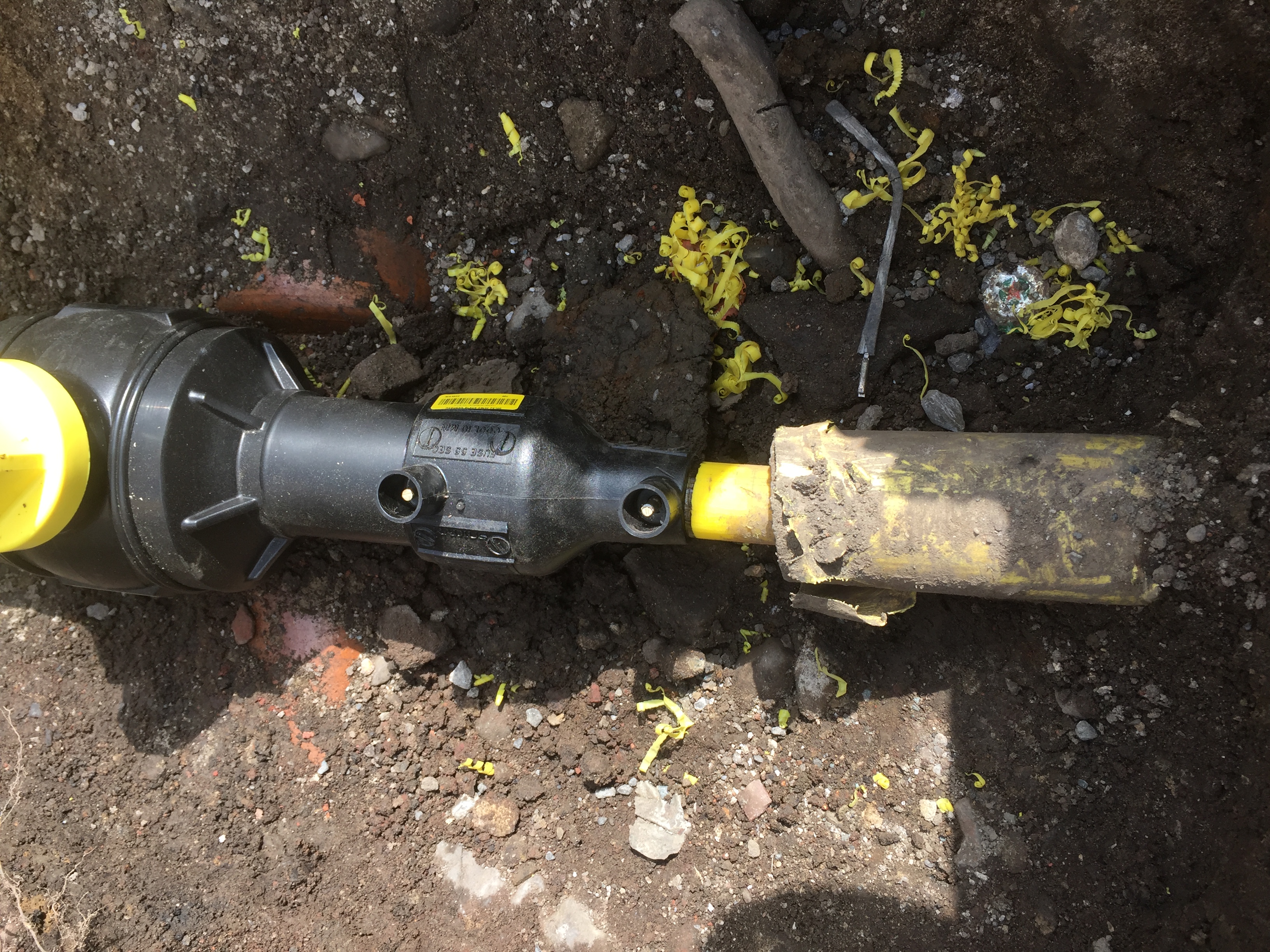

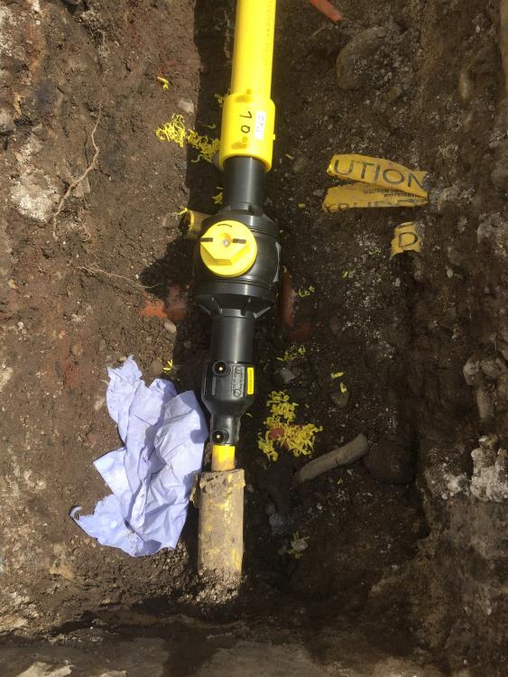

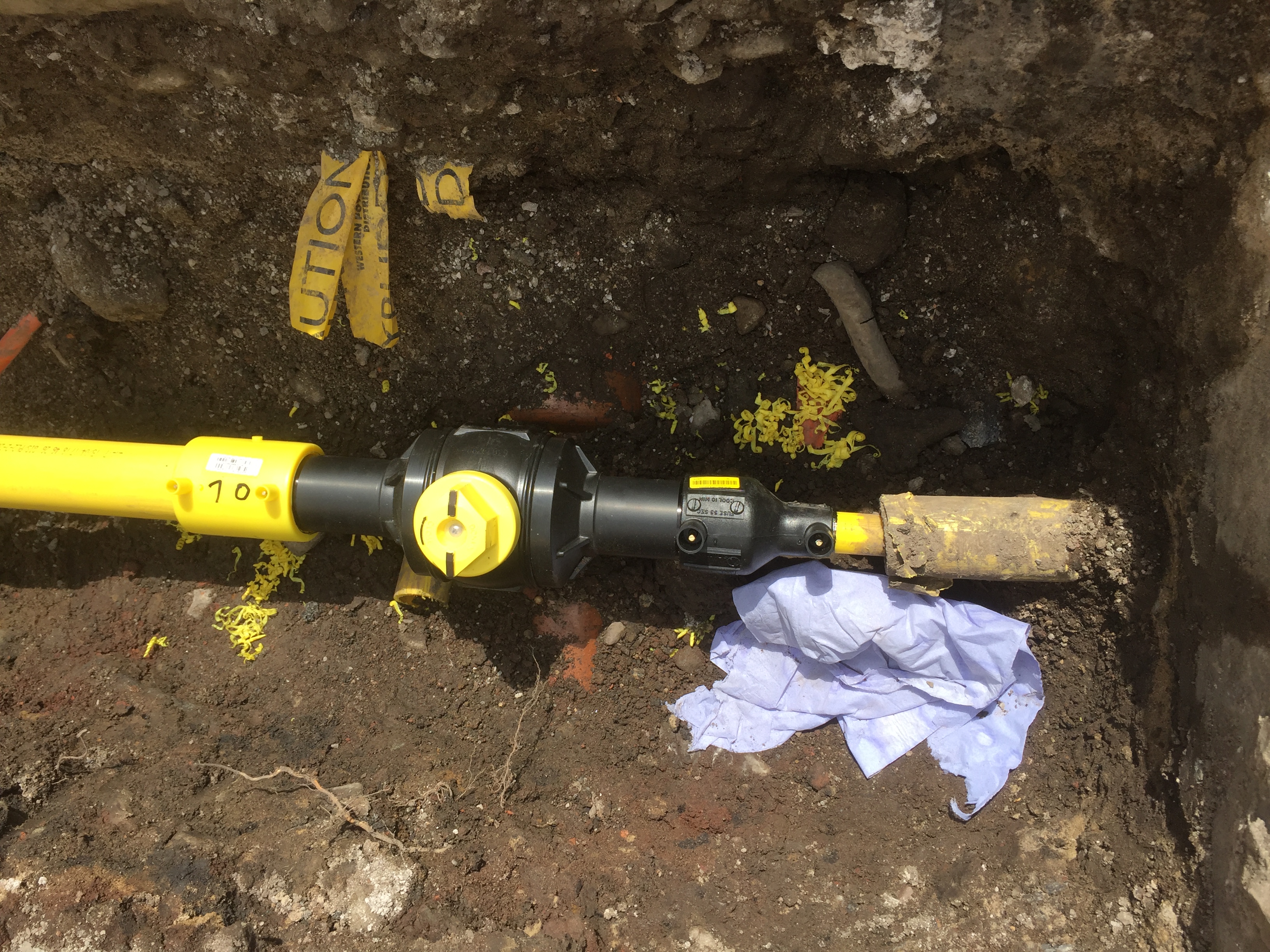

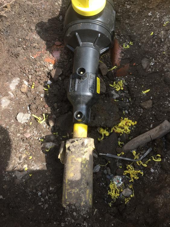

Full road closure booked for a Sunday as the shop traded on Saturday and the guys ( all two of them ) duly arrive at 8:00. They go over the road and find the pipe the other side of the road, which is 32mm o.O. They then tell me the screwed galv pipe was cut off and used as a conduit with a 32mm mdpe pushed down it to upgrade yesteryear.
Again, ok. ?

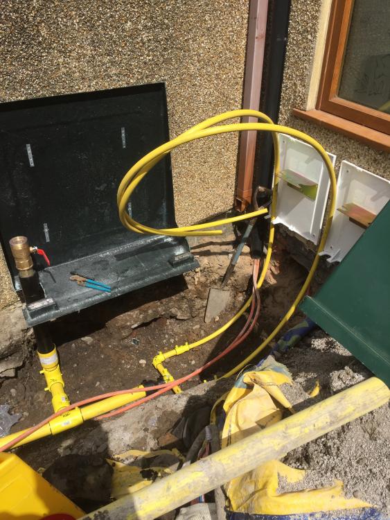

So so they make a 63mm manifold feeding a new u16 for the chip shop on 63mm pipework, and 2 x 25mm branches coming off it going to 2x u6 domestic metres for the flats.
I ask,  bearing in mind they've charged £1800 for the roadworks and manifold ( but could not charge any more for the pipe replacement as it's their responsibility to upgrade steel pipe for free under current legislation ),  when are they going to dig the road up and hook up the new 63mm pipe? They say "no need, we'll just hook the new 63mm emergency tap in the pavement to the 32mm and it'll be fine". Wtf.
New manifold with the 63mm red handled isolation.
Teed off for 2x u6's
New 63mm EGC in the pavement
And a bloody 32x63mm reducer back to front.
One rule for them and another for the payment line ??
