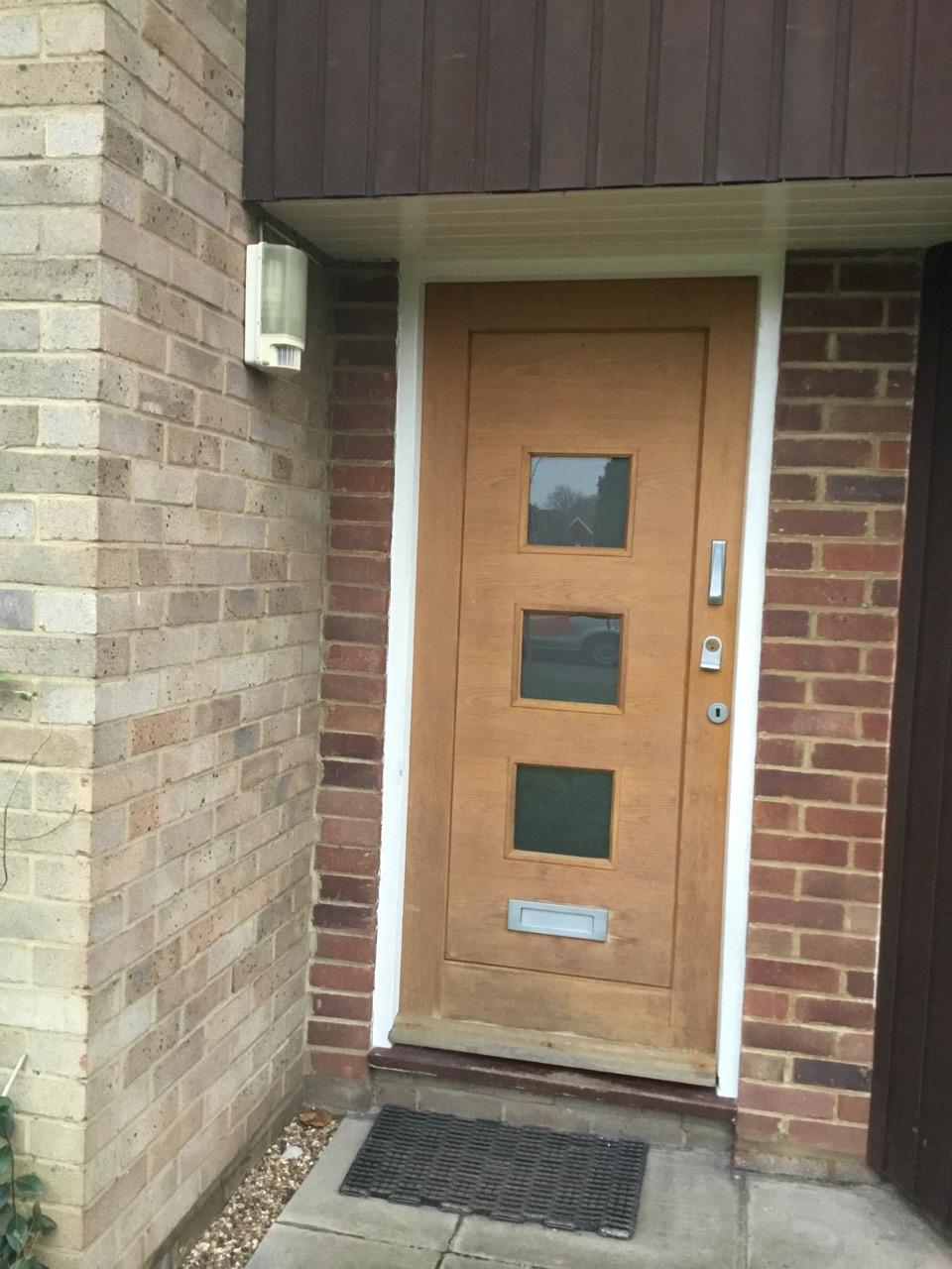

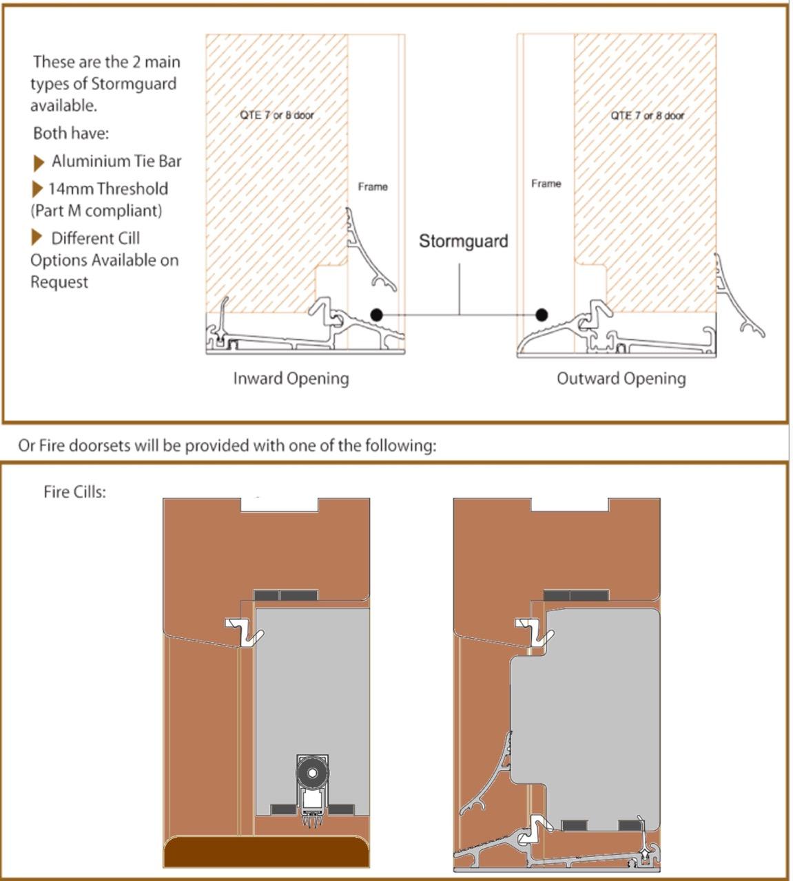

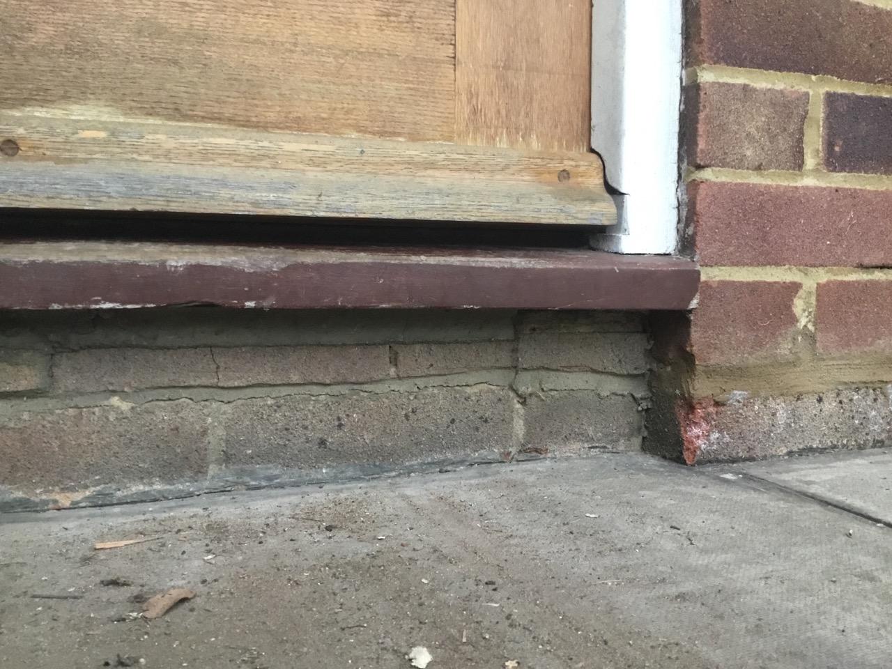

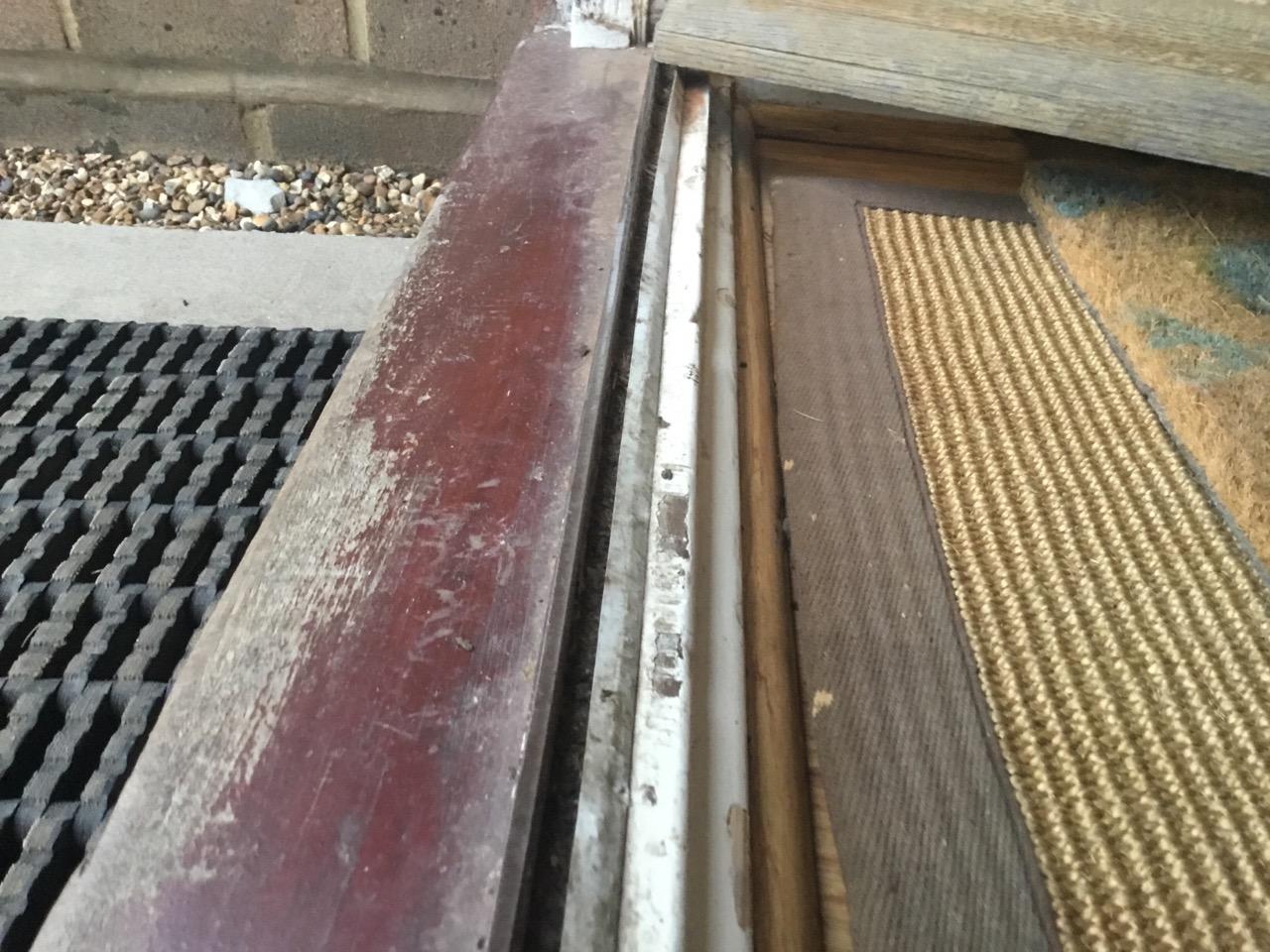

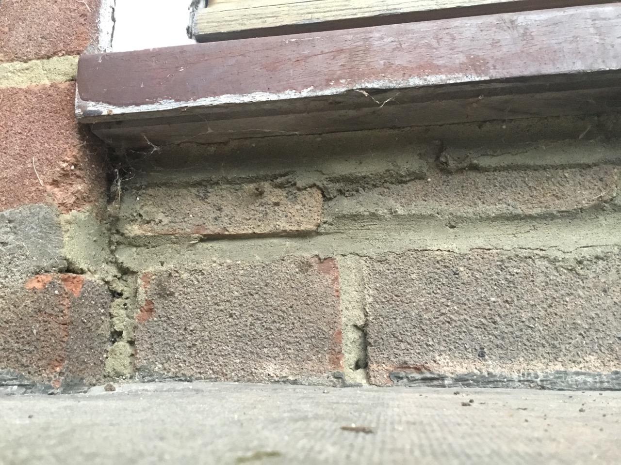

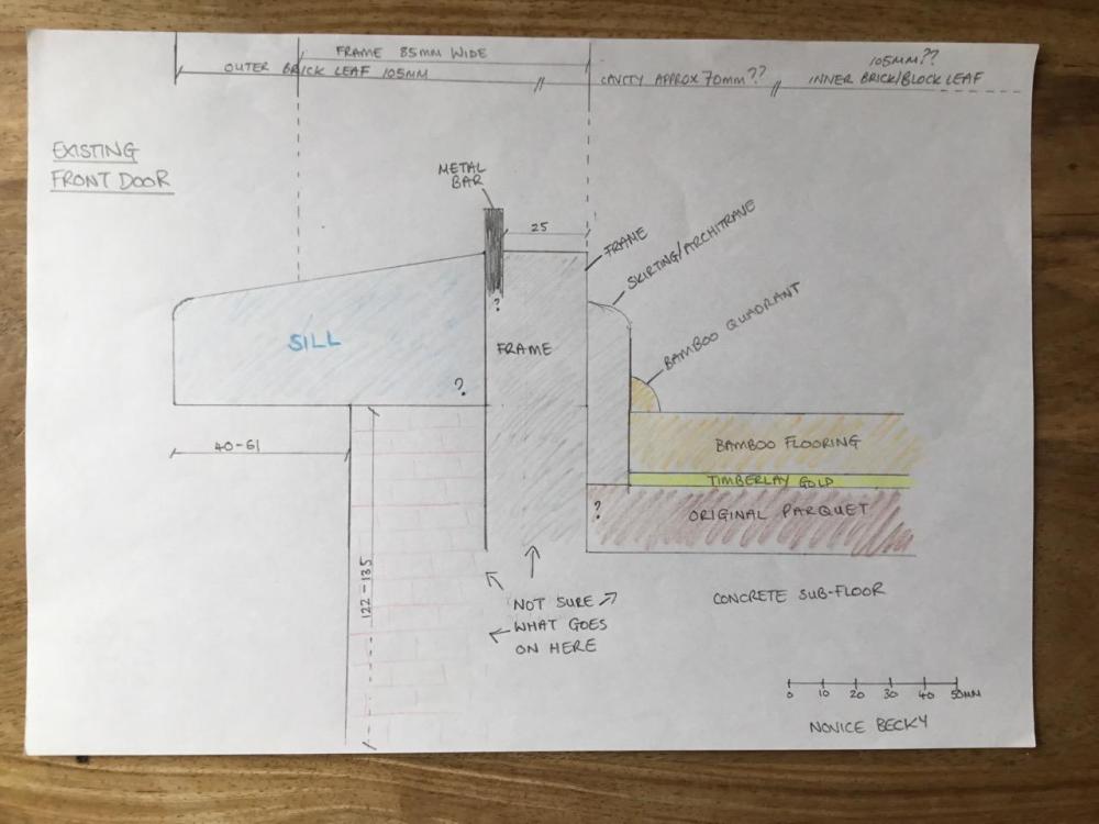

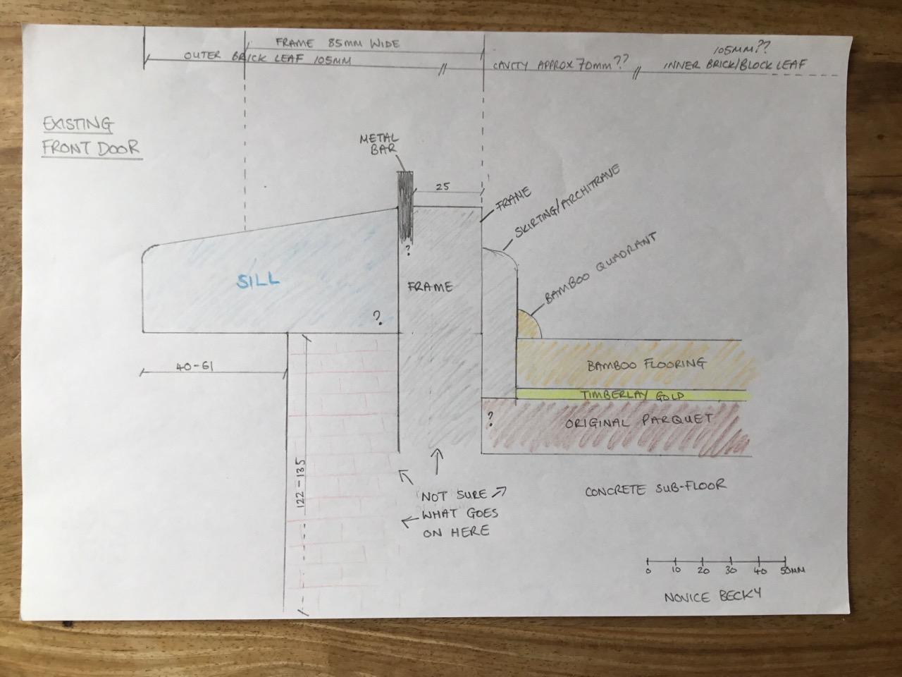

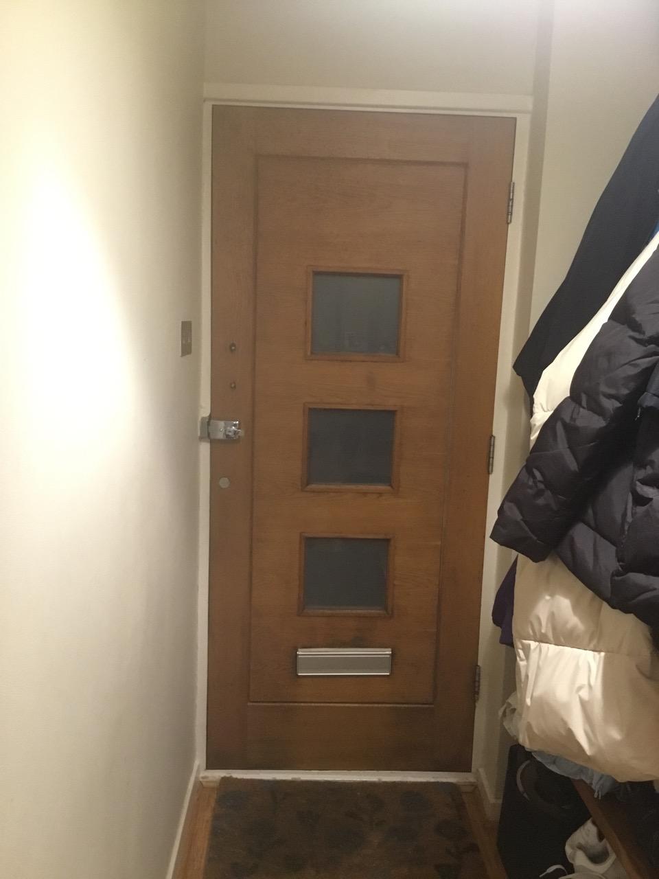

Novice Becky Posted February 23 Share Posted February 23 I'm measuring for 2 replacement windows and a composite front door in my 1960s bungalow. I've been putting it off as I can't find anyone to install only (I supply) but I really need to get on with it so I can get the failed CWI sucked out and replaced ... looks like I'll have to learn how to DIY. I think I'm going to order from Russell Timber. They're good value/spec and the windows look pretty similar to my other (expensive) windows. Door says it's 58mm Insulated Timber Veneered Composite Door hung in a 80*57mm Hardwood Laminated Frame. I'm stuck on how to work out the threshold details so I can measure the height of the door - and the width. HEIGHT I think I have to measure from the top of the existing door frame where it meets the horizontal wood bit (not sure what you'd call this? Soffit maybe). I've measured to the bottom of the sill outside at the threshold which is almost at the level of the finished floor inside (I'm not planning on a new floor, it's solid bamboo laid on top of old parquet with something like Timberlay gold underlay). I need to work out where the bottom of the door will end if that makes sense. The new door just has a thin aluminium threshold bar (see drawing) - Russell say they have different sill options. THRESHOLD DETAIL The existing door seems to be plonked on top of messy bricks and cement/mortar (photos). I’ve done a sketch but I don’t know what’s inside the threshold! The composite door will need to sit on something? I'd like something with better thermal properties than concrete. Do I need to remove some/all of the bricks under the existing door? I've been looking at insulated thresholds and came across Partel and Triotherm insulated door thresholds (there's also Compacfoam). Anyone used any of these products? see https://www.prodomo.ie/thermal-brackets/triotherm-as-thermal-base-for-doors/ So where do I want the door to end in terms of measuring for the height of the unit? It's not going to be a level threshold because there's a step down outside. What would you do? the wall is 280mm deep on the left (from outside) so will I need to place the door further back so it spans more of the cavity? DOOR WIDTH I've measured the door width outside - basically just brick to brick. The smallest measurement is 928mm. However the internal width is 898mm and if you look at photos there's not much room to play with internally. If I ordered 928mm less 20mm tolerance = 908mm wide this is still 10mm wider than the internal measurements. Does this matter? I don't know how thick the plaster is. The plaster is wet plastered straight on to block walls. Any suggestions/comments would be appreciated. This is all new to me. Or suggestions for people who could install (J9 of M25). Thank you Link to comment Share on other sites More sharing options...
Roger440 Posted February 23 Share Posted February 23 I dont know the answers, but as i need to buy a front door, im hoping you get some. Like you, i will need to fit myself. Nice drawing you have done there. Link to comment Share on other sites More sharing options...
Novice Becky Posted February 24 Author Share Posted February 24 It's a bit difficult to draw as I don't know what's inside. It would be good to know what to expect because I don't want to be without a front door for too long when I come to replace it. Please keep me posted if you gather any knowledge on how to fit a front door. Just looking for somewhere to buy one of these thermal supports. You can get them in Ireland but they don't seem to ship to UK. https://www.prodomo.ie/online-shop/#!/Thermal-Support-70-80-100-120-140mm-x-85mm-x-1-175mm/p/163970650/category=45495629 Link to comment Share on other sites More sharing options...

Novice Becky Posted February 25 Author Share Posted February 25 Thanks @Conor for your reply. I'm now calling this an experiment so I can allow myself to fail and risk wasting money (strange but works in my head somehow!). I don't want to have any more people to blame/chase for bad jobs. I just want it done and done well with no shortcuts, so I'm ok if I get it wrong. The potential gain is a warmer front door, being able to progress my retrofit and boosting my confidence and ability in general building. I'll start with the two windows down a side passage so by the time I come to the door I'll have had some practice. I've attempted lots of DIY jobs in the past and generally manage to get there even if it takes me a while. I'm sorted on the width and I'm getting my head round the threshold design, allowing for the doormat etc. And a timber frame is a bit more forgiving/adaptable if it all goes wrong! Link to comment Share on other sites More sharing options...
Roger440 Posted February 25 Share Posted February 25 On 24/02/2024 at 21:01, Conor said: You really want the company supplying the door to do the measurement. It can't be that hard, fairly standard in the industry. Doesn't matter who then fits it, just make sure the supplier takes the liability of measuring. Which is great in principle. But they simply wont come here. So self measurement is necessary, or the windows/doors wont get done. Yes, im limited who i can use because i need something that looks traditional, nt your run of the mill UPVC. But that just where we are. @novice becky please take pics of the threshold when you do it. Link to comment Share on other sites More sharing options...
Novice Becky Posted February 26 Author Share Posted February 26 @Roger440 Yes, I'll take pics but you may beat me to it. I'm very slow. In which case you'll have to take pics! I'm also wondering whether it might be a more attractive job for someone if I've measured and ordered so I can't blame them for getting it wrong (but now I'm having visions of a brand new badly fitted leaky front door). Link to comment Share on other sites More sharing options...

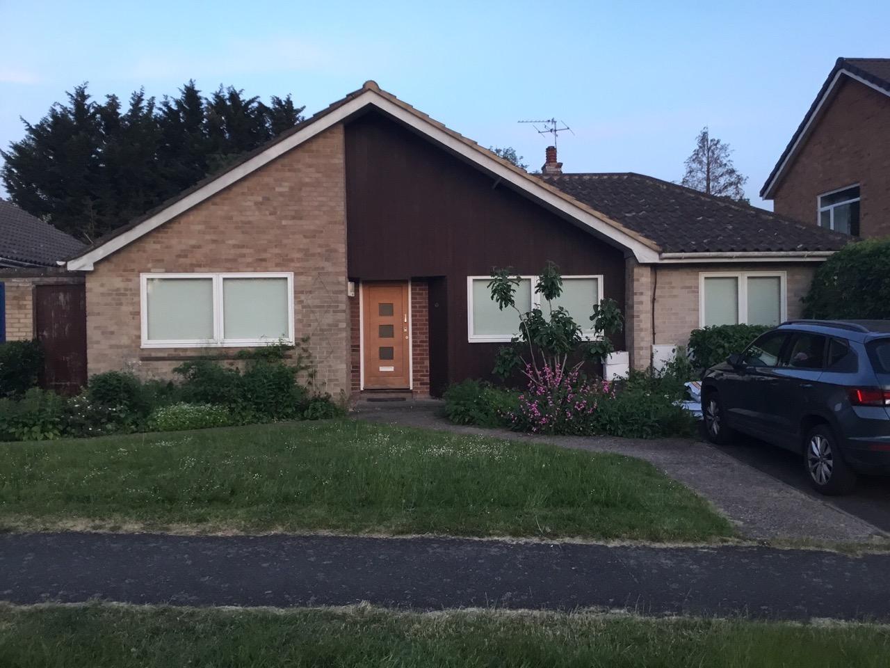

Novice Becky Posted September 23 Author Share Posted September 23 Hi @alexnh, apologies for the slow reply. Yes, I got a timber insulated front door from RTT in June. I was pleased with RTT. The ordering was as you'd expect with made to measure. I measured them myself and they were all a perfect size. And even with £500 delivery for just 2 windows and a door the total price was still good. They sent me the wrong handle but promptly sent me the correct handle when I spoke to them. They had a very limited choice of door knockers so I didn't get one from them. I managed to find one I could stick on with 3M tape to avoid drilling holes through an insulated door. Also you couldn't have a woodstain finish on the insulated doors even though they're timber. The install however was a different, shoddy story. Link to comment Share on other sites More sharing options...

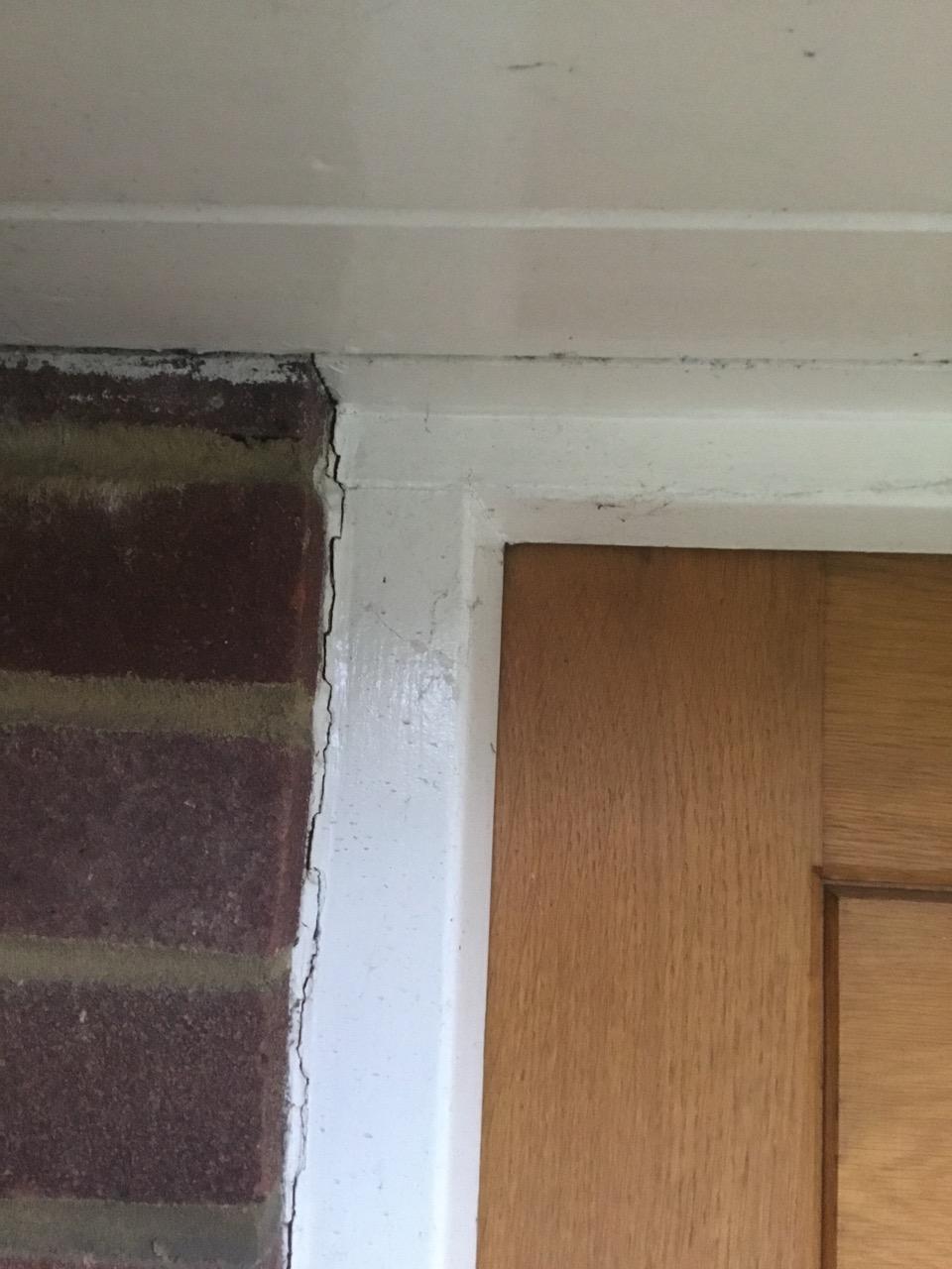

Novice Becky Posted September 23 Author Share Posted September 23 @Roger440 Did you get your door measured and fitted? I worked out my threshold detail in the end and carefully measured and calculated door size perfectly, allowing for door mat etc. But the installers didn't even check with me what height the threshold should be and cut the Compacfoam (insulated threshold used in place of concrete) without asking. So the door sits too low for a doormat and there's a big gap at the top of the door frame. Grrrr. Link to comment Share on other sites More sharing options...
