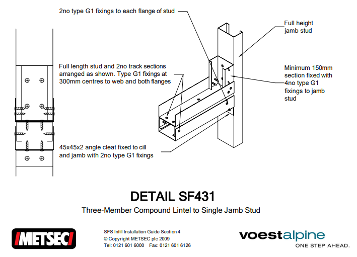

MortarThePoint Posted February 6, 2024 Share Posted February 6, 2024 I've fitted plenty of door linings for single doors now but am looking at my first lining for a double door. It's for a double 686mm door with 15mm couple so the span needs to be about 1393mm. Do I need to screw the head to something mid span? Link to comment Share on other sites More sharing options...
joe90 Posted February 6, 2024 Share Posted February 6, 2024 I would 👍, what is the lintel? Link to comment Share on other sites More sharing options...
nod Posted February 6, 2024 Share Posted February 6, 2024 You need to watch the lining for twisting Al’so I normally tack a diagonal string either corner and fix once they touch in the center 2 Link to comment Share on other sites More sharing options...

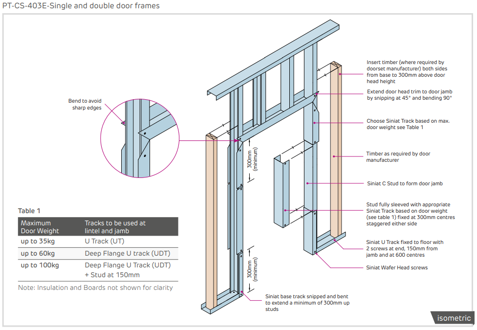

MortarThePoint Posted February 6, 2024 Author Share Posted February 6, 2024 1 hour ago, joe90 said: I would 👍, what is the lintel? It's in a 92mm metal frame partition (2 doorways under a beam). I've used the double track and c-stud detail attached for the lintel which is good. I added a 3x1 timber in the lower track so that should allow the door lining to be screwed to the lintel. I've adopted the attachment approach of the Siniat image (folding down the vertical stud). I haven't done so yet, but may add small c-stud sections to the upper track as Metsec suggest. 1 Link to comment Share on other sites More sharing options...
MortarThePoint Posted February 7, 2024 Author Share Posted February 7, 2024 To complete the information, the jambs are 92mm c-stud with CLS routed to slide inside and then a second c-stud with its web screwed to the timber. As shown in the previous post, the main jamb stud is then cloaked in deep track. It all feels very solid. Link to comment Share on other sites More sharing options...
