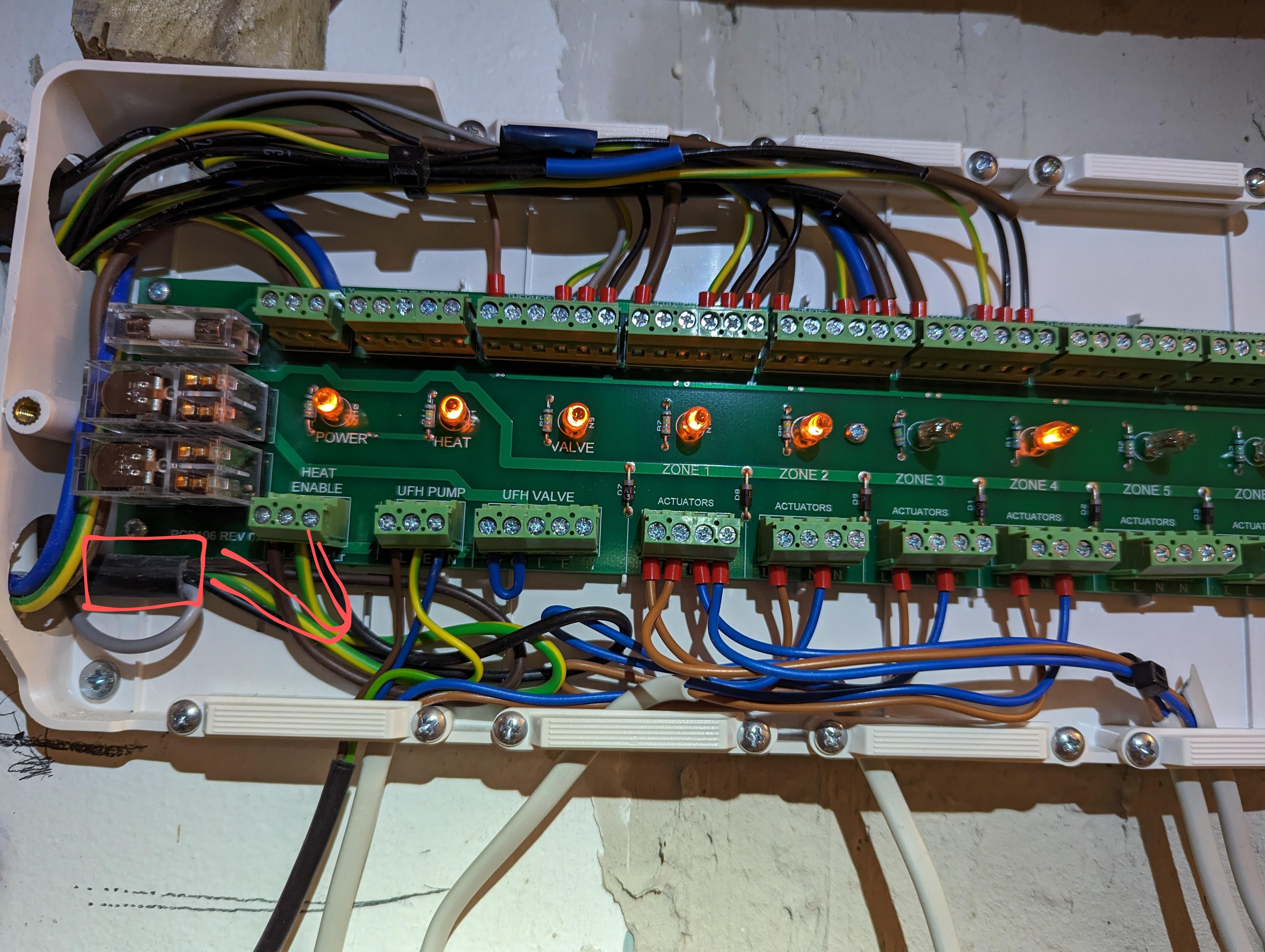

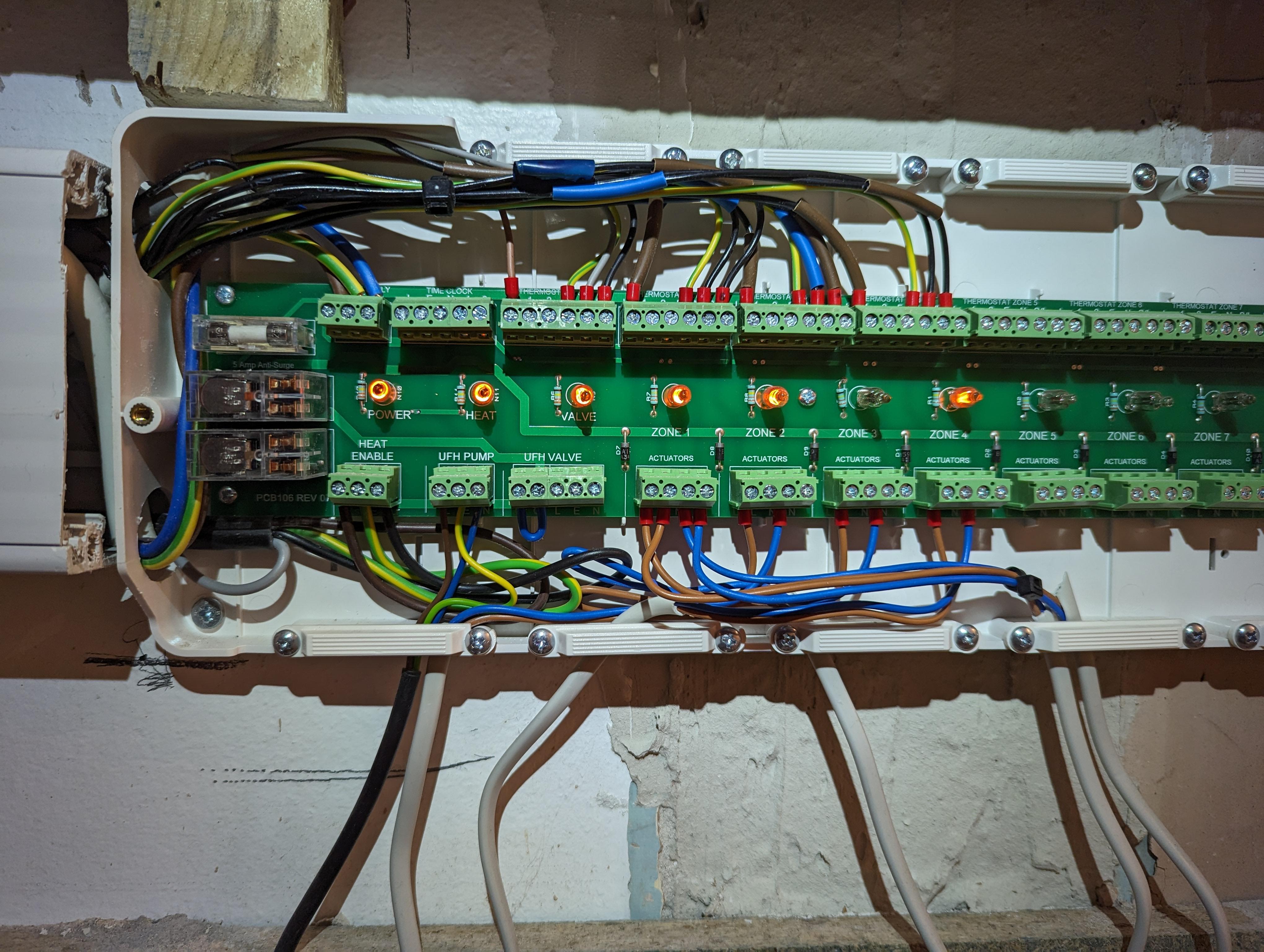

Here is a pic of the ufh8 wiring in area 2.
All looks ok. no valve on this 2nd manifold hence the loop 'UFH Valve"
I'll have to check FTC6 as suggested. I've opened it but bamboozled by all the switches etc. Will try and read some diagrams or instruction to find out where the 'heat enable' from this 2nd UFH8 controller should connect to on the Ecodan FTC6.

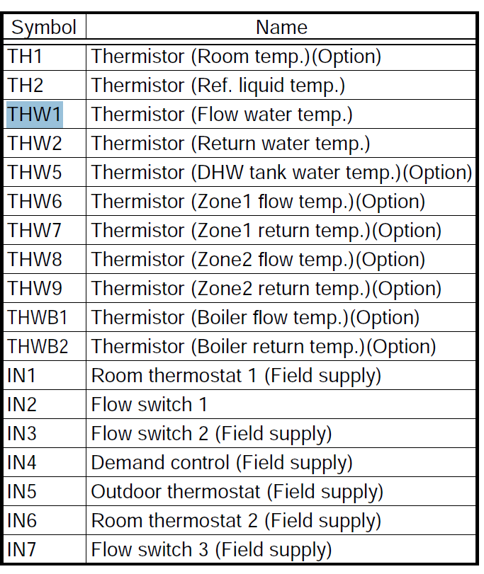

In your first post you ask how can FLOW temp go to 60 - in which FTC6 screen are you seeing a flow temp of 60? Is there some confusion with the Legionella hot water temp which is set at 60?
I was looking at the 'Thermister Reading' page. It was the THW1 which was set for the flow temp.

Try if you can to trace that cable back to the FTC6. I think these should go into TBI as that's where the inputs go, but these also depend on the DIP swtich settings. Although dealing with an earlier version, here is a thread I found that could be very helpful to read and it's about the same connections.
I would also look at all your setting as even on weather comp. zones flow temps can be set to 60C I believe.

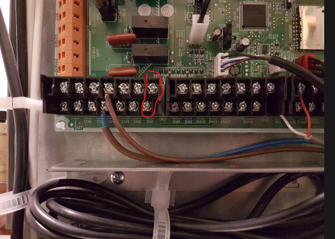

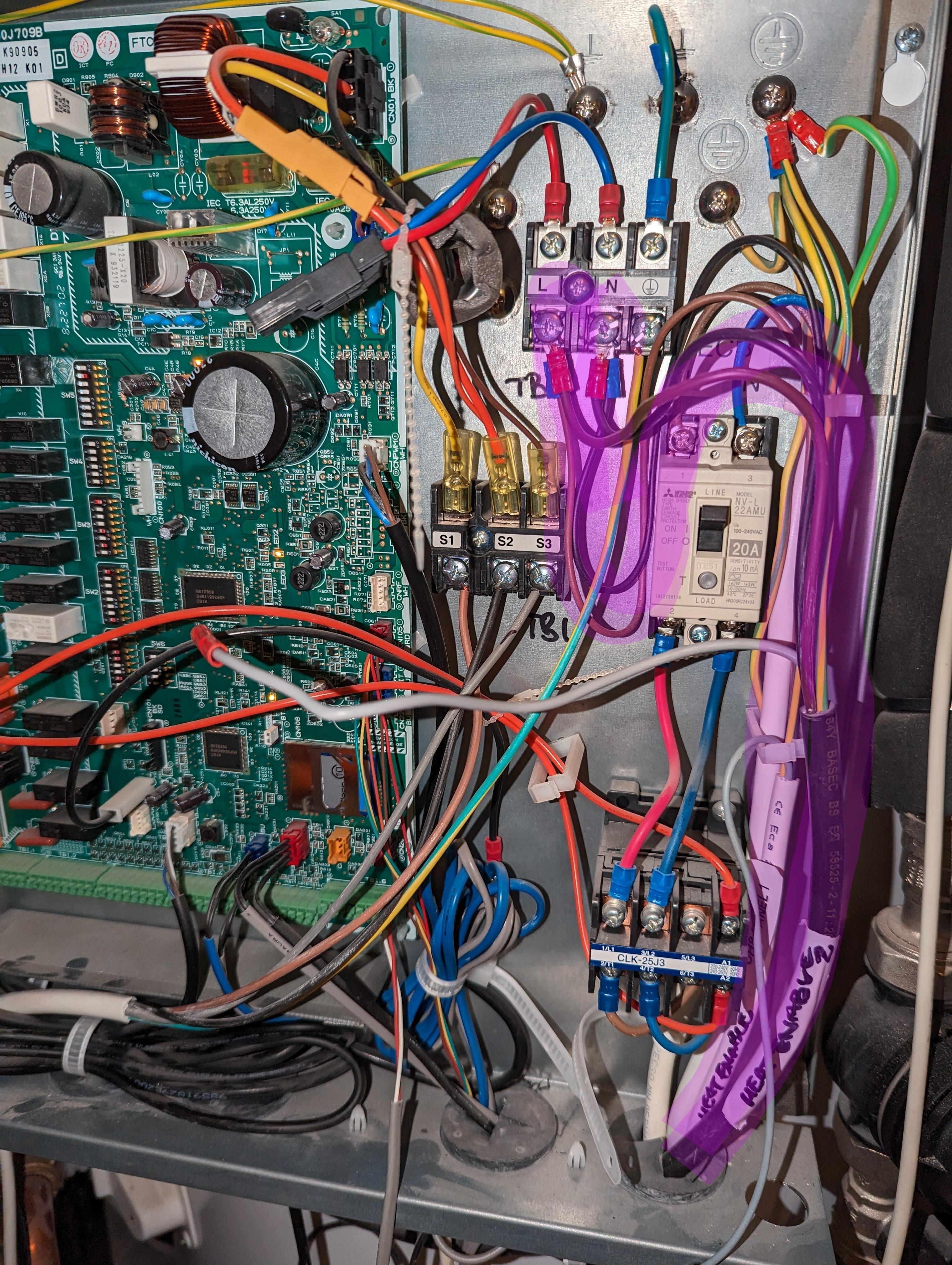

Ok, so I looked at the FTC6 now and have found the 2 cables (heat enable) from each of the UH8 controllers.
What I have found is that they are both wired into the L/N/E block but nothing at all into any of the input terminal blocks.
Given that, I dunno how this is working but it seems to be, just doesn't seem like its working right but... The stats call for heat, the heat pump sends the hot water to the manifolds but how?
And could this also be the reason for the erratic flow temps?

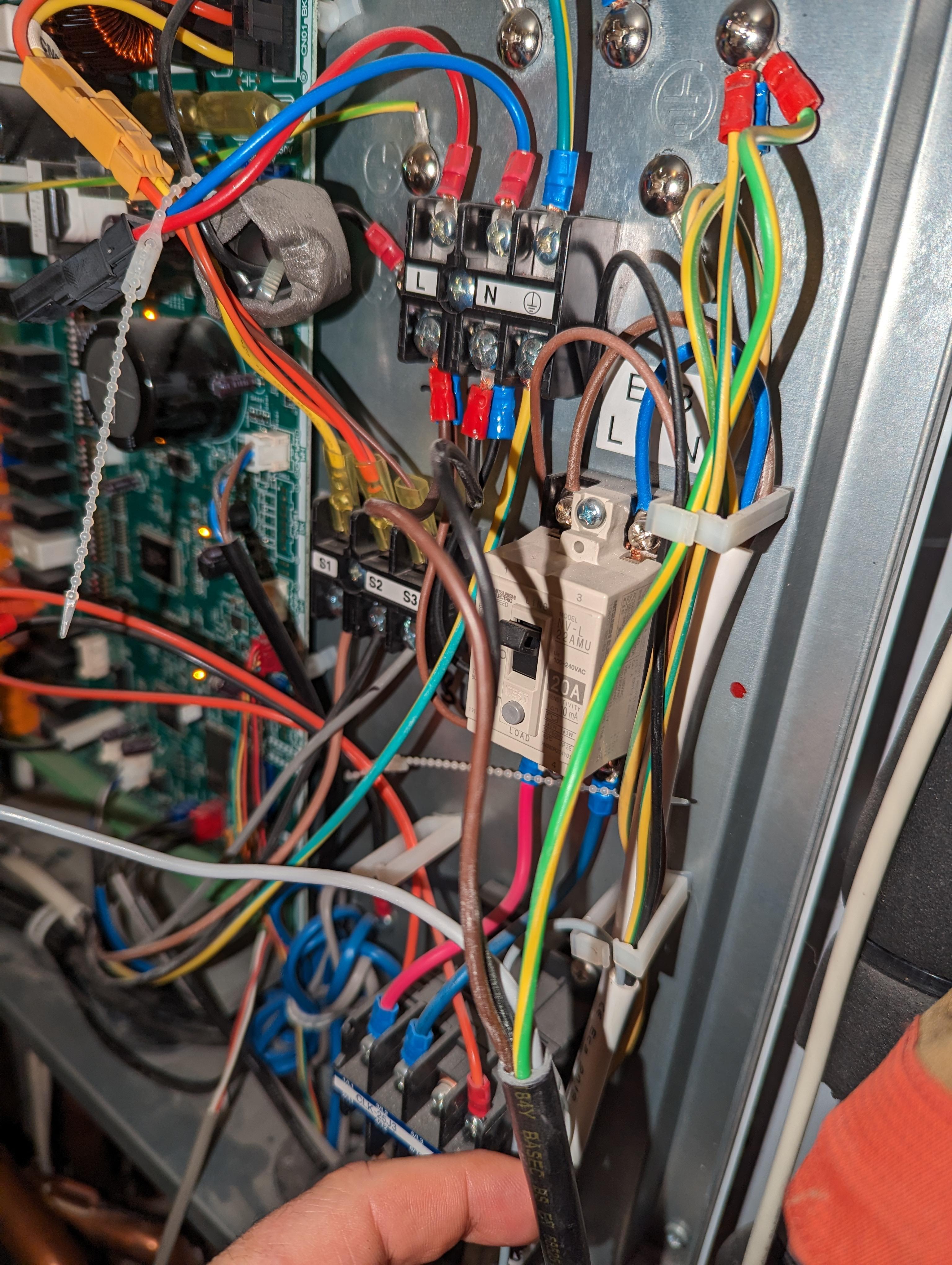

Have you got a photo?
On the other end, the heatmiser UH8, the brown is connected to "Ls" the green and yellow is connected to "E" and black is connected to "Lr".
WRONG cable.  At the UH8 it is a white 3 core cable connected to the Heat Enable terminals.  You are looking at a black 3 core cable there.  you need to find out where that WHITE 3 core cable ends up.
Nah it's deffo black cable at the uh8 end.
It also had a label on it at FTC (just below my finger) "Heat enable 2."
Hope it's not a totally wrong type of cable he's used as it'll be a bastard to chase a new one between the two points.
So that looks very wrong! It looks like your LR from the UH8 is going to neutral on your FTC control board. I'm surprised there isn't a blown fuse somewhere. Have you checked the voltage you're getting at the Heat enable LS and then LR when it's calling for heat?
Have you checked what wires are connected to your TBI.1 & TBI.2 terminal blocks? (bottom horizontal row of the FTC6)
Nothing at all from uh8's connected to the terminal block. Both wires in from each uh8 connected to the same spot on FTC as in pic.
Not checked the voltage back on uh8 when calling for heat.
I have a multimeter somewhere so will do that tomorrow. Thanks again.

At the UH8 controller,
With the multimeter, when holding the red probe on Lr and black on Ls there is 0 volts. If I move one probe to the earth I get 5.7v when it's calling for heat.
Same numbers where they connect at the FTC end.

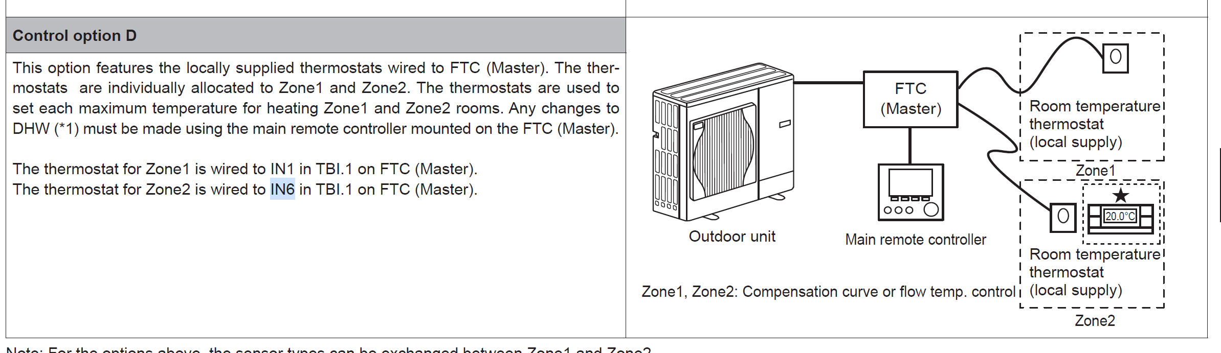

Is it a matter of moving the Ls and Lr on the FTC end into the terminal blocks IN1 and 6 as per the manual?  I assume I can leave the earth as it is.

The guidance is to wire them into the terminal block on the FTC, which I get. What I'm unsure of is which of the 'strands' within the "heat enabled" cable from the heatmiser controller controller go into the terminal block (there are 3 strands (Lr/Ls/E)) so which ones go to terminal block?

They need to be on IN-1 for single zone operation, that's where my UH8 is wired to, so Lr and Ls need to go to IN-1

If you check the voltage at the top two wires where the terminals are label L & N on the FTC6, which is TB2, what do you get? You should see mains voltage there. Across S2 & S3 below you should see a variable DC voltage around about 20VDC.
Thanks Gary, the FTC6 the terminal block looks slightly different but I've now removed them from TB2 and into IN1 and IN6 as per pic.
Turned all power off to do so and when powered back on everything is up and running again. Heating and hot water flowing to both manifolds
Interestingly, back on the UFH, when measuring the voltage on the heat enabled, it now reads 12v where as before it was 5.
When checking voltage on the IN1 and IN6 on FTC6 they now read 0.012 or something like that.
Where they were connected before, to L/N/E it they were reading 5.7v.
I'm no expert but if your heat pump is set to a single zone I don't think IN6 will be doing anything as it has be to enabled for 2 zones, if you turn off the thermostats that are linked to the UH8 that is wired to IN1 and leave the thermostats wired to IN6 still calling for heat does the heat pump continue to run?

This is the option from the instructions that best represent what I'm trying to do.
