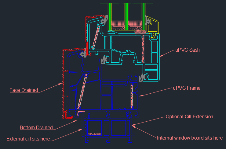

craig Posted February 15 Share Posted February 15 (edited) The first question is there appears to be no cill extension at the bottom of the window. Where is the cill extension, was this offered with the windows or was it offered without. If without, was it because the window is face drained or are the windows bottom drained? If bottom drained, then how is the external cill connected to expel the water or is the stone cill being used? You'll know if it's face drained, as it will have slots on the frame externally and cover caps over the slots. If the cill extension was present, then the window sits up 30mm approx. and you don't have the issue but you are where you are. Take of the bottom brackets, fit an L bracket instead to the outer wall and you're not bridging the cavity tying back to the inner wall. You'll pick up the below brackets in Screwfix Secondly, ground floor, where's the lockable handle on the window? It should have one, you'll need lockable handles for your home insurance to be valid unless this is an escape window. You should have approx. 20mm of the frame all around to overlap for finishing, the less the better as you're going to be tight for tolerances. Edited February 15 by craig Link to comment Share on other sites More sharing options...
JackofAll Posted February 15 Author Share Posted February 15 4 hours ago, craig said: The first question is there appears to be no cill extension at the bottom of the window. Where is the cill extension, was this offered with the windows or was it offered without. If without, was it because the window is face drained or are the windows bottom drained? If bottom drained, then how is the external cill connected to expel the water or is the stone cill being used? You'll know if it's face drained, as it will have slots on the frame externally and cover caps over the slots. If the cill extension was present, then the window sits up 30mm approx. and you don't have the issue but you are where you are. Take of the bottom brackets, fit an L bracket instead to the outer wall and you're not bridging the cavity tying back to the inner wall. You'll pick up the below brackets in Screwfix Secondly, ground floor, where's the lockable handle on the window? It should have one, you'll need lockable handles for your home insurance to be valid unless this is an escape window. You should have approx. 20mm of the frame all around to overlap for finishing, the less the better as you're going to be tight for tolerances. Face drained window and lime stone cill. Tbh never heard of an extension until reading your post. Am I right in saying drill the cill to mount L bracket to and then screw up into window frame? Now that you mention lockable handles, never occurred to me, none of the windows have them, is this something that I should have requested or something that should have been provided? Link to comment Share on other sites More sharing options...
craig Posted February 15 Share Posted February 15 (edited) 2 hours ago, JackofAll said: Am I right in saying drill the cill to mount L bracket to and then screw up into window frame? To the external wall then up into the frame, it’s going to be a bit of a ballache tbh. 2 hours ago, JackofAll said: is this something that I should have requested or something that should have been provided? Something that should have been requested and pointed out to you tbh, for the reason mentioned. Edited February 15 by craig 1 Link to comment Share on other sites More sharing options...

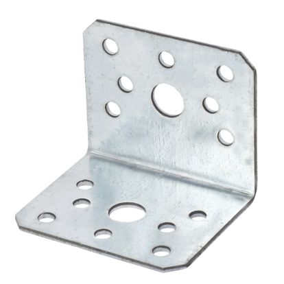

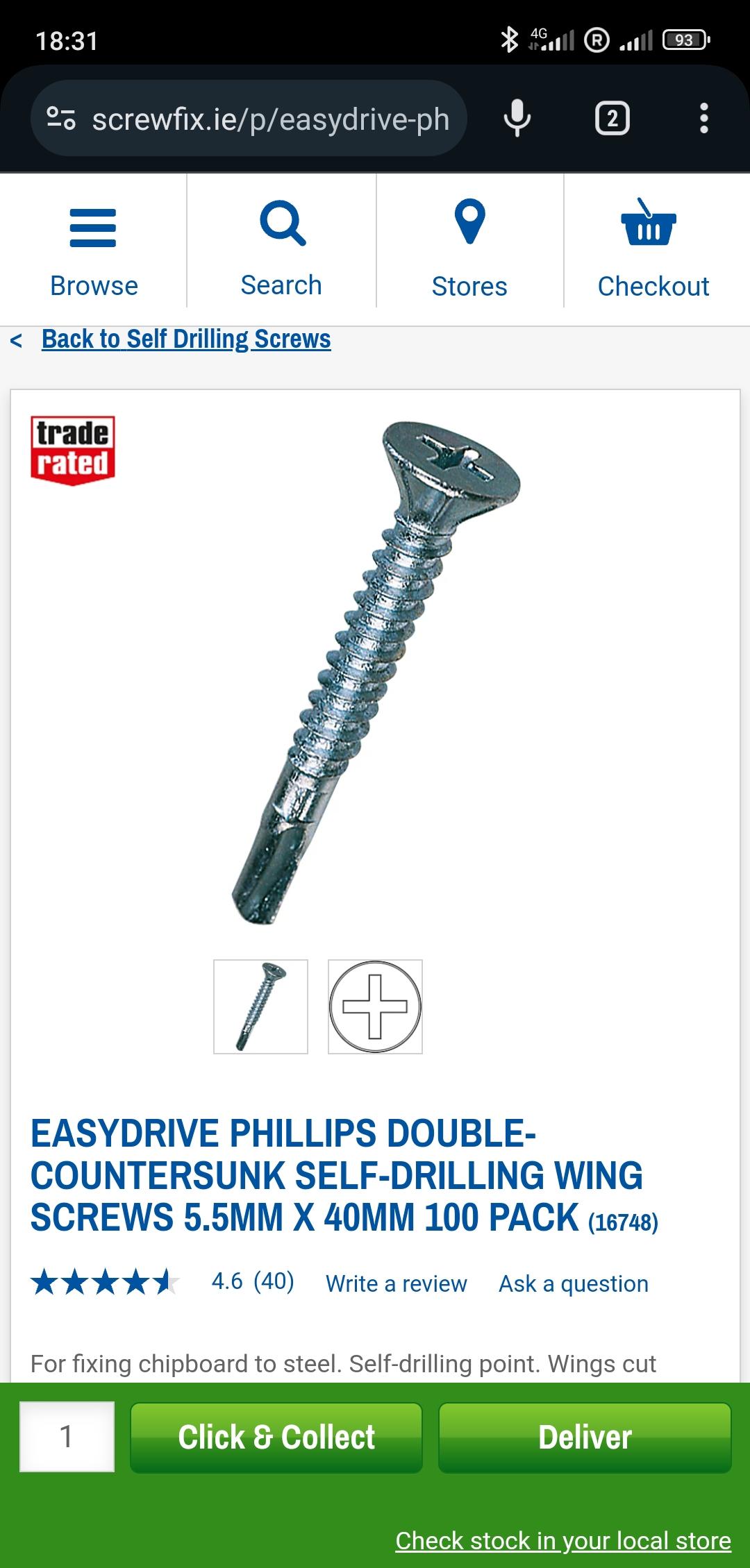

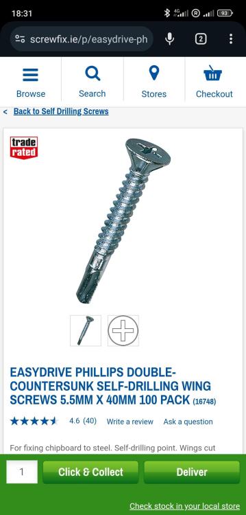

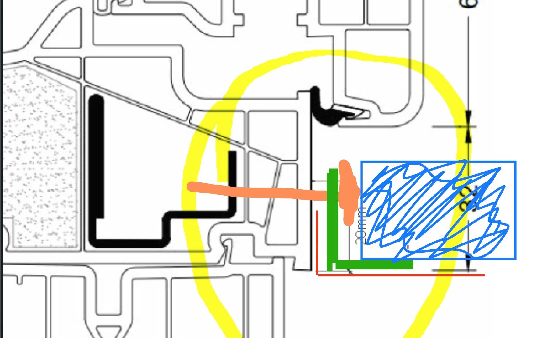

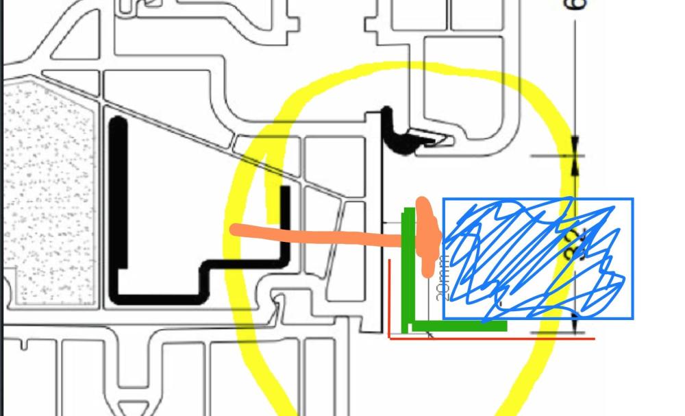

Iceverge Posted February 18 Share Posted February 18 Ok how about this. Apply the tape and membrane as above to the 4 sides to air seal the window. Including the brackets. Then but one of these. And screw it into the bottom of the window using something like this. It'd be better to get the screws into the steel frame of the window. There's a rough sketch. 1. Red tape and airtighess member. 2. Green angle bracket 3. Orange self drilling screw into steel frame. 4. Blue window board. You can level the inside of the board with timber on top of the wall. Or perhaps leave a slant towards the room. It'll be less lightly to catch the opening window then with only 7mm clearance. Link to comment Share on other sites More sharing options...
JackofAll Posted February 18 Author Share Posted February 18 47 minutes ago, Iceverge said: Ok how about this. Apply the tape and membrane as above to the 4 sides to air seal the window. Including the brackets. Then but one of these. And screw it into the bottom of the window using something like this. It'd be better to get the screws into the steel frame of the window. There's a rough sketch. 1. Red tape and airtighess member. 2. Green angle bracket 3. Orange self drilling screw into steel frame. 4. Blue window board. You can level the inside of the board with timber on top of the wall. Or perhaps leave a slant towards the room. It'll be less lightly to catch the opening window then with only 7mm clearance. Thanks @Iceverge, will be starting the reveals this week, this is a great help. Just wondering would 15mm PB on reveals be better or not? Link to comment Share on other sites More sharing options...
Iceverge Posted February 19 Share Posted February 19 It'd be a bit stronger but not massively. It'd be a thicker J bead too so maybe harder to screw into the correct place. The sketches I did use your actual profile. You can see how tight it is. . 1 Link to comment Share on other sites More sharing options...
