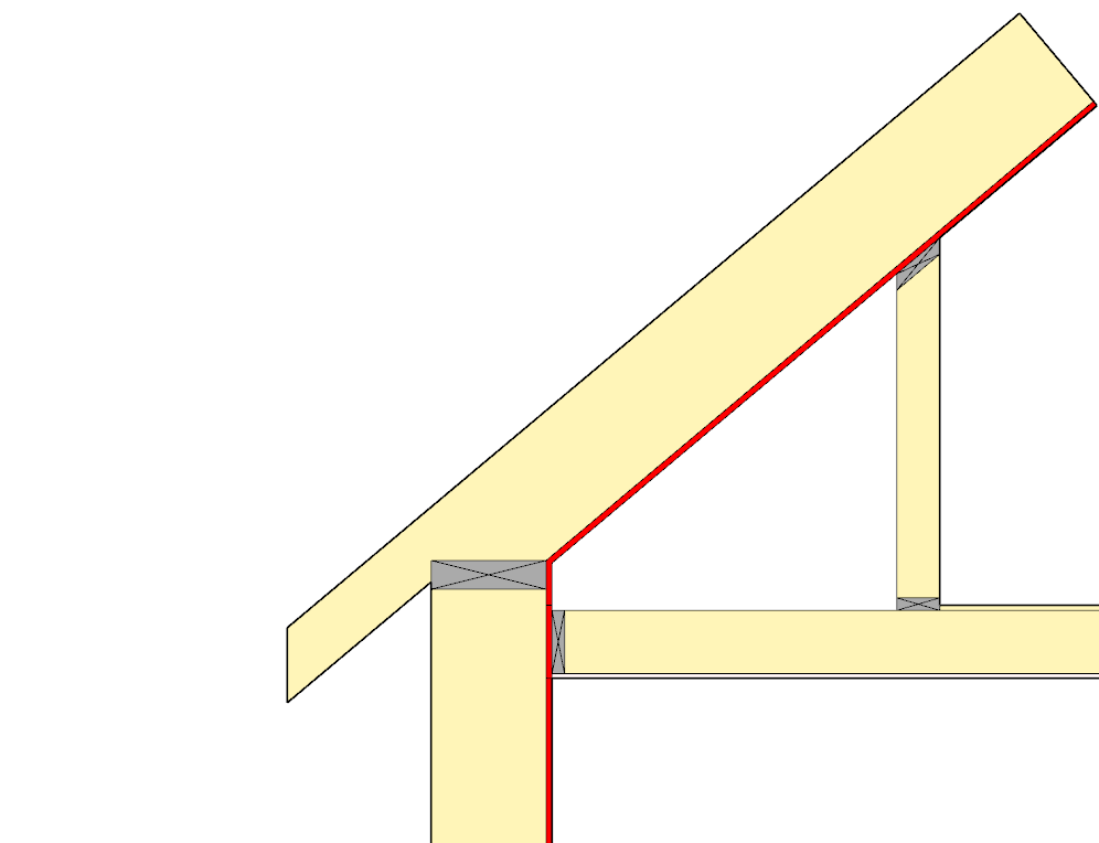

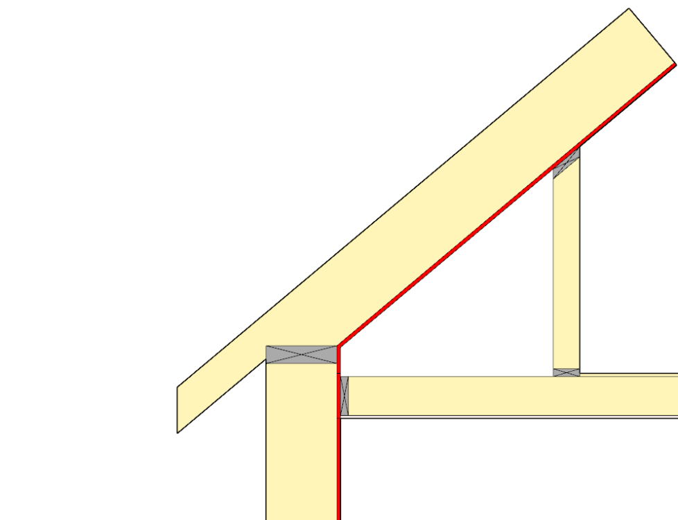

Iceverge Posted February 3, 2024 Share Posted February 3, 2024 Ok here's an option for a cut roof. The red line is airtightness membrane/board In essence it separates the roof and wall and internal bracing is added afterwards. The fasteners would be taking a fair strain in this case so best run it by an SE. Link to comment Share on other sites More sharing options...
