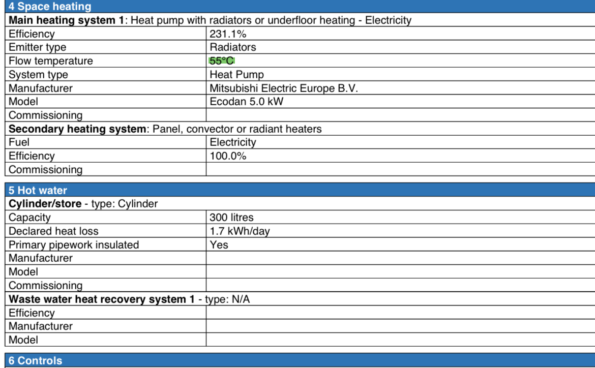

PNAmble Posted February 2, 2024 Share Posted February 2, 2024 Ours said 231.1% with a flow temp of 55. Based on our 5kw Ecodan. Which is probably true. What does your report say the flow temp is ? We are intending to run our radiators at 35 so when we do as built I’ll make sure this is corrected. Our design also stated 35 but I couldn’t be bothered to argue as it was still an A95. Link to comment Share on other sites More sharing options...
Post and beam Posted February 3, 2024 Author Share Posted February 3, 2024 16 hours ago, PNAmble said: What does your report say the flow temp is ? It didn't say anything. It does not mention what make or model of heat pump either. It was created by my TF company and before i go back and ask them where the 219% figure comes from i was hoping to have a little more knowledge. I want to run the UFH flow at 35 degrees maximum. I have emailed Vaillant tech support to see if they can point me at some credible facts and figures. If, in fact, the 219% refers to COP/SCOP then i know Vaillants own site is up over 4. Link to comment Share on other sites More sharing options...
PNAmble Posted February 3, 2024 Share Posted February 3, 2024 (edited) 1 hour ago, Post and beam said: didn't say anything mine has this .. we hadn’t decided on a hot water cylinder when we got it done. Edited February 3, 2024 by PNAmble Link to comment Share on other sites More sharing options...

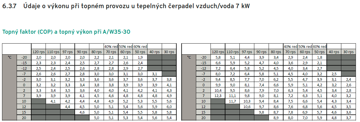

sharpener Posted February 3, 2024 Share Posted February 3, 2024 Here you go: Link to comment Share on other sites More sharing options...
Post and beam Posted February 3, 2024 Author Share Posted February 3, 2024 ? Link to comment Share on other sites More sharing options...

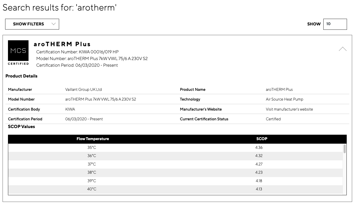

Dan F Posted February 3, 2024 Share Posted February 3, 2024 46 minutes ago, sharpener said: Here you go: Thats COP not SCOP though. The values used for SAP are up on MCS website. Values for 35-55C design flow temp. 4.36 was used for my SAP AFAIK. Link to comment Share on other sites More sharing options...

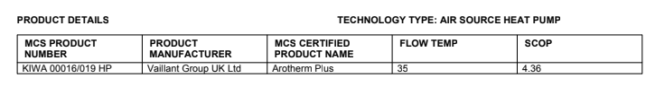

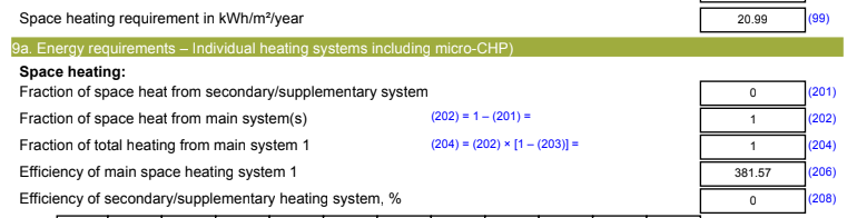

Dan F Posted February 3, 2024 Share Posted February 3, 2024 (edited) My MCS certificate (for 7kW aroTherm Plus) says: I'm unsure if/how this is used in SAP though.. anyone know? Or if SAP uses it's own numbers SAP Worksheets looks like it says "381.57 efficiency", no idea where this comes from though.. Edited February 3, 2024 by Dan F Link to comment Share on other sites More sharing options...
Post and beam Posted February 3, 2024 Author Share Posted February 3, 2024 6 hours ago, Dan F said: I'm unsure if/how this is used in SAP though.. anyone know? Or if SAP uses it's own numbers Exactly that question. Difficult to decipher how 4.36 and 219% relate to each other. Link to comment Share on other sites More sharing options...

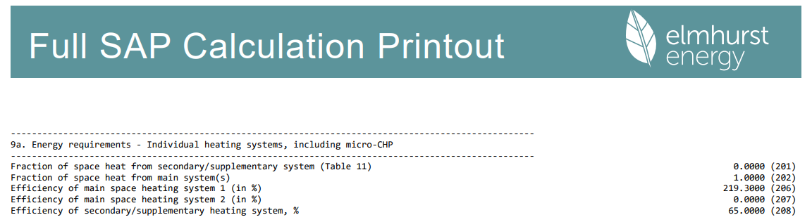

Dan F Posted February 3, 2024 Share Posted February 3, 2024 4 minutes ago, Post and beam said: Exactly that question. Difficult to decipher how 4.36 and 219% relate to each other. Or, in my case 4.36 and 381.57. Where do you see the 219%, I'm seeing 381.57 here: Link to comment Share on other sites More sharing options...

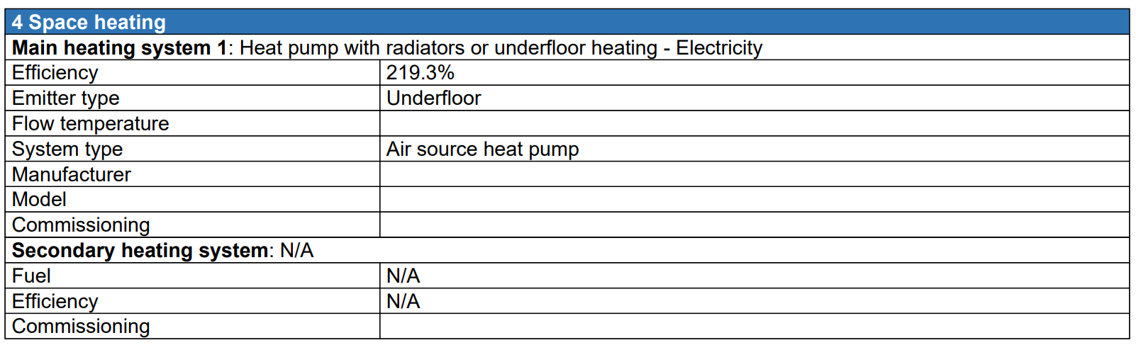

Post and beam Posted February 4, 2024 Author Share Posted February 4, 2024 15 hours ago, Dan F said: Where do you see the 219% Here Dude Link to comment Share on other sites More sharing options...

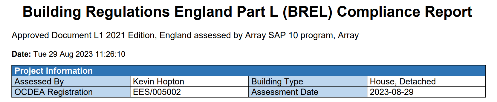

Post and beam Posted February 4, 2024 Author Share Posted February 4, 2024 And if i look in the full SAP report that i have just re discovered i get this.... Link to comment Share on other sites More sharing options...
