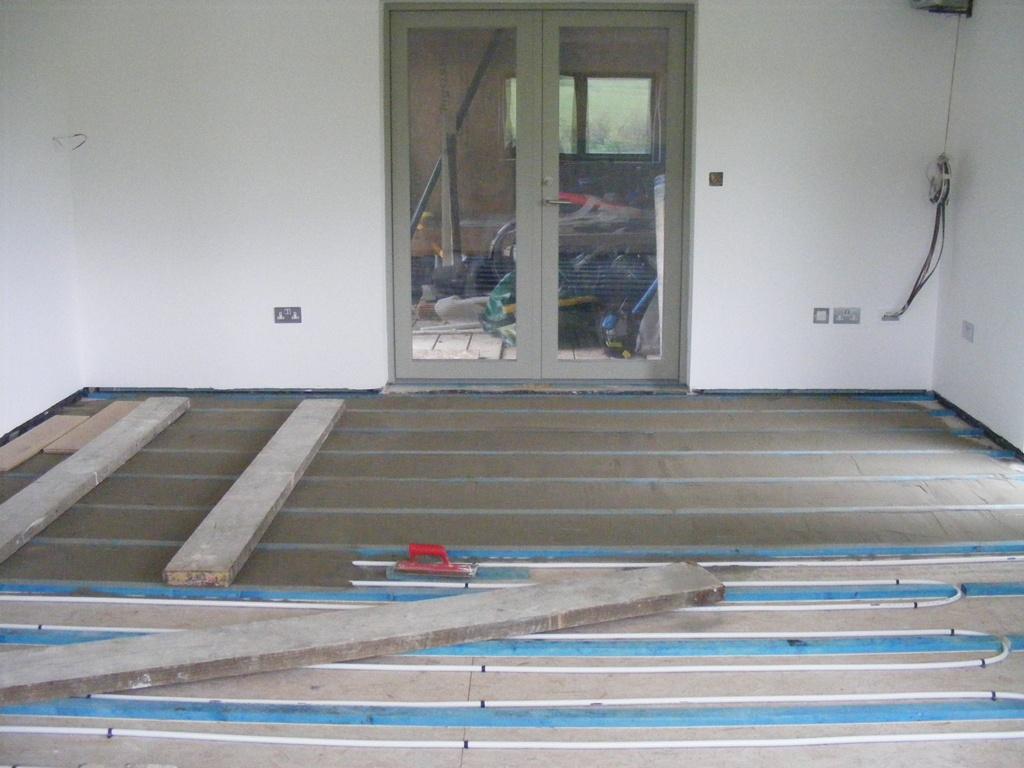

ProDave Posted February 2, 2024 Share Posted February 2, 2024 I used dry screed often called pug mix. On top of joists lay OSB or ply, 25mm battens following joists, lay UFH pipes then dry screed, final floor (engineered Oak) on top. Very easy to DIY. Don't forget to include extra dead load when calculating joist sizes. Link to comment Share on other sites More sharing options...
bassanclan Posted February 2, 2024 Share Posted February 2, 2024 I used aluminium spreader plates. They seem to do the job nicely Link to comment Share on other sites More sharing options...
