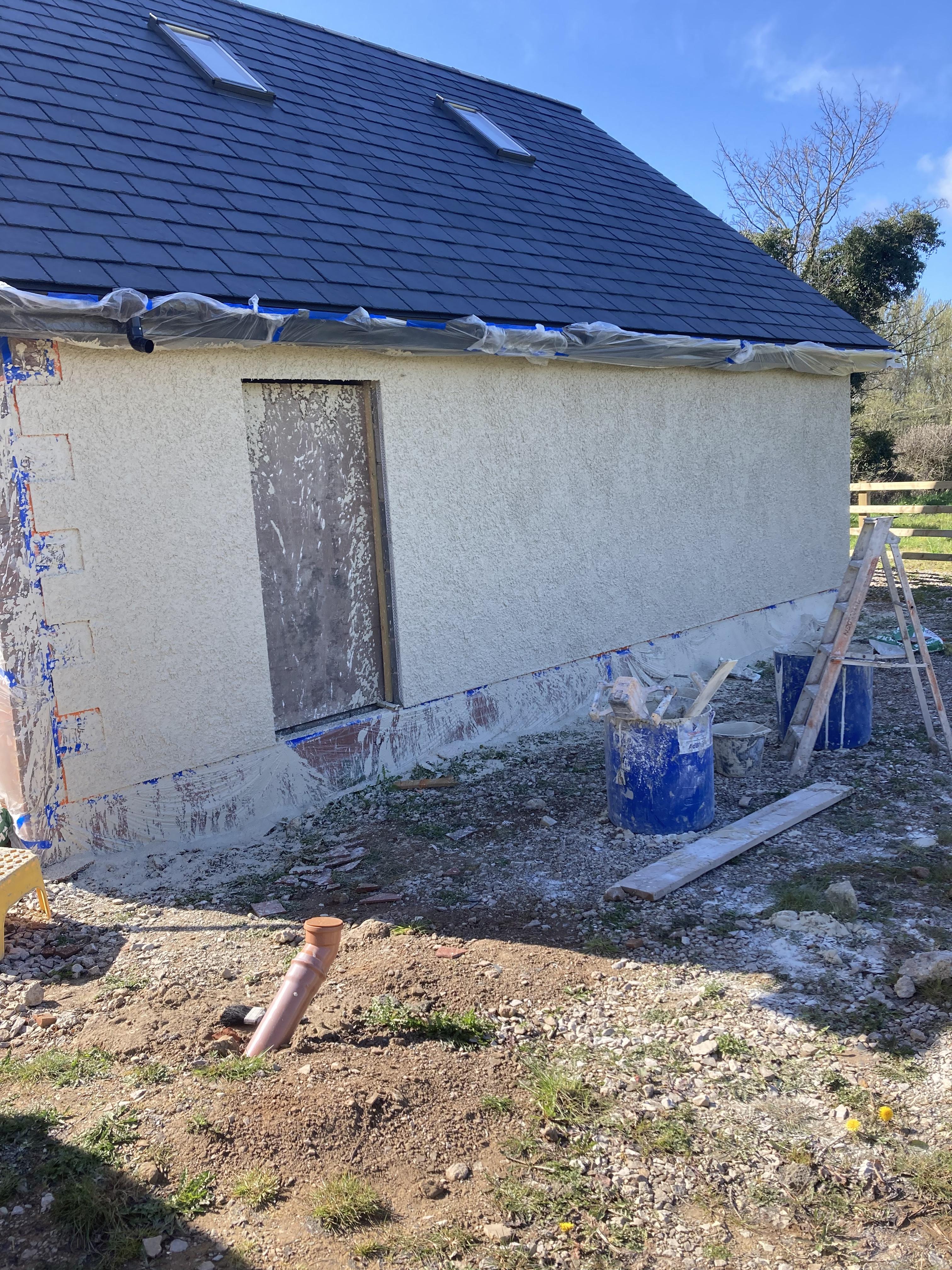

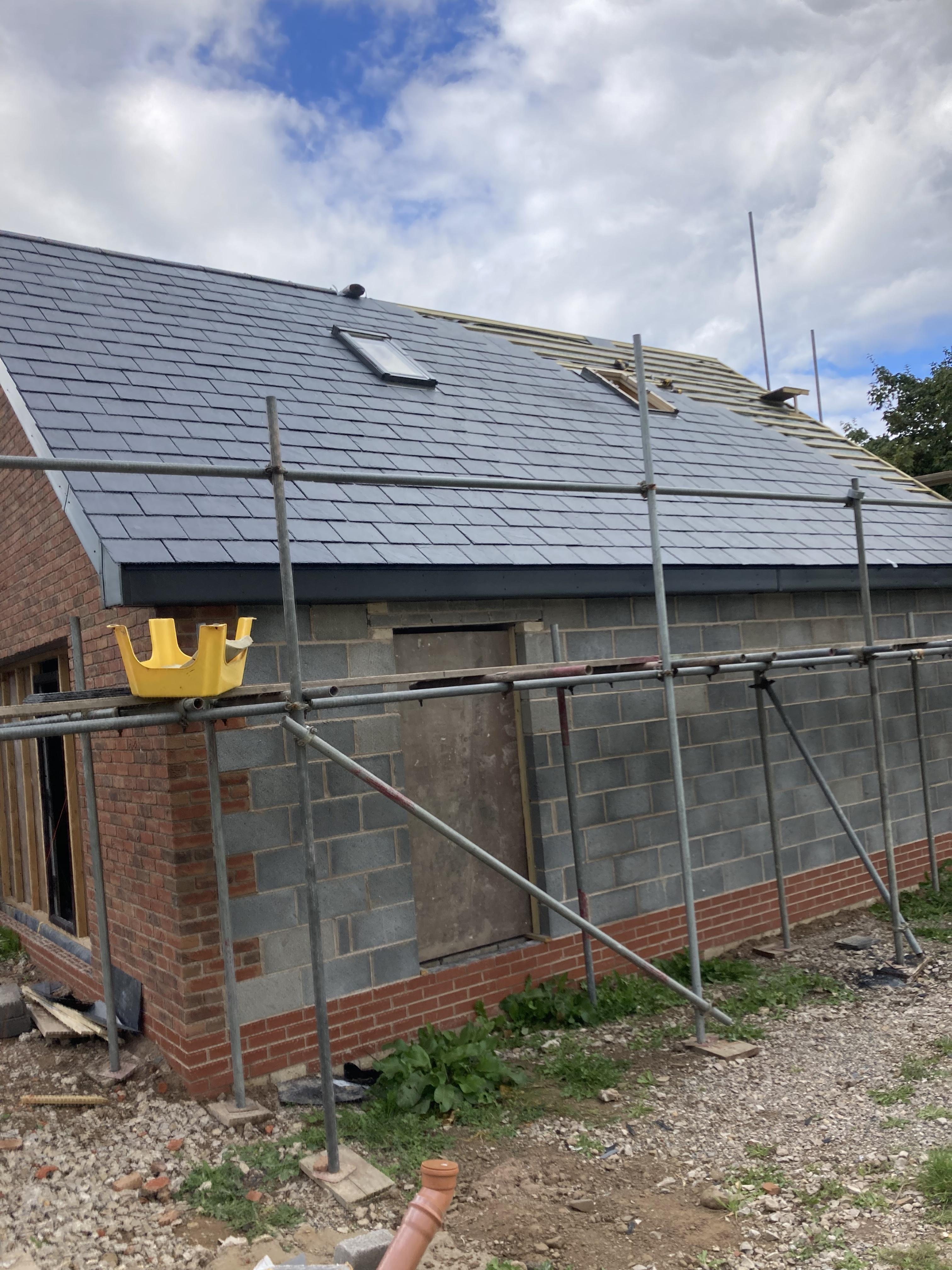

nod Posted February 2 Share Posted February 2 Just now, nod said: ours is 10x8 and we simply slated it nothing fancy But looks ok Link to comment Share on other sites More sharing options...

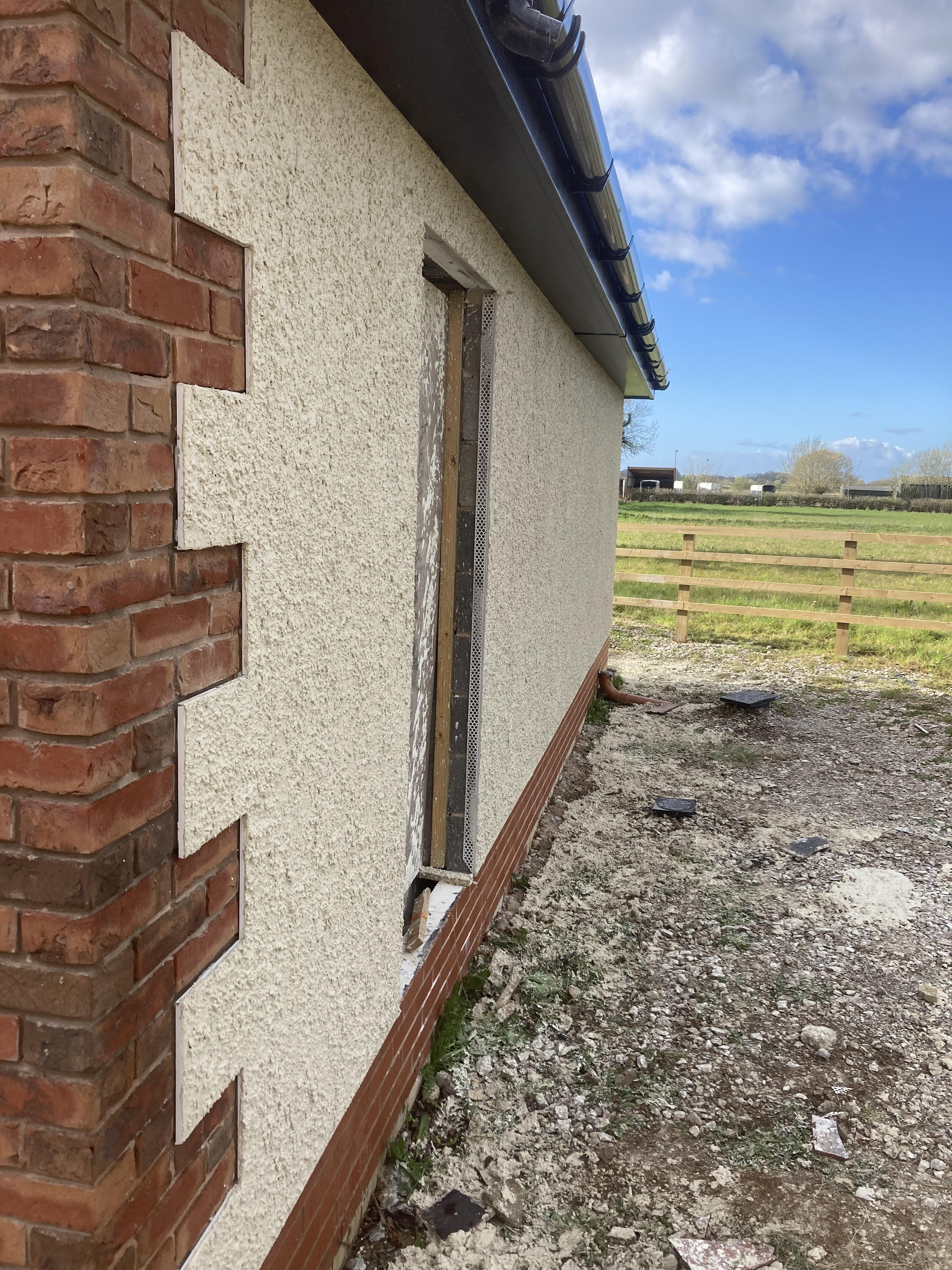

Moonshine Posted February 2 Share Posted February 2 17 minutes ago, nod said: sloppy rendering, i would get rid of those cowboys 🤣 1 Link to comment Share on other sites More sharing options...

nod Posted February 2 Share Posted February 2 4 minutes ago, Moonshine said: sloppy rendering, i would get rid of those cowboys 🤣 The best of it is I’ve several machines for spraying Wet dash But my wife wanted it hurled like we used to do 30 years back Link to comment Share on other sites More sharing options...
