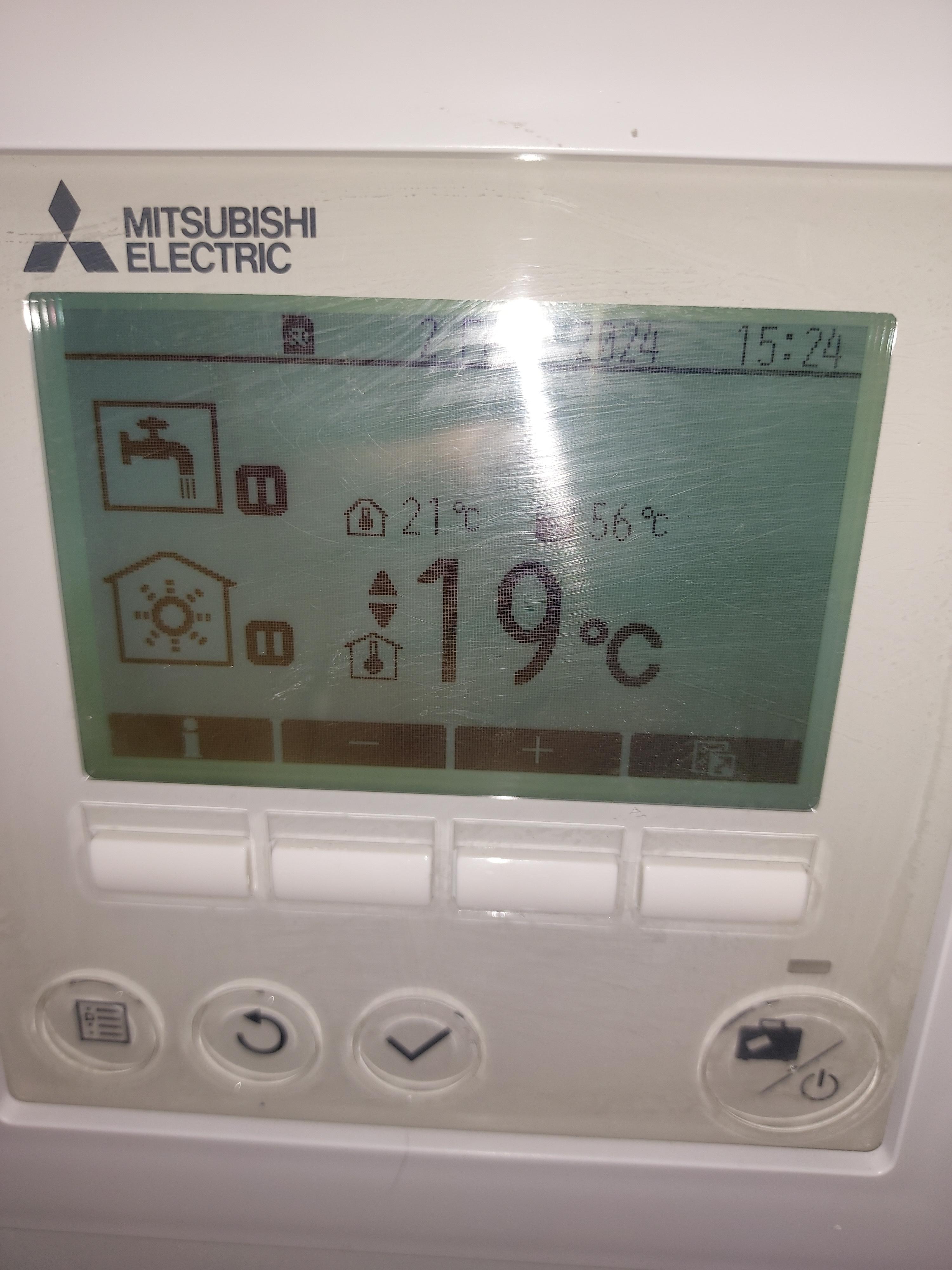

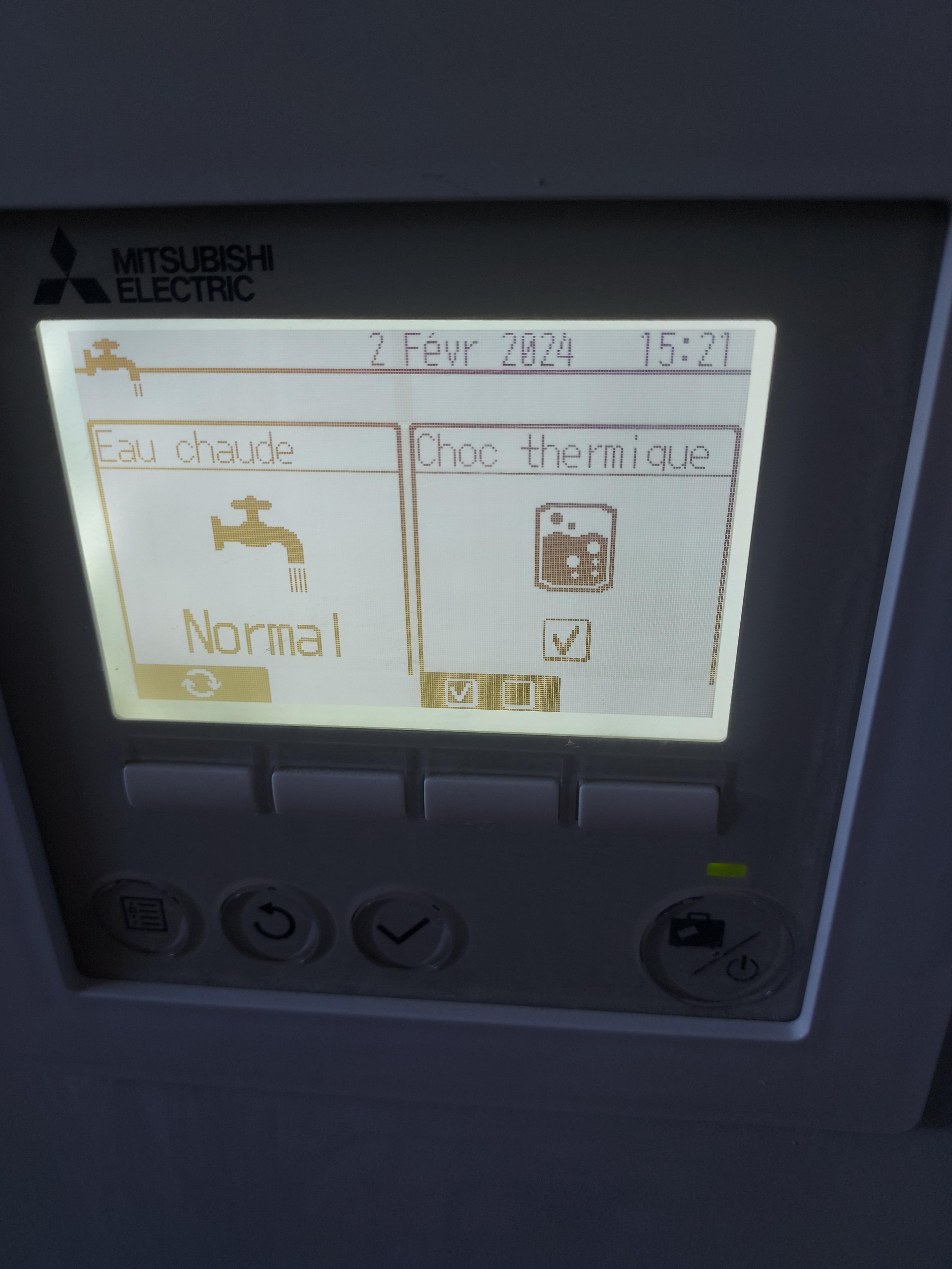

joth Posted February 2, 2024 Share Posted February 2, 2024 11 minutes ago, Garald said: On a different note - I think I may have improved my shower settings (improved for my comfort, possibly destroying the planet in the process and/or doing very minor damage to my wallet) by accident while fiddling with the settings yesterday. The maximum temperature in my shower is usually acceptable but sort of lukewarm (mid-30s). Now and then it behaves like a proper hot shower without warning. This morning the temperature was glorious (mid-40s?) - my girlfriend was delighted. This is what my settings look like now. Is everything in order? Looks like you've set tank temperature to 56° and turned on the immersion heater (Choc thermique?). That will hurt your wallet. You should be able to get acceptable shower temps of 48° or so without needing the immersion on all the time. Link to comment Share on other sites More sharing options...

Garald Posted February 2, 2024 Author Share Posted February 2, 2024 13 minutes ago, joth said: Looks like you've set tank temperature to 56° and turned on the immersion heater (Choc thermique?). That will hurt your wallet. You should be able to get acceptable shower temps of 48° or so without needing the immersion on all the time. I thought "choc thermique" set as it is is just for legionella? At any rate, I'll follow the video so as to fix things. Link to comment Share on other sites More sharing options...
Garald Posted February 2, 2024 Author Share Posted February 2, 2024 23 minutes ago, Gary68 said: Video on how to set your hot water temp. The problem is that; while my controller looks just the same, it doesn't give me all those wonderful detailed options in the heating menu. On the left, I can just choose between two modes - "Normal" and "ECO". I may have set it on "Normal" yesterday. I just set it to "ECO". No idea what temperature range that corresponds to - I'll see tomorrow morning. As for "choc thermique", I thought it was necessary to keep one of the two arrows checked to kill legionella? Link to comment Share on other sites More sharing options...
Gary68 Posted February 2, 2024 Share Posted February 2, 2024 Are you sure you are pressing and holding the menu button until the menus come up, its a press and hold to get to the settings a quick press doesn't get you there its at 2.28 in the video Link to comment Share on other sites More sharing options...
Garald Posted February 4, 2024 Author Share Posted February 4, 2024 (edited) On 02/02/2024 at 15:50, PhilT said: You are in "read only" mode. If you want to change any settings, from the FTC6 main home screen you need to press and hold the bottom left button for a few seconds. After that the domestic hot water settings window on the left in your last photo above will also show an edit symbol next to the two arrows in a circle. You should then also be able to change your WC settings. There are several YouTube videos on how to do this Ah, will try that then, thanks. So, I should set the hot water temperature to 48C, and leave the "choc thermique" (to protect against legionella) activated? Also, what is a sensible curve? 45C was enough at -4C (even though it stayed under 0C for several days). I did all computations so that the house would be fine with a flow temperature of 40C even at -7C (leaving myself a margin of safety, obviously - but by a factor of less than 2). If I leave the flow temperature at 50C for an outside temperature of -15C, and set the flow temperature at a notional -30C for an outside temperature of 35 C (the only parameter I can currently control), that means that the system will bother to turn itself on when the line y = 50-((50-(-30))/(35-(-15)))*(x-(-15)) = 26 - (8/5)x meets y=x, and it is to see that that happens when x=10, i.e., when the outside temperature is 10 C. A pretty sensible value in a well-insulated house, I'd say, no? It's slightly silly for the system to draw that as a line all the way to the right when it should be something \_ - shaped, but hey. At the same time, the flow temperature when it is -5C outside will be 34C, which seems to be low-ish. (It does make perfect sense for the "curve" to be a line for the most part: for the sake of equilibrium, you want the difference between flow temperature and room temperature to be proportional to the difference between room temperature and outside temperature, so flow temperature has to be an affine linear function of outside temperature.) Let's say I go with 40C at -5C, and that I'm happy letting the heat-pump work (with a flow temperature of 15C) starting when it's 15C outside. (In theory, that should really be 19C or whatever one's ideal temperature is, but that's a bit daft and eco-unfriendly.) Then the flow temperature at -15C should be 47.5 C, and the flow temperature at 35 C should be -10C. Does this sound good? Edited February 4, 2024 by Garald Link to comment Share on other sites More sharing options...

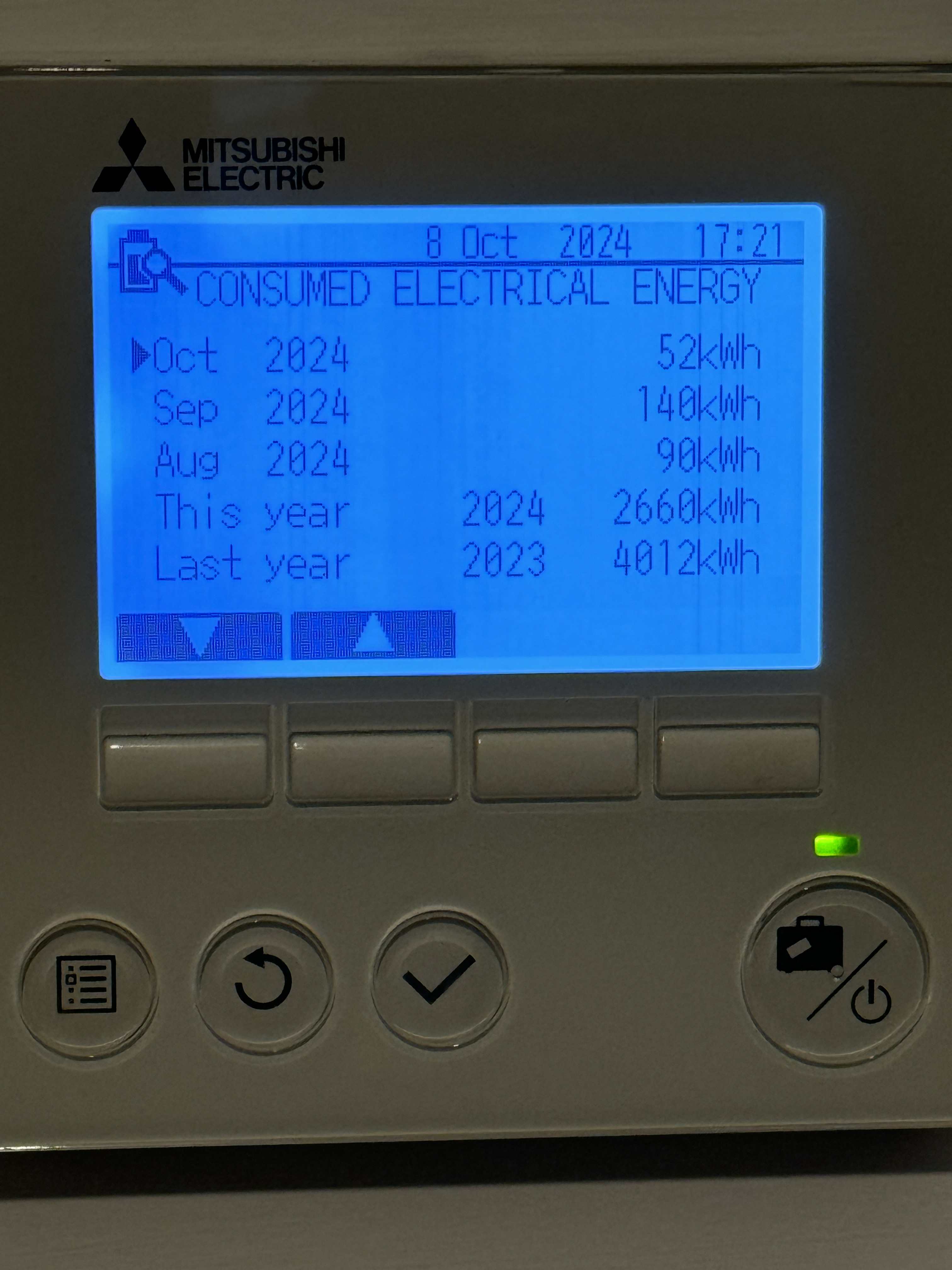

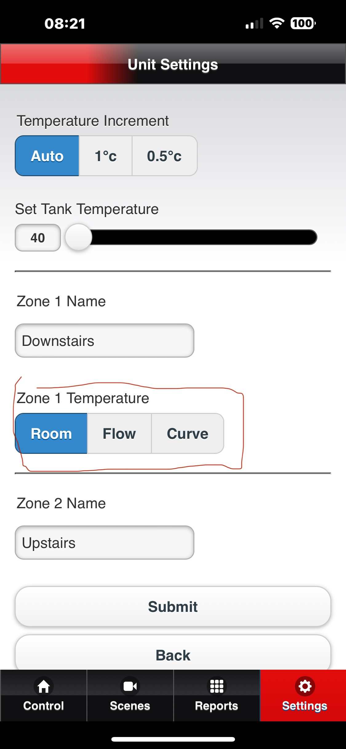

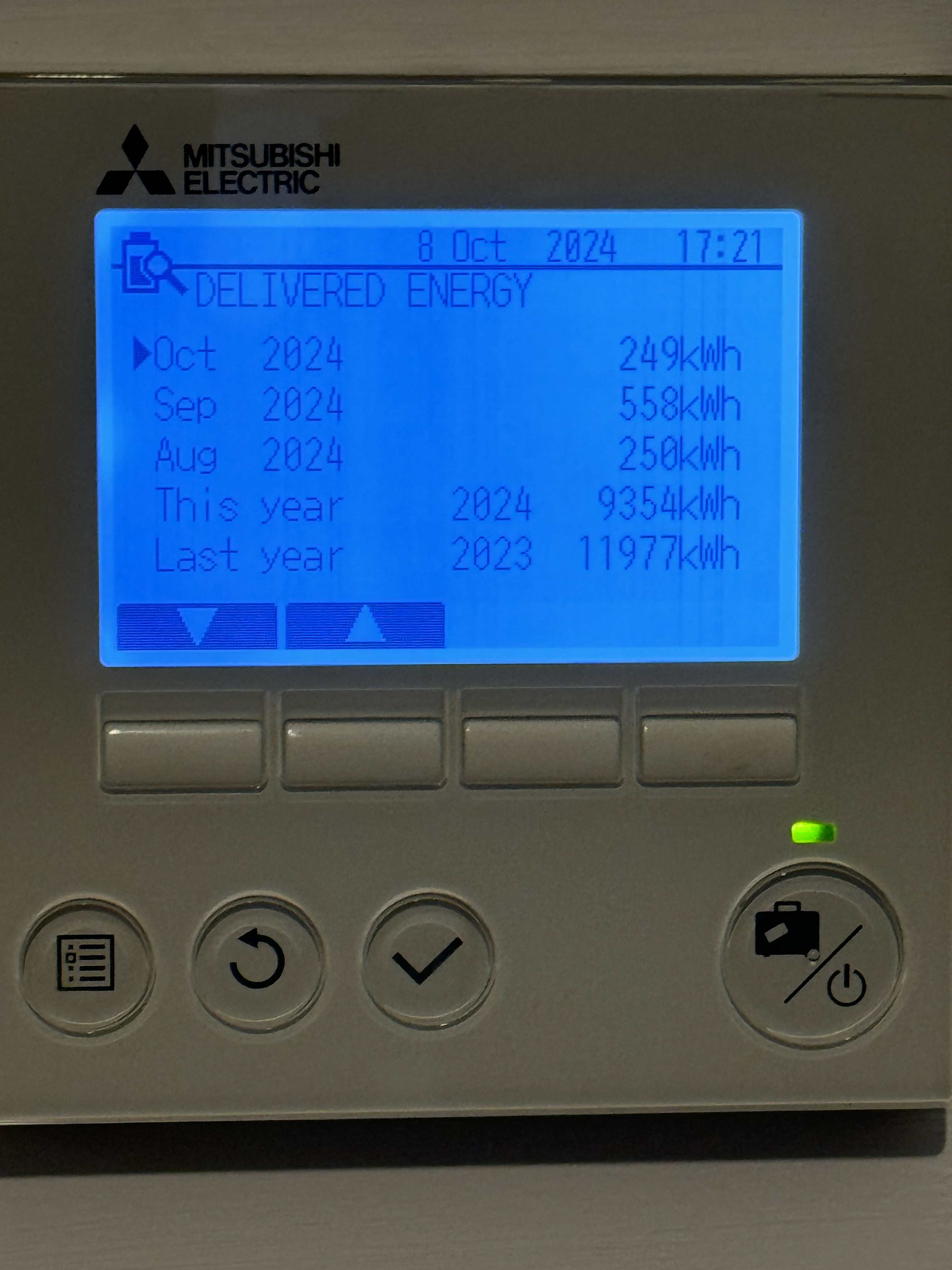

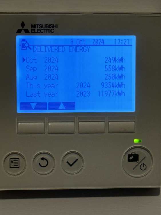

Gorslad Posted October 8, 2024 Share Posted October 8, 2024 How man kw should I be using per day? 4 bedroom detached house with Ecodan with radiators, 2 adults only I have set the water to 40 degrees via the MELCloud I looked at Gary’s helpful video of the compensation curve which mine is not set, here are 2 images that I have just taken a photo of Link to comment Share on other sites More sharing options...
JohnMo Posted October 8, 2024 Share Posted October 8, 2024 21 minutes ago, Gorslad said: How man kw should I be using per day? How many kWh you should use per day, has many variables. Insulation levels, house temp, outside temperature. Plus exactly how you operate the system Some givens A fixed flow temp will increase your consumption on all days except the coldest days. Stop starting the heating will generally not help. A buffer of small capacity will not help Mixer valves will not help Small cylinder coils will not help. Link to comment Share on other sites More sharing options...
PNAmble Posted October 8, 2024 Share Posted October 8, 2024 The Ecodan numbers on the controller on my system seem to have no resemblance to reality. It’s currently saying in October I’ve used energy heating as well as water and my heating hasn’t come on. There are lots of posts about the ‘estimation’ used by Ecodan. I’ve now put a Shelly PM on the supply and am measuring that. I’ll do a comparison when it’s run for a while. I can then make ‘educated’ calcguesses on the real COP for HW and Heating (when it comes on). Link to comment Share on other sites More sharing options...
Gorslad Posted October 8, 2024 Share Posted October 8, 2024 15 degrees roughly, well insulated house, I can’t even put the heating on upstairs even in the winter as it’s so hot last week I used 25kw per day i was just wondering what other people consumed I know there are a lot of factors do you recommend I put it on flow like in Gary’s video? I think he used 32 degrees and -3 in is settings Link to comment Share on other sites More sharing options...
PhilT Posted October 9, 2024 Share Posted October 9, 2024 12 hours ago, Gorslad said: 15 degrees roughly, well insulated house, I can’t even put the heating on upstairs even in the winter as it’s so hot last week I used 25kw per day i was just wondering what other people consumed I know there are a lot of factors do you recommend I put it on flow like in Gary’s video? I think he used 32 degrees and -3 in is settings If you have the Mitsubishi Ecodan Wireless Remote Controller then the most efficient way to run your heat pump is in "Room Temperature (Auto Adaptive)" mode. I have been doing that for over a year now. Best thing is, you don't have to fiddle about with settings, just let it do it's thing, knowing that it will run at peak efficiency all the time. It uses the WC curve in the background so initially you have to set that to something sensible. Link to comment Share on other sites More sharing options...
PNAmble Posted October 9, 2024 Share Posted October 9, 2024 9 minutes ago, PhilT said: If you have the Mitsubishi Ecodan Wireless Remote Controller then the most efficient way to run your heat pump is in "Room Temperature (Auto Adaptive)" mode That’s what we have (although heating not kicked in yet), and also timed tHW overnight. The outdoor temp thermostat is quite well shielded on ours so we don’t get extremes of temp changes. Link to comment Share on other sites More sharing options...
Gorslad Posted October 9, 2024 Share Posted October 9, 2024 Is this what you main in the app? Link to comment Share on other sites More sharing options...
PhilT Posted October 9, 2024 Share Posted October 9, 2024 15 minutes ago, Gorslad said: Is this what you main in the app? The Zone 1 setting, yes that's it Link to comment Share on other sites More sharing options...

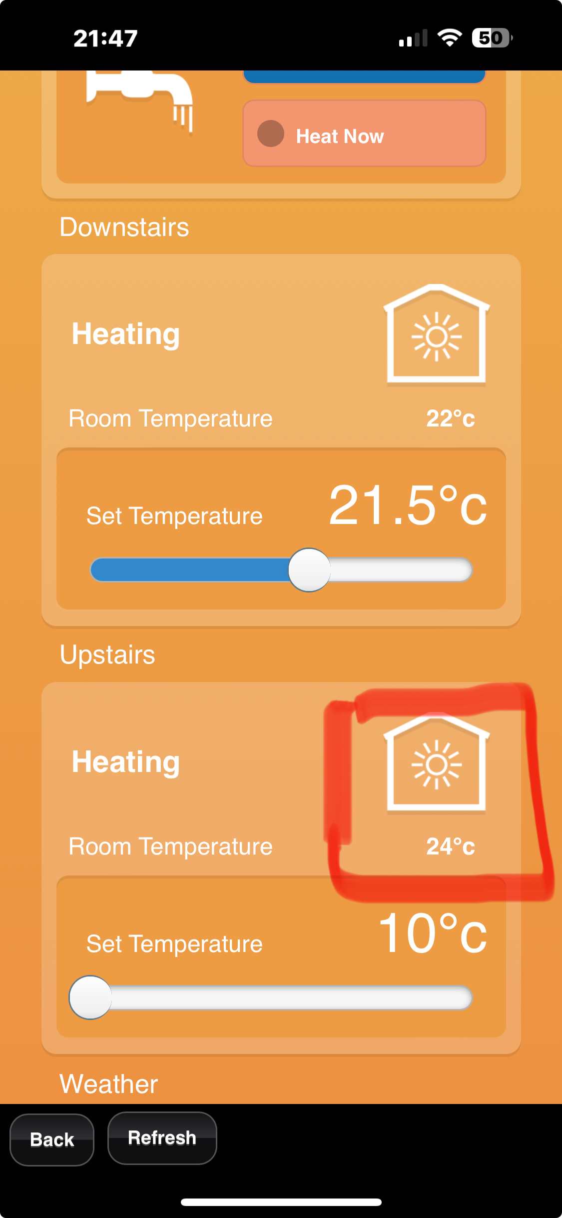

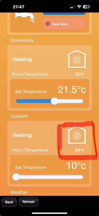

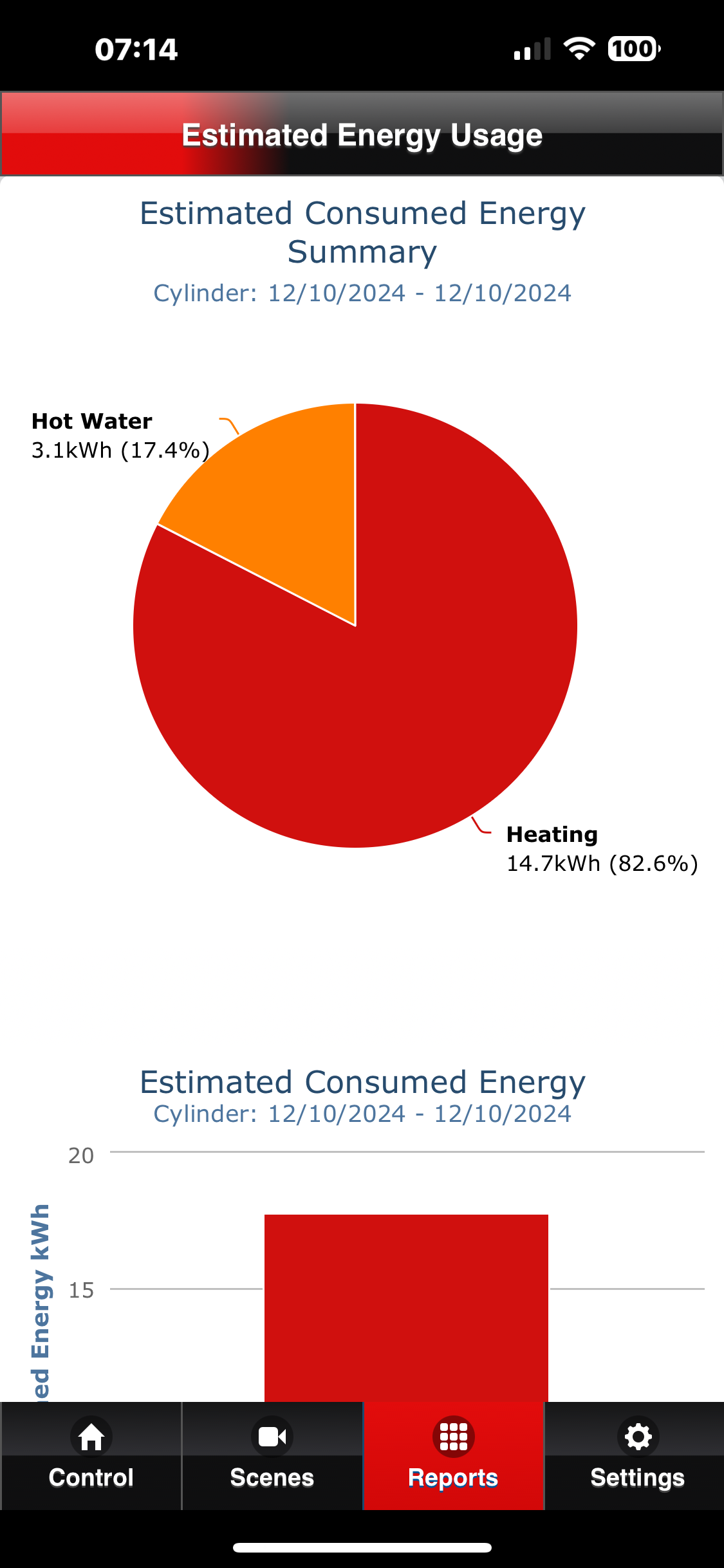

Gorslad Posted October 12, 2024 Share Posted October 12, 2024 (edited) I am trying the weather compensation out for a few days, I’m a bit confused though as on the app I have upstairs z2 at 10 degrees but it’s currently at 24 degrees we have a new build house and we don’t need heating upstairs as it is usually hot anyway without it Edited October 12, 2024 by Gorslad Link to comment Share on other sites More sharing options...
PhilT Posted October 13, 2024 Share Posted October 13, 2024 10 hours ago, Gorslad said: I am trying the weather compensation out for a few days Why not just leave it on "Room", it already uses Weather Compensation, only much more intelligently, so no need for any more fiddling about. Are your upstairs radiators actually on? If so there is something wrong with your setup. Link to comment Share on other sites More sharing options...
Gorslad Posted October 13, 2024 Share Posted October 13, 2024 8 minutes ago, PhilT said: Why not just leave it on "Room", it already uses Weather Compensation, only much more intelligently, so no need for any more fiddling about. Are your upstairs radiators actually on? If so there is something wrong with your setup. I was just trying out different methods just to satisfy myself I used 14kw yesterday and 13kw when it was on room I see heat geek and other videos saying to use weather compensation you have to dig deep when it comes Ecodan settings Link to comment Share on other sites More sharing options...
