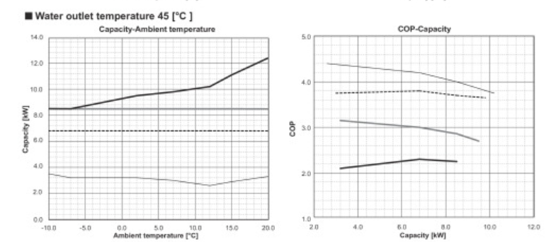

Garald Posted February 2, 2024 Posted February 2, 2024 As many of you know too well, I had a Mitsubishi Ecodan heat pump installed as part of a broader renovation. While it has adaptive heating, I've just set its operating system at 45 C (which is the temperature I did the calculations for). There was a bit of a cold wave at the beginning of January (I'm in the Paris area - maybe you felt it too), so the heat pump has been hard at work. Here's the data I just read off the heat pump: energy consumed energy produced December 583 kWh 2122 kWh January 883 kWh 2698 kWh In other words, the average COP for December and January was 3.64 and 3.06, respectively. Needless to say, this is somewhat disappointing; the statistics are what I would expect for a working temperature of 55 C, not 45 C. How do I keep closer tabs on how much energy the heat pump is using every day?

Gary68 Posted February 2, 2024 Posted February 2, 2024 You haven't stated what size Ecodan unit you have but your COP's look pretty spot on to me at 45C. The 2nd bottom line on the plot on the right is COP at 45C when its 2C outside which is probably about right for Jan on average, so you should get a COP of 3 at 45C which is exactly what you are getting. 1
Garald Posted February 2, 2024 Author Posted February 2, 2024 25 minutes ago, Gary68 said: You haven't stated what size Ecodan unit you have but your COP's look pretty spot on to me at 45C. It's an Ecodan Split Zubadan Silence 12kW (1PH R32; not sure what "1PH" means). It advertises: - a COP of 4.85 at 35C operating temperature (whereas the leftmost bit of the top line in the above graph is at 4.4). - a SCOP (a weighted seasonal average, but what are the weights?) of 4.61 at 35C and 3.51 at 55C. Where did you get those beautiful graphs - and what temperature does each line correspond to?

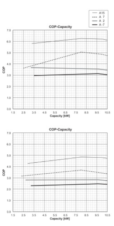

joth Posted February 2, 2024 Posted February 2, 2024 11 minutes ago, Garald said: It's an Ecodan Split Zubadan Silence 12kW (1PH R32; not sure what "1PH" means). It advertises: - a COP of 4.85 at 35C operating temperature (whereas the leftmost bit of the top line in the above graph is at 4.4). - a SCOP (a weighted seasonal average, but what are the weights?) of 4.61 at 35C and 3.51 at 55C. Where did you get those beautiful graphs - and what temperature does each line correspond to? Look for the ecodan data book, perhaps here https://www.mitsubishi-les.info/database/servicemanual/files/201803_ATW_DATABOOK.pdf Page 100 onwards, you need the exact model number. 1PH means single phase (not 3 phase) The best case COP is at air temp 15° so irrelevant this time of year. 1
Gary68 Posted February 2, 2024 Posted February 2, 2024 The plots are from the Mitsubishi web library, they are for an 8.5kw unit so not the same as yours and they are the COPs at an operating temps of 45C (not 35C) which is what you said you were running your unit at. The lines are at ambient temps of 15, 7, 2 and -7C The COP's are only a guide you can't take them at face value they are at laboratory test conditions but you should get in the same ball park which you are. These are the charts for the 12KW unit the first is at 35C the 2nd 45C so at 2C the 2nd bottom line you should be getting between 3-3.5 depending on whether you are running at 35 or 45C which is what you are getting 1

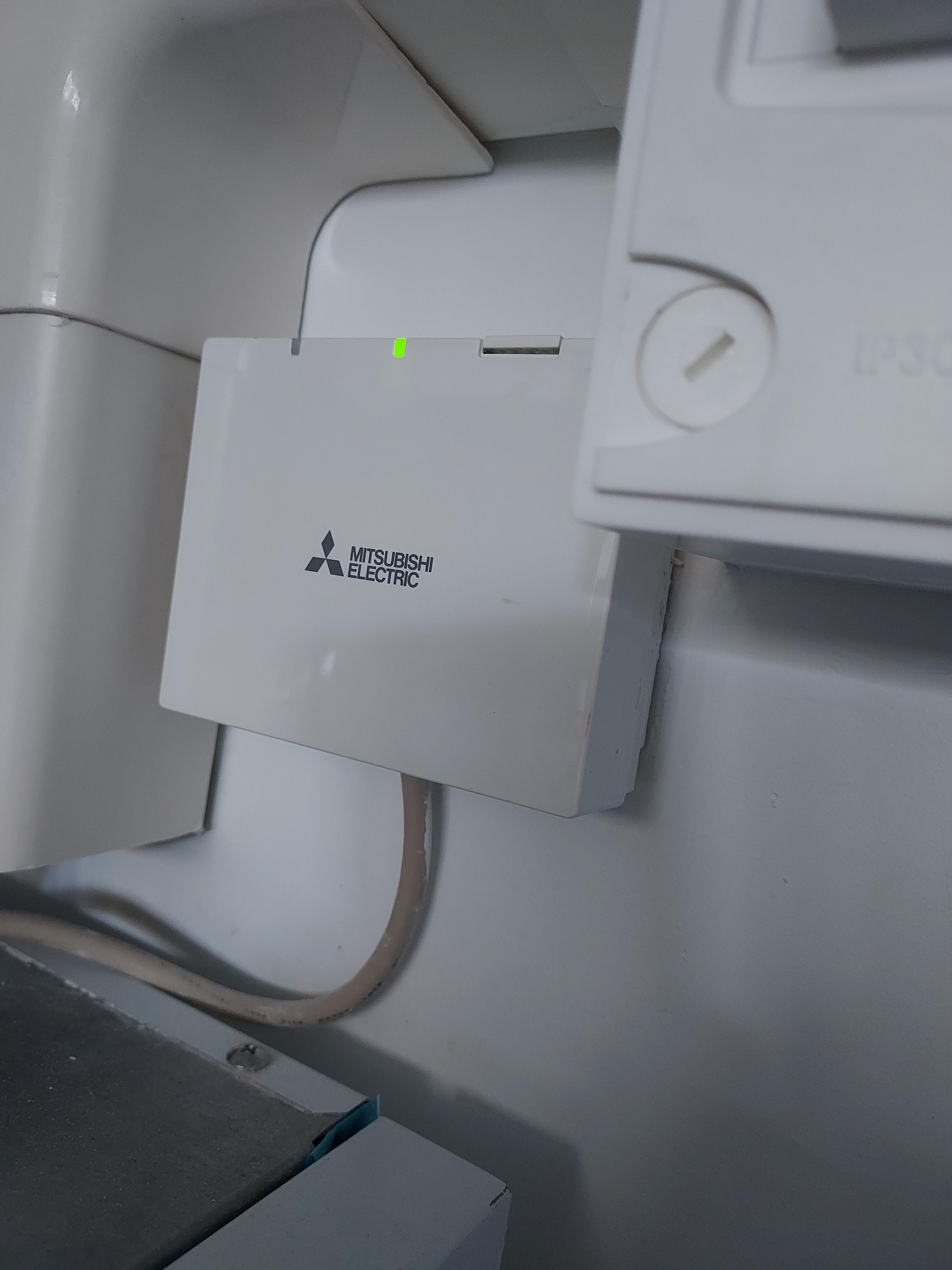

PhilT Posted February 2, 2024 Posted February 2, 2024 6 minutes ago, Garald said: Ah, interesting. I just noticed yesterday that the heat pump does seem to offer me something that looks like an auto-adaptive mode. I have no idea of whether a Wifi adapter is already installed (the bill lists an "Option wifi, compatible avec les solutions domotiques" - I'll have to ask whether that means the controller is already there or whether it just means it's something I can have installed), but I do have a little thermostat/controller that I can move around (it currently sits in my library/main room, which is also the warmest room). Would that be enough? And what are you using to check that flow temperatures rarely go above 40 deg C? I calculated radiator size with a good margin of safety, so "rarely going above 40degC even at -5degC outside" sounds like a realistic goal for me (congratulations for achieving it). It's this thing https://les.mitsubishielectric.co.uk/products/residential-heating/control/wireless-controller-and-receiver To check flow temps and lots of other stuff I use the Melcloud app - both phone and PC version
Garald Posted February 2, 2024 Author Posted February 2, 2024 5 minutes ago, PhilT said: It's this thing https://les.mitsubishielectric.co.uk/products/residential-heating/control/wireless-controller-and-receiver To check flow temps and lots of other stuff I use the Melcloud app - both phone and PC version Ah yes, I have that. Does that mean I can also use the Melcloud app?
Gary68 Posted February 2, 2024 Posted February 2, 2024 Yes it does but it won't show you COP it will show you the flow temperatures you are running though hour by hour for the past 24 hours. Is there a reason you are running at 45C constantly, you need to turn on auto adapt and set your weather compensation curve up to get the best COP at milder temperatures.

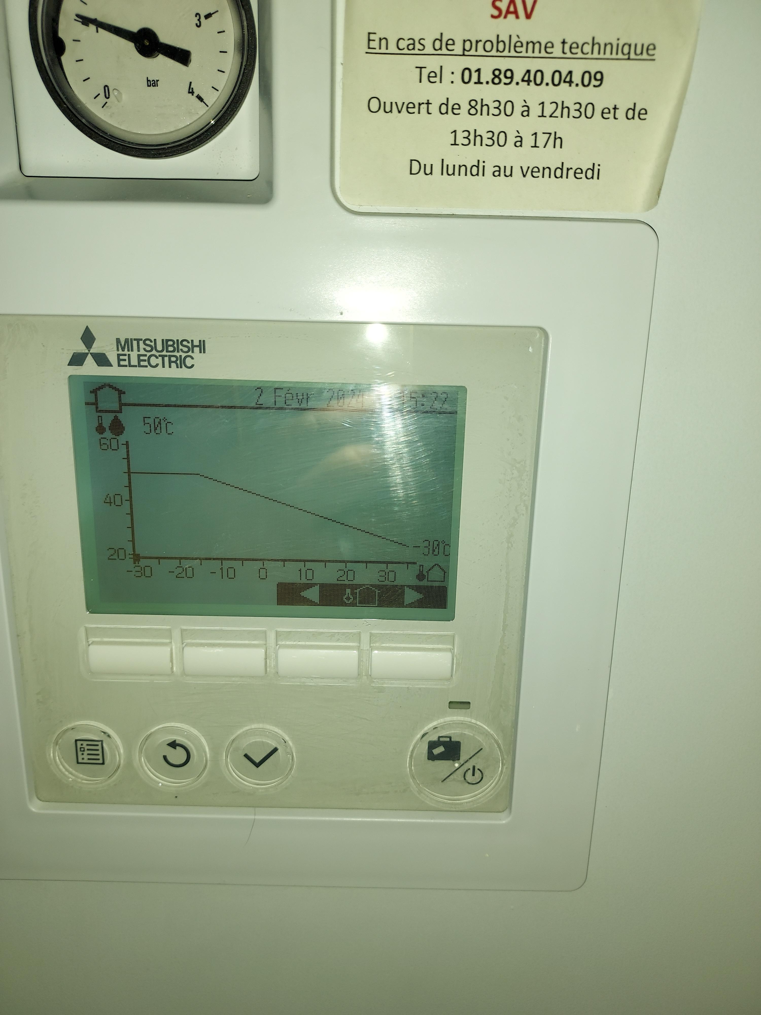

Gary68 Posted February 2, 2024 Posted February 2, 2024 If you can see the thermometers and water drop next to the flow temp on your controller screen then you are running at a fixed flow temp, yours should look like this we 45C if you are running at a fixed flow of 45C If you can see a graph curve next to the +/-0C then you are running in weather compensation If you can see a house with a thermometer in it next to what is the set room temp then that is auto adapt mode.

Garald Posted February 2, 2024 Author Posted February 2, 2024 11 minutes ago, Gary68 said: If you can see the thermometers and water drop next to the flow temp on your controller screen then you are running at a fixed flow temp, yours should look like this we 45C if you are running at a fixed flow of 45C If you can see a graph curve next to the +/-0C then you are running in weather compensation If you can see a house with a thermometer in it next to what is the set room temp then that is auto adapt mode. Right, exactly. I am in fixed flow temp mode (at 45 C), I intended to be in weather compensation form (but never figured out how to set up the curve properly, or perhaps the heat pump didn't like my dragging one end all the way down to -30C), and I'll just switch to auto adapt mode, stop worrying and save money.
Gary68 Posted February 2, 2024 Posted February 2, 2024 Auto adapt uses your weather comp curve so it needs to be setup for your house, if 45C worked for you when it was coldest you have one end of the curve you just need to set the other end and see how it goes
Garald Posted February 2, 2024 Author Posted February 2, 2024 13 minutes ago, Gary68 said: Auto adapt uses your weather comp curve so it needs to be setup for your house, if 45C worked for you when it was coldest you have one end of the curve you just need to set the other end and see how it goes The problem is that for some mysterious reason the heat pump display doesn't allow me to have full control of the curve: Also, I've been able to locate the adapter (see pic below) that enables me to use the remote-control thermostat, but I don't see any information on it that would enable me to connect the heat-pump to the Internet and in particular to MELCloud. Do I need a different adapter? Or is the connectivity information hidden somewhere?

PhilT Posted February 2, 2024 Posted February 2, 2024 You are in "read only" mode. If you want to change any settings, from the FTC6 main home screen you need to press and hold the bottom left button for a few seconds. After that the domestic hot water settings window on the left in your last photo above will also show an edit symbol next to the two arrows in a circle. You should then also be able to change your WC settings. There are several YouTube videos on how to do this
