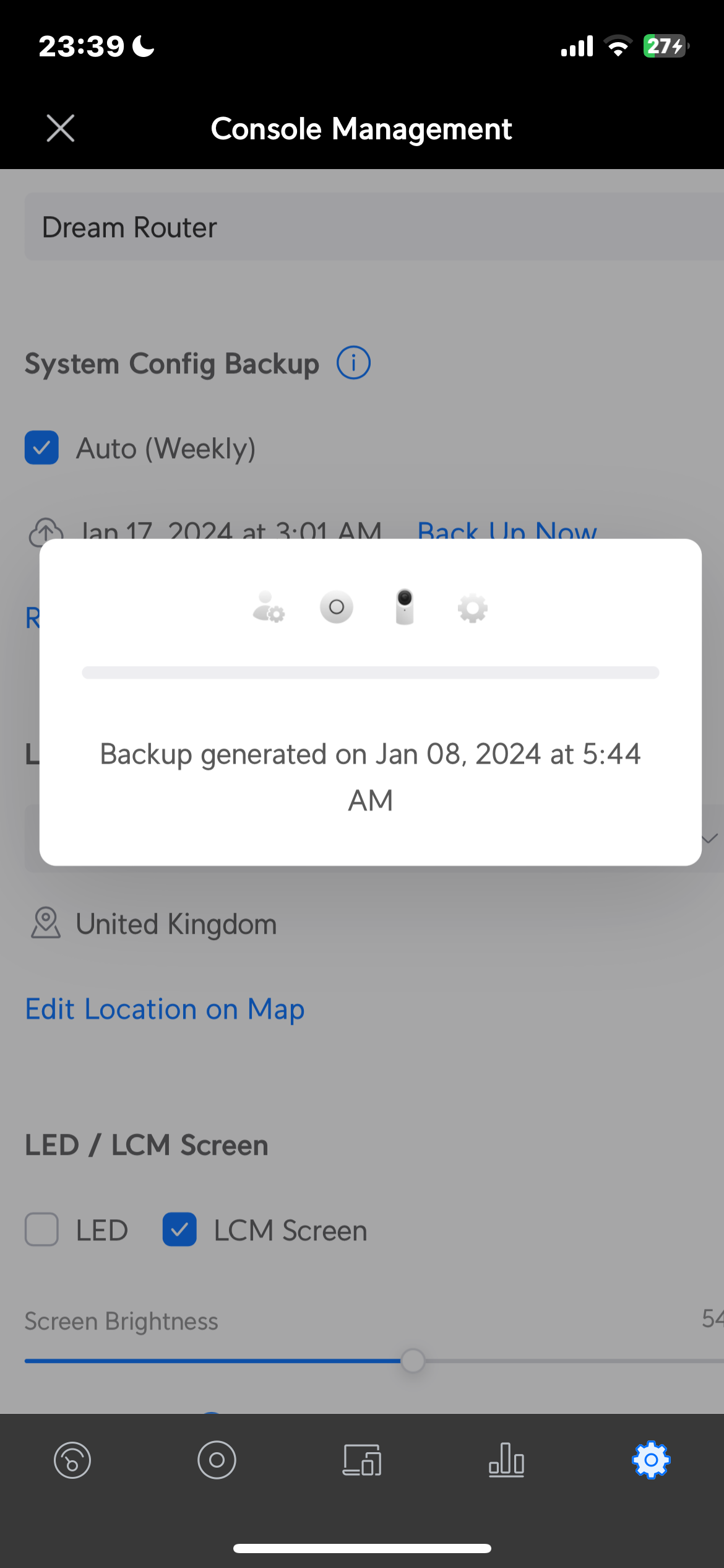

Adsibob Posted January 24 Author Share Posted January 24 6 hours ago, Thorfun said: I don’t really use the app much. Much more functionality connecting with a web browser Okay, I will try and connect from a web browser, because doing it through the app late last night was a somewhat confusing experience. I got this, which I thought was positive: I thought this was saying that it was loading the backup from 8 Jan, in that I don’t see logically how I can create a backup with that date two weeks later. But after it finished doing this, the version was still showing 3.2.9. Link to comment Share on other sites More sharing options...

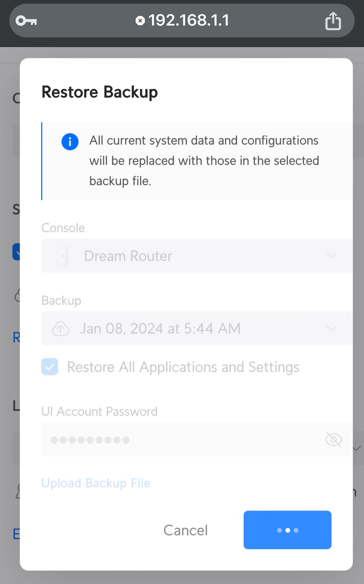

Adsibob Posted January 24 Author Share Posted January 24 (edited) 4 hours ago, Thorfun said: log in to your Ubiquiti account. i navigate to 192.168.1.1 (the IP of my DMPro) from my internal network (whether wifi or cable shouldn't make a difference as you're on your internal LAN) and log in to the web page that shows. Ok, I’ve done that and it appears to be doing something good: I will report back once I know if it’s worked. Thank you @Thorfun Edited January 24 by Adsibob 1 Link to comment Share on other sites More sharing options...
Thorfun Posted January 24 Share Posted January 24 (edited) 1 hour ago, Adsibob said: Ok, I’ve done that and it appears to be doing something good: I will report back once I know if it’s worked. Thank you @Thorfun although that says system data and configurations, not firmware. so I'm not sure that the restore from backup will revert the firmware update. seems to be lots of posts on UDMPro rollbacks but not UDR. https://www.google.com/search?client=safari&rls=en&q=ubiquiti+dream+router+firmware+rollback&ie=UTF-8&oe=UTF-8#ip=1 Edited January 24 by Thorfun typo Link to comment Share on other sites More sharing options...

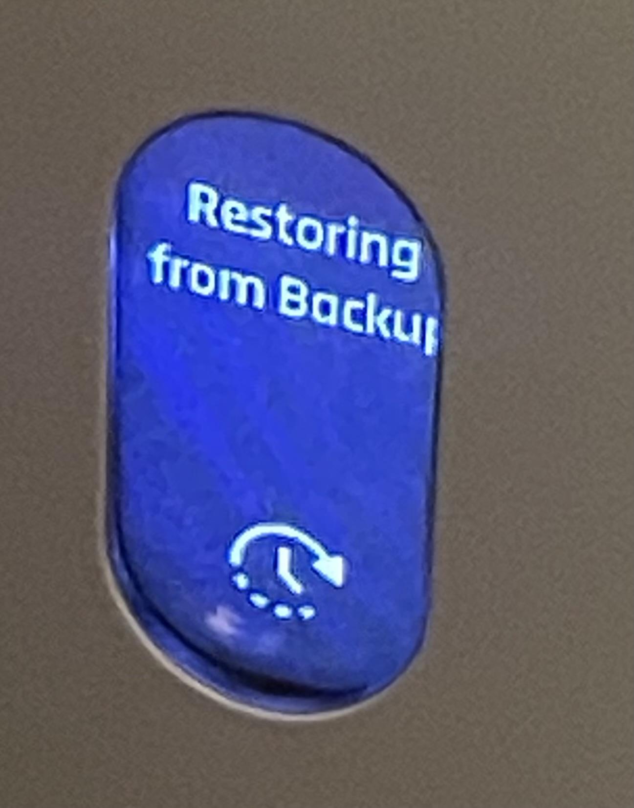

Adsibob Posted January 24 Author Share Posted January 24 1 hour ago, Thorfun said: although that says system data and configurations, not firmware. so I'm not sure that the restore from backup will revert the firmware update. Hmmm, I fear you might be right. This is what the UDR screen was displaying after I restored the system data and configurations: but logging in now, it is still showing 3.2.9. Very annoying. Link to comment Share on other sites More sharing options...
