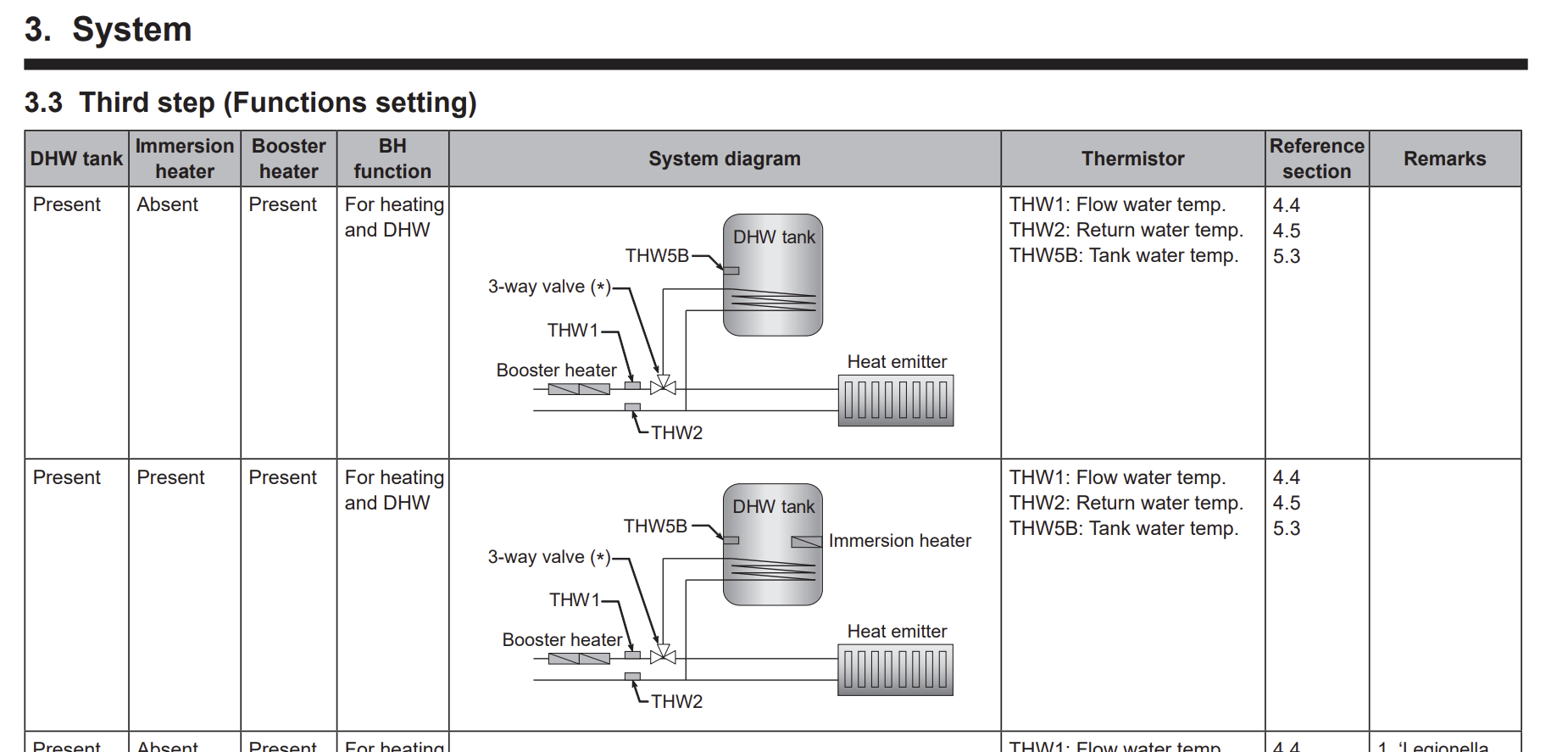

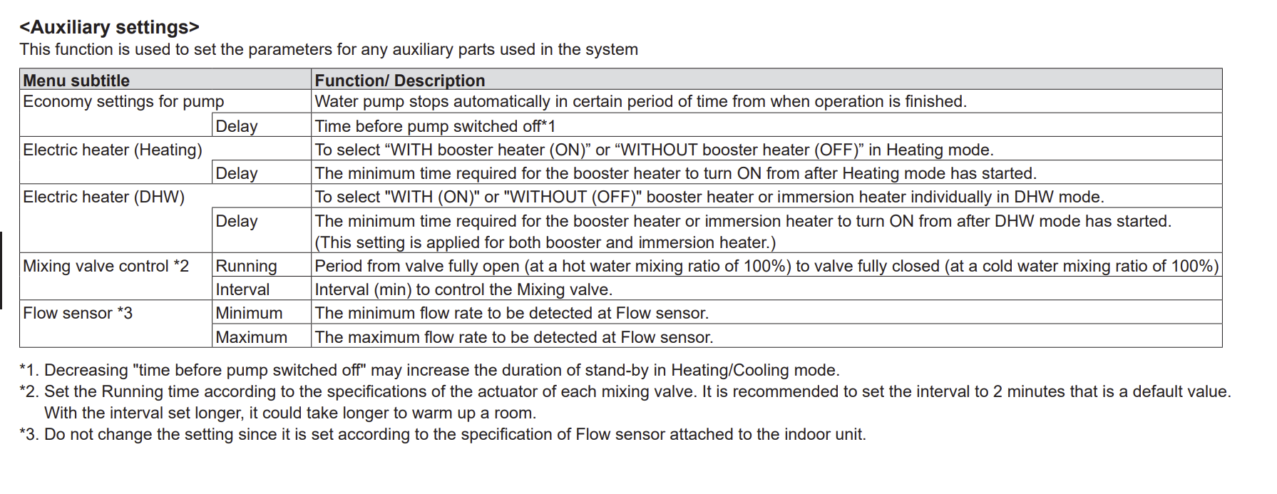

joth Posted January 22 Share Posted January 22 First thing is to confirm what your DHW Tank temperature target it set to. If this is >50 it maybe the ASHP struggles to achieve it so switches to immersion. It's helpful to confirm if you have an immersion heater (in the UVC), a booser heater (in line in the primary pipework), or both? See diagrams below. If it's a Booster heater, is maybe coming on because it's struggling to reach heating target temperature. Also check these Auxilliary settings - the DHW Delay can be used to delay the Booster/immersion coming on, to give the ASHP a longer run time to reach target. You need to ensure the DHW max runtime is high enough for it to run that long Also there's a setting Link to comment Share on other sites More sharing options...

NightMail Posted January 22 Author Share Posted January 22 Many thanks to you all for your responses. The company that installed the heat pump is to pay us a visit, as the system is still within warranty, so I should have a better idea of the situation in a few days time. With regard to your various queries: Kelvin & PhilT: When the installer calls I will ask if the heat pump software should be updated to the latest version. joth: The DHW temperature is set to 50 degrees C. It seems to me that the heat pump does not have an inline booster heater, only an immersion heater. There is an external switch labelled "immersion" which may be the simple way that it is controlled. I will ask the installer if it can be switched off. Best regards & thanks again for the responses. Link to comment Share on other sites More sharing options...

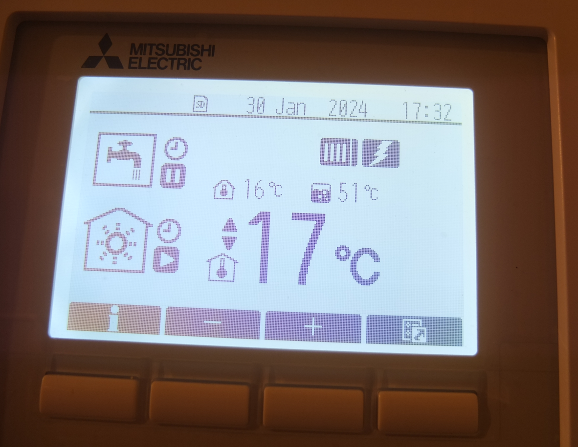

NightMail Posted February 1 Author Share Posted February 1 Thanks for your responses and my apologies for not replying before now. Since the weather became somewhat milder I have noticed that the immersion heater was in use only once, on Tuesday last, for space heating, while the DHW was at the required temperature, water heating was in standby and the outside temperature was approximately 5 degrees C, see attached photo. The ex "mid 90's double glazing" salesperson is to call tomorrow so hopefully a resolution will be found! Best regards. Link to comment Share on other sites More sharing options...
PhilT Posted February 2 Share Posted February 2 There was another thread on this recently. I have an FTC6 controller and my understanding is that the lightning bolt symbol denotes that the hot water immersion heater is on. Is there some kind of heating circuit immersion heater - where is it - can you see it installed in the heating circuit somewhere? Link to comment Share on other sites More sharing options...
NightMail Posted February 2 Author Share Posted February 2 As predicted the immersion coming on had nothing to do with a lack of gas, a point also made by the service man when he arrived. As far as I understand the situation there were two settings that contributed to the immersion being turned on. Firstly, the ambient temperature setting was set to 5 degrees C and secondly, the length of time that was allowed for a temperature increase in the flow and return pipes was set at 30 minutes. The former setting was reduced to 3 degrees C and the latter increased to 60 minutes. Another period of sub-zero temperatures is forecast to start on Sunday February 11, which should test the above explanations. Link to comment Share on other sites More sharing options...
