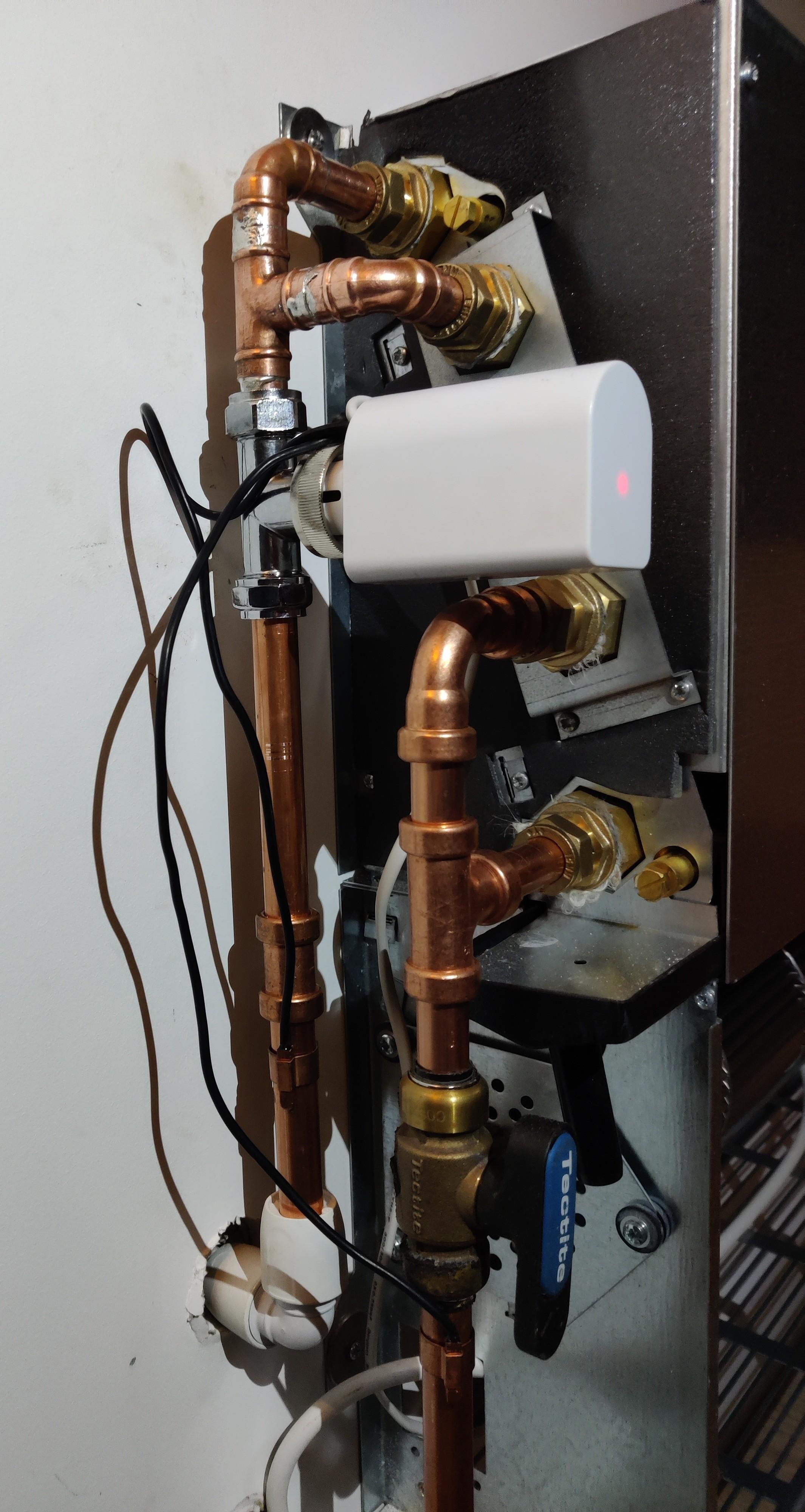

The unit I got is a 4 pipe fan coil. This unit has a dedicated cooling and seperate heating heat exchangers.  The heat transfer area of the combined heating and cooling HE's is about 50% larger than a 2 pipe fan coil. Have piped the two HE's as a single unit. I am using a Salus self balancing actuator to balance the flow rate through the fan coil.

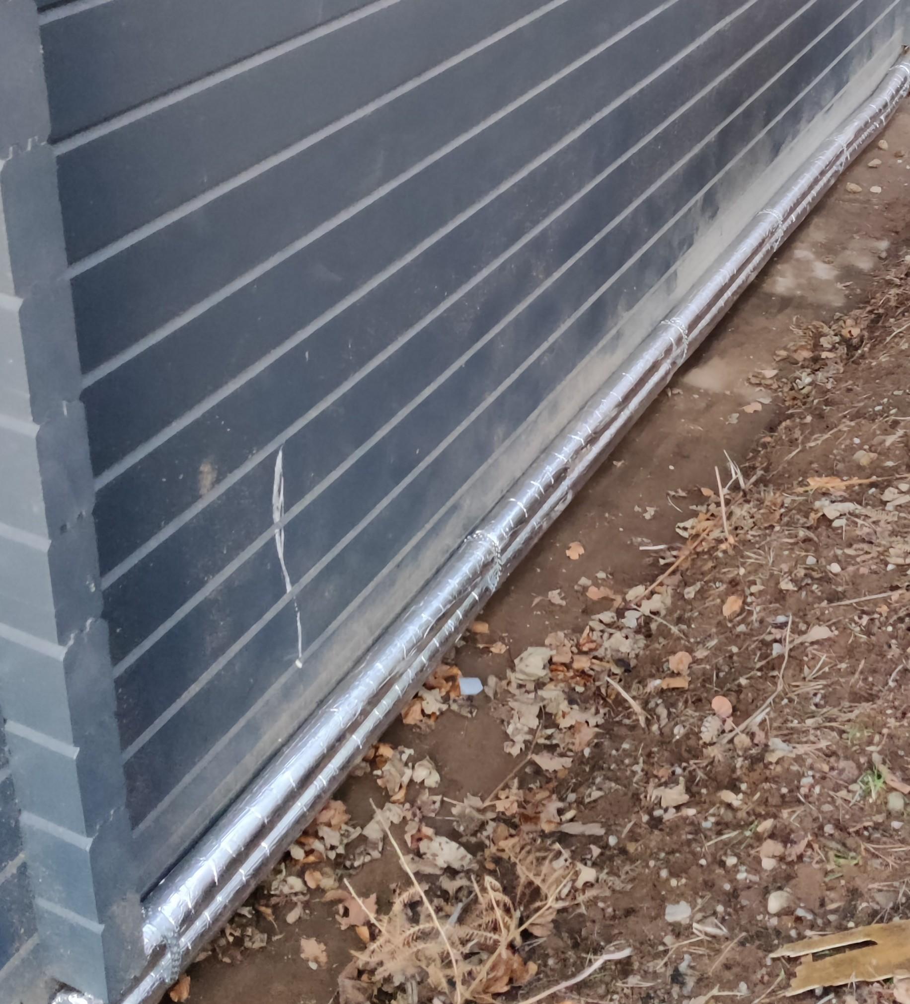

Have started the external piping using 15mm Hep2O and 25mm wall thickness insulation. The insulation to aluminium tape covered to keep mice away and UV to stop sun damage. The pipes sit on metal brackets 40mm off the ground and are galvanised banded into place.
Progress today, piping all completed and system cleared of air. Unit running.

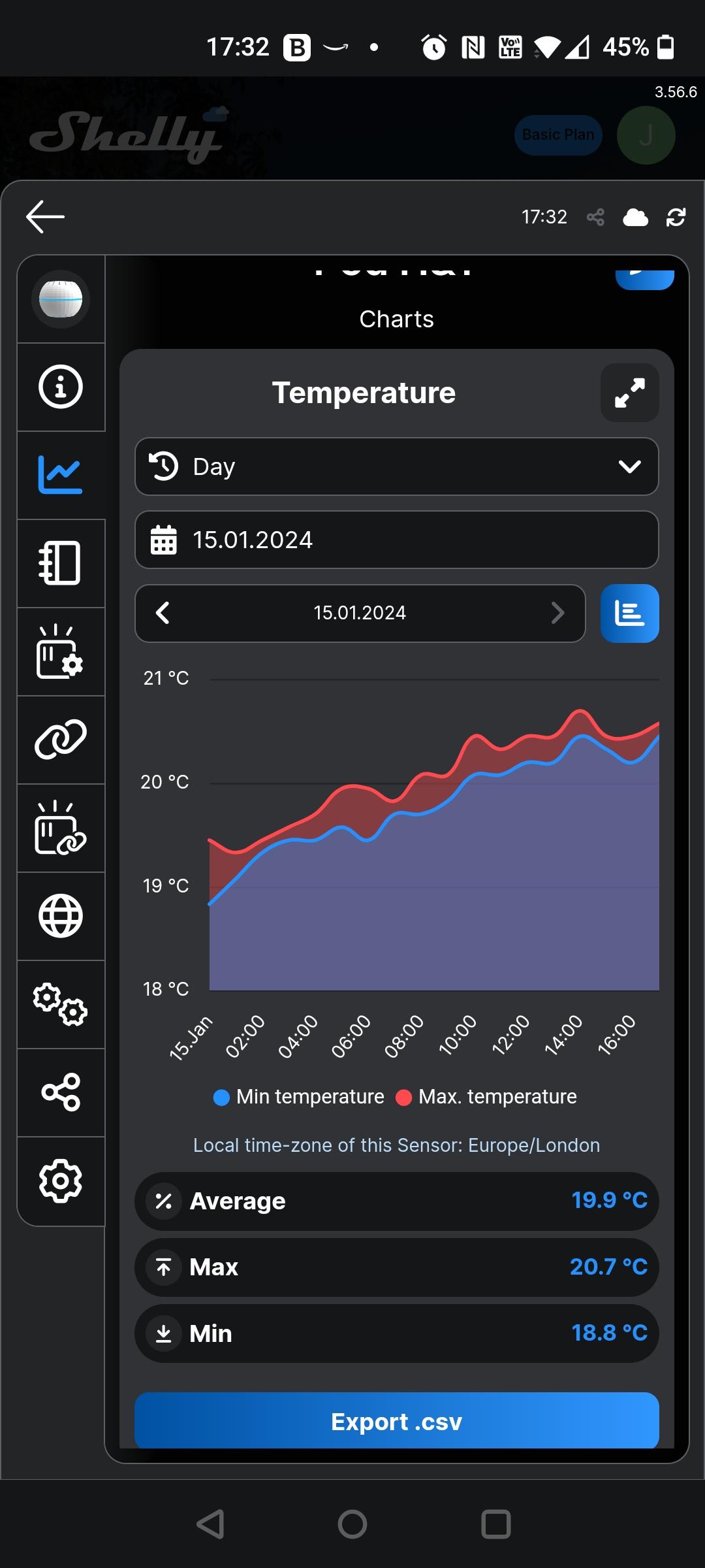

Tried the unit overnight with fan set in manual mode at a constant min speed overnight. Heat pump ran over the full period except a few defrosts (-2 overnight). This morning the summer house had settled to 20.1 degs. Will monitor it over today.

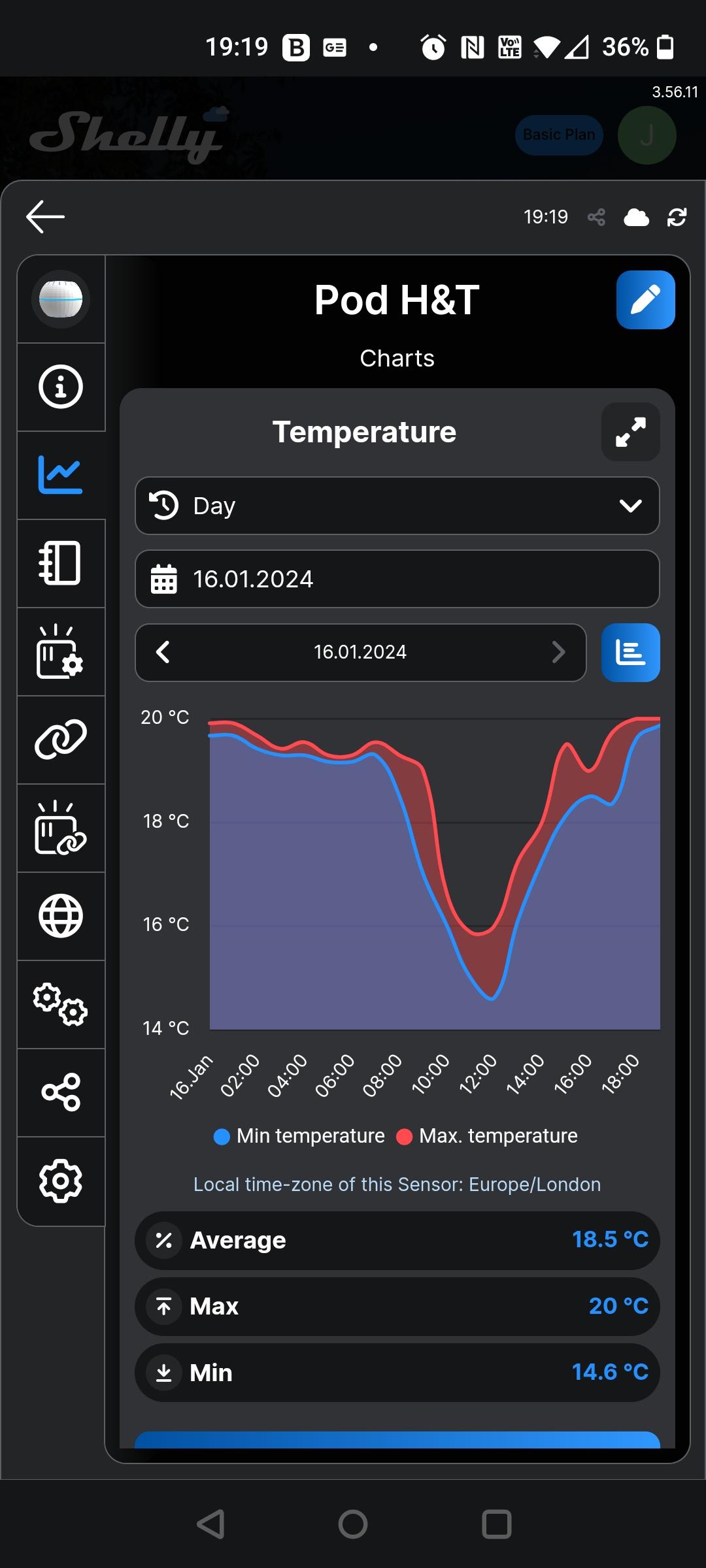

I have set my fan to manual min speed, the heat pump isn't being asked to do much, as the mixer is set to 28 deg flow to UFH.  Currently heat pump is kicking out about 36 degs. It's been cycling on off today. The room temp is very stable, water temp is varying from 36 down to about 27.
This is the plot from my H&T sensor to can see where the heat pump flow temp dips with the peaks and troughs. I may have to tweek the WC curve a little.
The Salus actuator is on the return piping side and "hand on" pipes, there is a difference in temperature so it's doing something. Used on a radiator straight trv from Screwfix, item 48346 - Straight TRV about £15, which gives a positive shut off for maintenance also. Have powered it on all the time to the main incoming power.
No noise from the valve
Tried the fan coil on auto mode again today, and just cooled the room down.
Reverted to manual fan operation and room temp settled to where I wanted it (after a few hours).
The reason could be the Salus auto balancing actuator, auto mode switches the fan to different speeds and to off, so maybe dT is just changing too quickly for the actuator to keep up as it will have been tuned for UFH, not a coil containing a litre of water.
So manual mode with WC is probably the way to go. It keeps it simple.

Have just removed the Salus actuator, as I was getting random drops in room temperature for no apparent reason. Checked system for air and nothing found.
Last night the heat pump ran continuously, fan speed on fan coil is at speed one, steady temperature outside. Over a period of a few hours this morning, room temp dropped a few degrees. Removed actuator and installed a manual decorating valve and now room temp is recovering.
