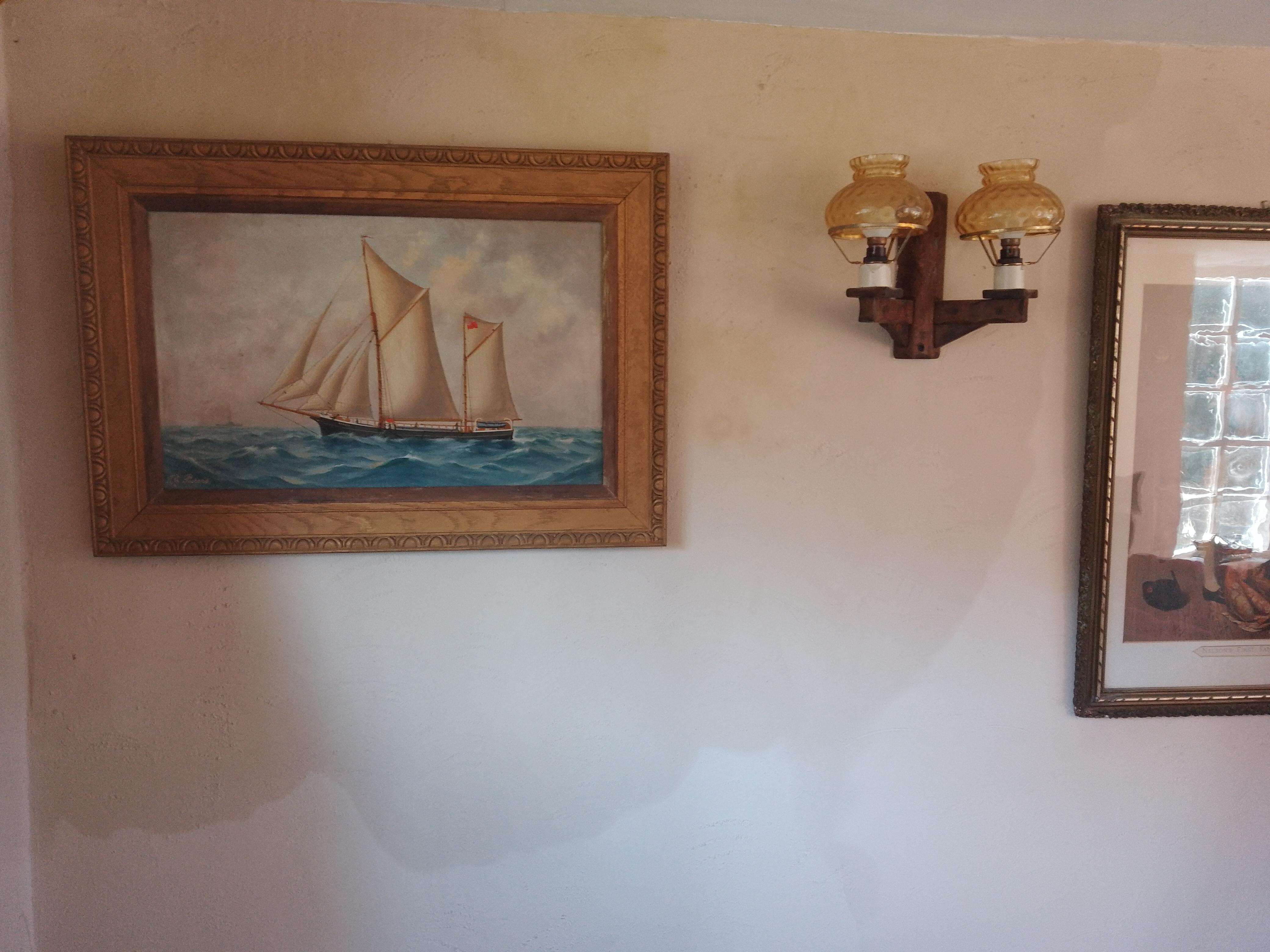

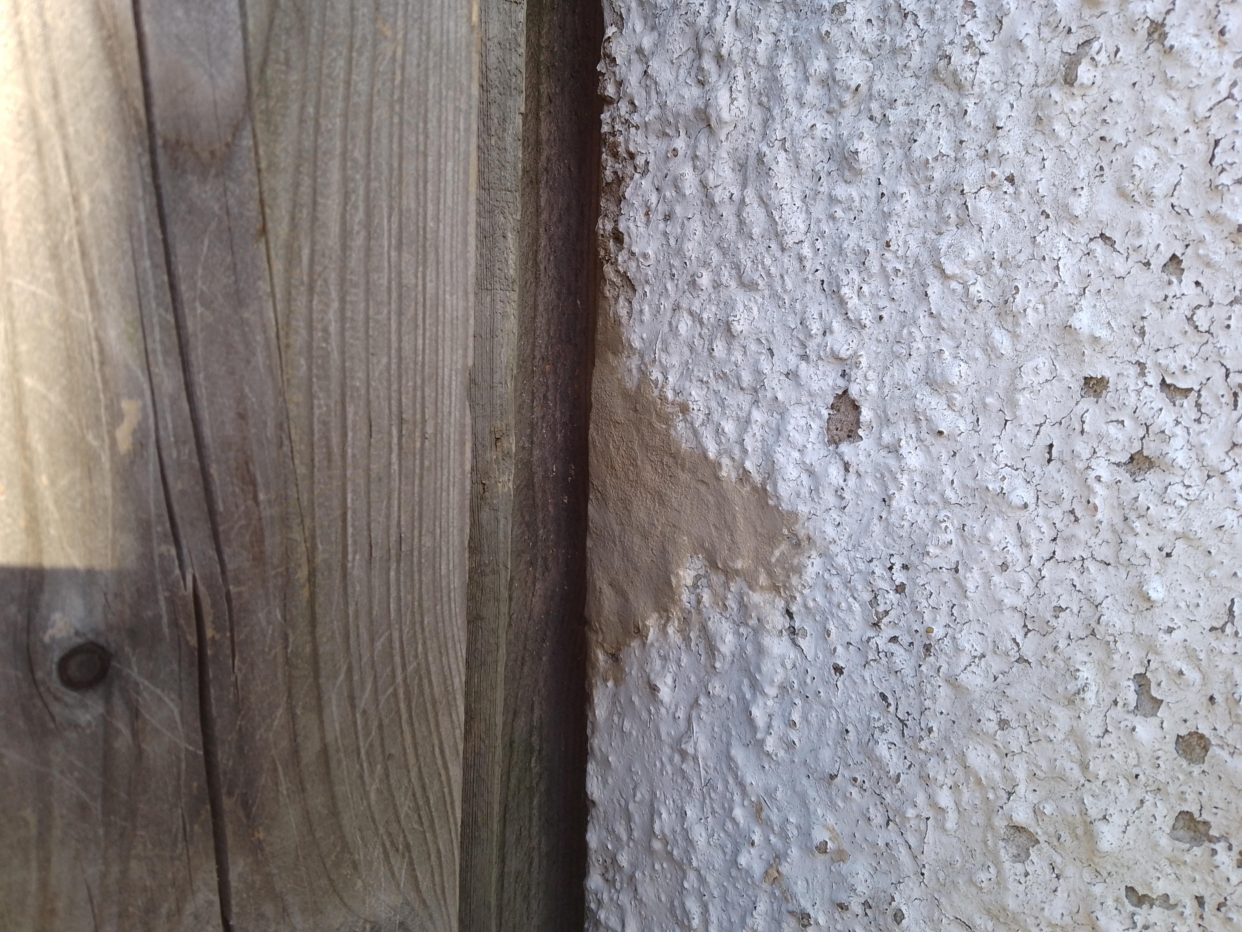

Dusty Posted January 11, 2024 Share Posted January 11, 2024 This has appeared over the last couple of months on a North facing gable internal wall. I have found a small area of damage to the cement render on the external wall so assume this is where the moisture is coming in from. The wall is solid brick with gypsum plaster internally. Should I repair the render now to prevent a further ingress of water or will that seal the existing moisture in? I am worried with all the rain we have been experiencing that if I don't do something soon the problem may get worse. Any advice would be much appreciated. Link to comment Share on other sites More sharing options...
TonyT Posted January 11, 2024 Share Posted January 11, 2024 Fill the crack to stop further water ingress. Run a fan or dehumidifier to help dry out the wall Link to comment Share on other sites More sharing options...
jayc89 Posted January 12, 2024 Share Posted January 12, 2024 11 hours ago, Dusty said: This has appeared over the last couple of months on a North facing gable internal wall. I have found a small area of damage to the cement render on the external wall so assume this is where the moisture is coming in from. The wall is solid brick with gypsum plaster internally. Should I repair the render now to prevent a further ingress of water or will that seal the existing moisture in? I am worried with all the rain we have been experiencing that if I don't do something soon the problem may get worse. Any advice would be much appreciated. Solid brick and impermeable materials on both sides of it. I'm afraid you're asking for trouble. Moisture's getting in and it has no where to go. At least one side of that wall has to be able to "breathe". Replace the external render, or the internal plaster, with a lime based alternative. Avoid NHLs, especially NHL5, as they typically cure harder than cement over time. Link to comment Share on other sites More sharing options...

Iceverge Posted January 16, 2024 Share Posted January 16, 2024 It sounds like an issue with the external render allowing bulk water through. Maybe some pictures would help us diagnose. Get it patched up. Be particularly observant about and cracks around windows and at the top of the wall. Link to comment Share on other sites More sharing options...

Dusty Posted January 16, 2024 Author Share Posted January 16, 2024 Damp patch on inside wall. Link to comment Share on other sites More sharing options...
TonyT Posted January 16, 2024 Share Posted January 16, 2024 What’s on the other side of the wall, any down pipes, gutters? Link to comment Share on other sites More sharing options...
Dusty Posted January 16, 2024 Author Share Posted January 16, 2024 1 hour ago, TonyT said: What’s on the other side of the wall, any down pipes, gutters? Nothing. I have since discovered some condensation on the 1st floor internal wall which might be part of the problem? Link to comment Share on other sites More sharing options...
Iceverge Posted January 19, 2024 Share Posted January 19, 2024 Do you have any pics of the outside? Link to comment Share on other sites More sharing options...
