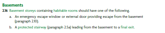

Nic Posted January 11, 2024 Share Posted January 11, 2024 Am I right that you can have a single staircase exit ( ie your internal stairs) in your basement design ? I take it you would need say a sprinkler systems Link to comment Share on other sites More sharing options...
saveasteading Posted January 11, 2024 Share Posted January 11, 2024 In a standard house I think a single stair is fine. Going up instead of coming down, so what's the difference? It might need to be fire protected....plasterboard under. Rules change acc to the number of storeys though. It's all in the building regulations but not especially easy to follow. I recommend ploughing through it, as I could easily be misremembering. 1 Link to comment Share on other sites More sharing options...
Alan Ambrose Posted January 11, 2024 Share Posted January 11, 2024 My understanding is that if you have habitable rooms down there you need an exterior stair also. 1 Link to comment Share on other sites More sharing options...
saveasteading Posted January 11, 2024 Share Posted January 11, 2024 Just from a quick search, so not definitive. Basically one stair is OK but needs to be a protected route. Maybe sprinklers come to the rescue as thd original point. If you cannot provide a secondary fire escape, the staircase will need to end up in a fire protected hallway with a door direct to outside. 1 Link to comment Share on other sites More sharing options...
Nic Posted January 11, 2024 Author Share Posted January 11, 2024 1 minute ago, saveasteading said: Just from a quick search, so not definitive. Basically one stair is OK but needs to be a protected route. Maybe sprinklers come to the rescue as thd original point. If you cannot provide a secondary fire escape, the staircase will need to end up in a fire protected hallway with a door direct to outside. thanks that’s great info but where did that come from building regs ? Link to comment Share on other sites More sharing options...
saveasteading Posted January 11, 2024 Share Posted January 11, 2024 Can't remember, some county council page. It will be in the regulations. I had a big meeting on the su jecr once, with 2 bcos vying for who was the tougher. My technique for complex things in thd regs is to photocopy the relevant clauses then highlight the crucial bits and arrows making a cogent summary....or emphasising inconsistency. 1 Link to comment Share on other sites More sharing options...
saveasteading Posted January 12, 2024 Share Posted January 12, 2024 It reminds me. The building regs used to be in a huge lever arch file. A couple of times i took this in to heavy meetings with a bco, and placed it on the table at the start. I could see their discomfort immediately. They knew that at some stage i would refer to it, or ask them to show me where it said what they were arguing. Only when they were being unreasonable or plain wrong. Only with LA ones as it happens. Fire protection of a basement stair was one such. 1 1 1 Link to comment Share on other sites More sharing options...
Alan Ambrose Posted January 12, 2024 Share Posted January 12, 2024 >>> you need an exterior stair also Or some other form of escape e.g. a window or the right sort and dimensions. 1 Link to comment Share on other sites More sharing options...

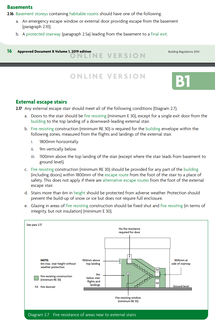

Alan Ambrose Posted January 12, 2024 Share Posted January 12, 2024 OK here: https://assets.publishing.service.gov.uk/media/639ae7e98fa8f5069839c7d7/Approved_Document_B__fire_safety__volume_1_-_Dwellings__2019_edition_incorporating_2020_and_2022_amendments.pdf Page 16: 1 1 Link to comment Share on other sites More sharing options...
saveasteading Posted January 12, 2024 Share Posted January 12, 2024 Ok thats clear. Either/or. A protected route will always be the aim if the layout allows. 1 Link to comment Share on other sites More sharing options...

kandgmitchell Posted January 15, 2024 Share Posted January 15, 2024 On 13/01/2024 at 19:46, Gus Potter said: This is where it gets complicated by the need for open plan living. Could we substitute "need" for "desire". England is pretty straightforward. If you have habitable rooms in a basement then either bring it's access stair up into a protected hallway with a final exit or provide an alternative escape from the basement. 1 Link to comment Share on other sites More sharing options...
