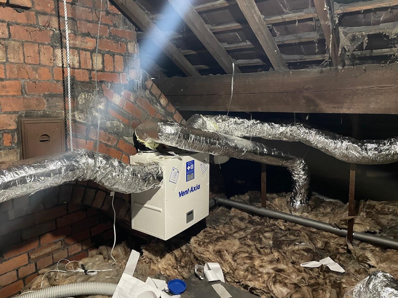

IGP Posted January 10 Share Posted January 10 I installed a Vent Axia Sentinel FH in my 1930’s semi in a cold loft and it’s performing quite well. I just wrapped everything in insulation (photo without everything fully insulated). 1 Link to comment Share on other sites More sharing options...
