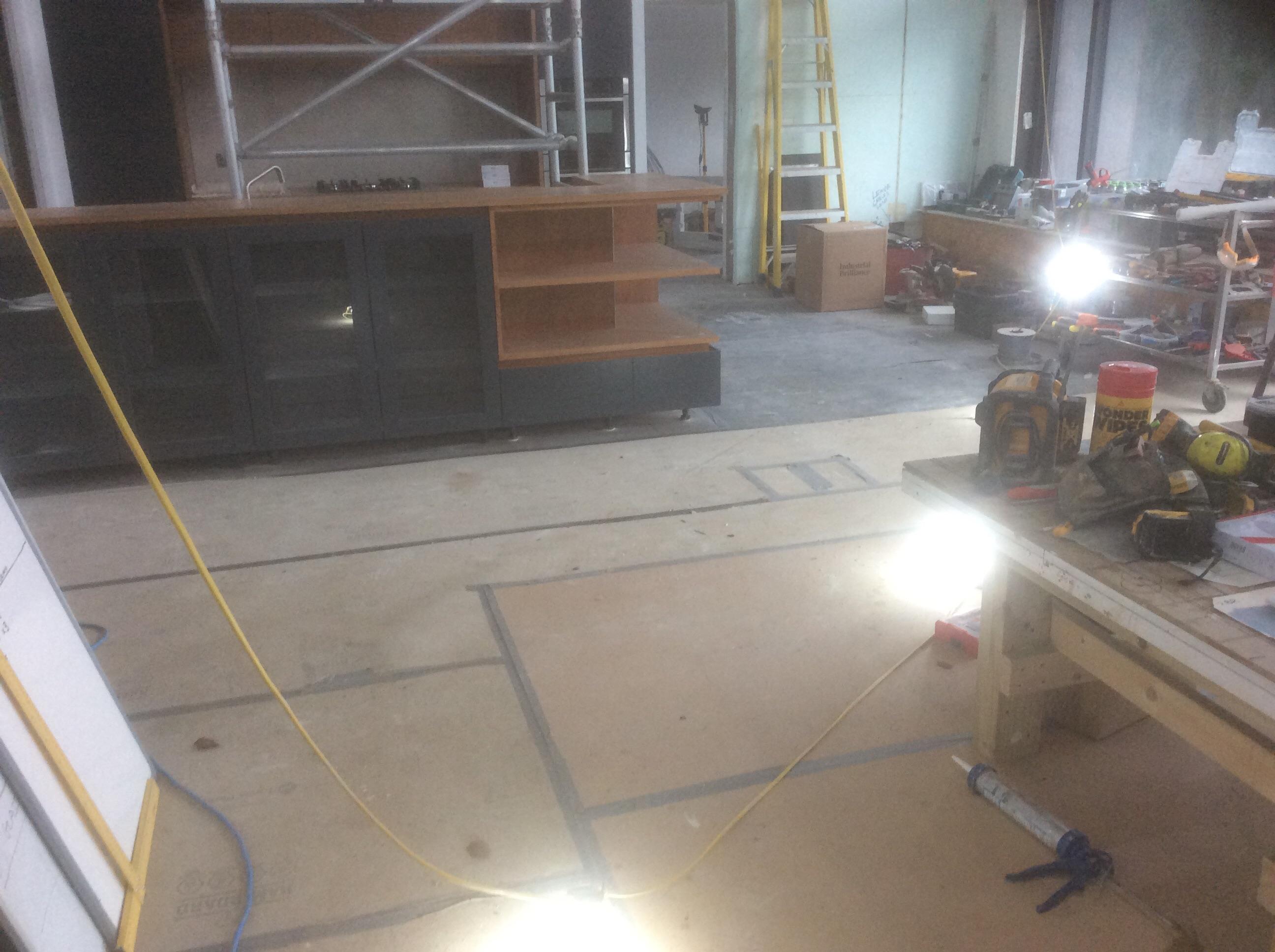

Do not use the cling film stuff, I have seen too many posts of it not coming up well if left too long.
Plastic antinox boards everywhere all taped together, then hardboard sheets in high traffic or work areas.
I managed to buy 20 sheets of hardboard on Facebook from a contractor who needed to protect a sports hall floor. image.thumb.jpg.ec3bf7790fe5e2fd45bd6ece784f5135.jpg

I butted tight to the walls with the black plastic stuff, then cut it back room by room to fit skirting and so on, as things have progressed.
The black plastic is 100% useless for stopping dropped chisels and things, it is only good for spills and plaster splashes and stuff, definitely need timber boards if anybody working from steps and towers, a dropped claw hammer will make you have a heart attack.
As @Russell griffithssaid do not use cling film stuff,  I spent about 5 hours 1 evening until 11pm getting up about 1.5sq/m before the customers furniture turned up the next day for them to move in.
Antinox and tape to edges cut back for skirting, it will not stop damage from dropping sharp or heavy things, do not cut anything on it either as is no protection to a knife. Hardboard is a good idea
