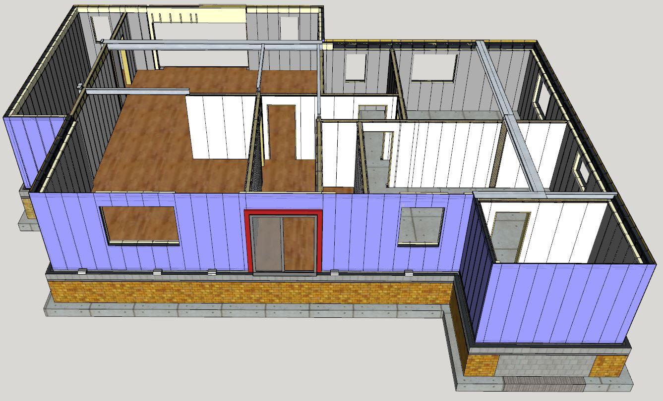

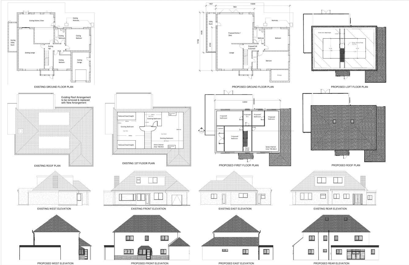

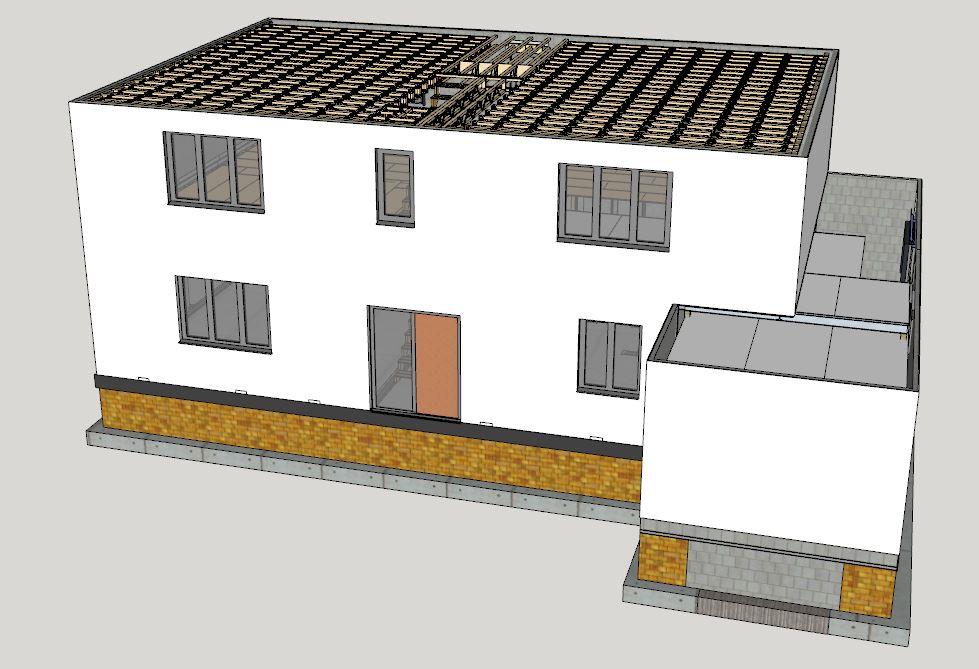

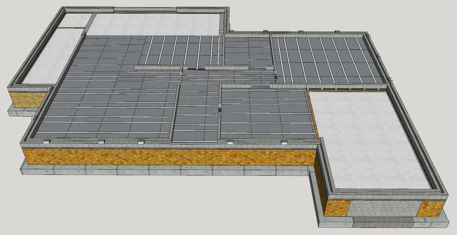

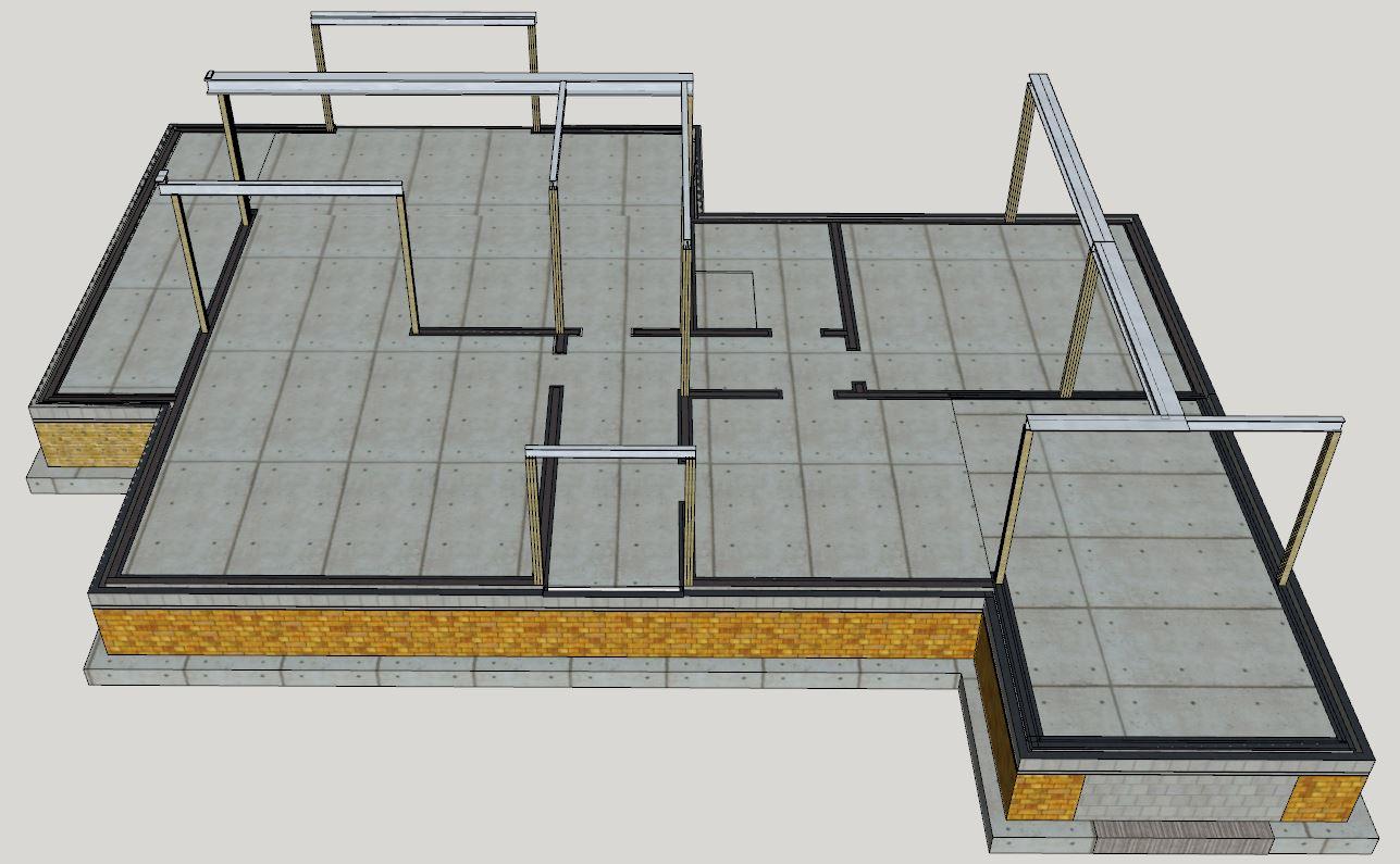

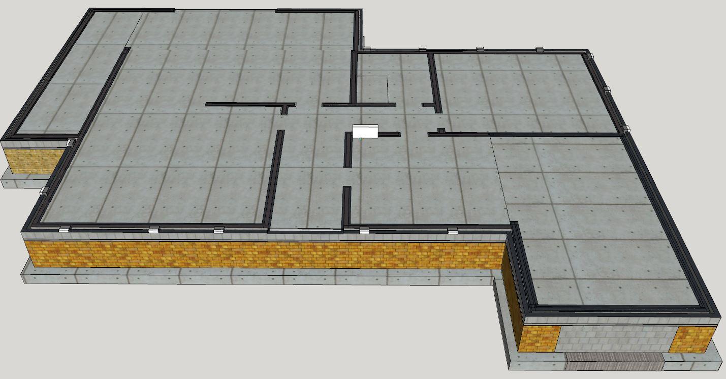

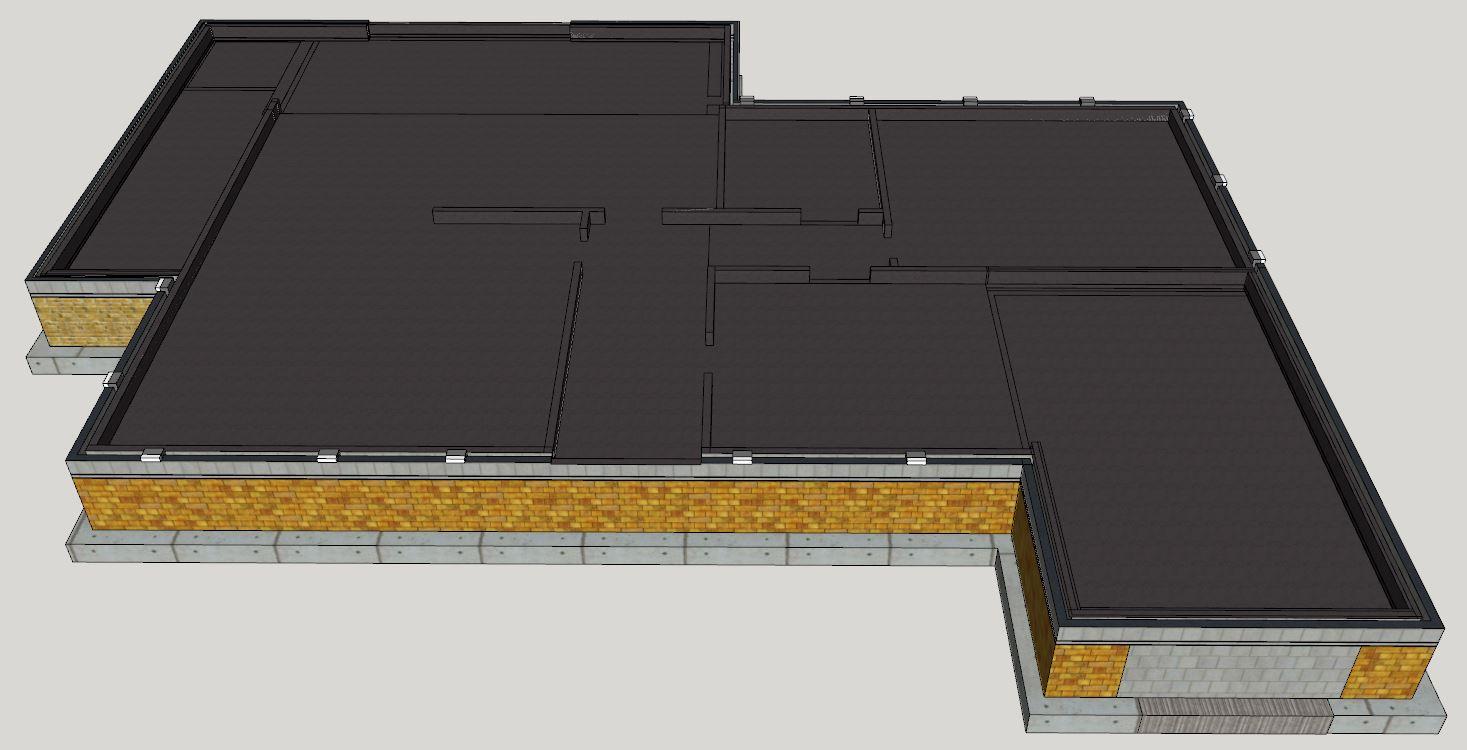

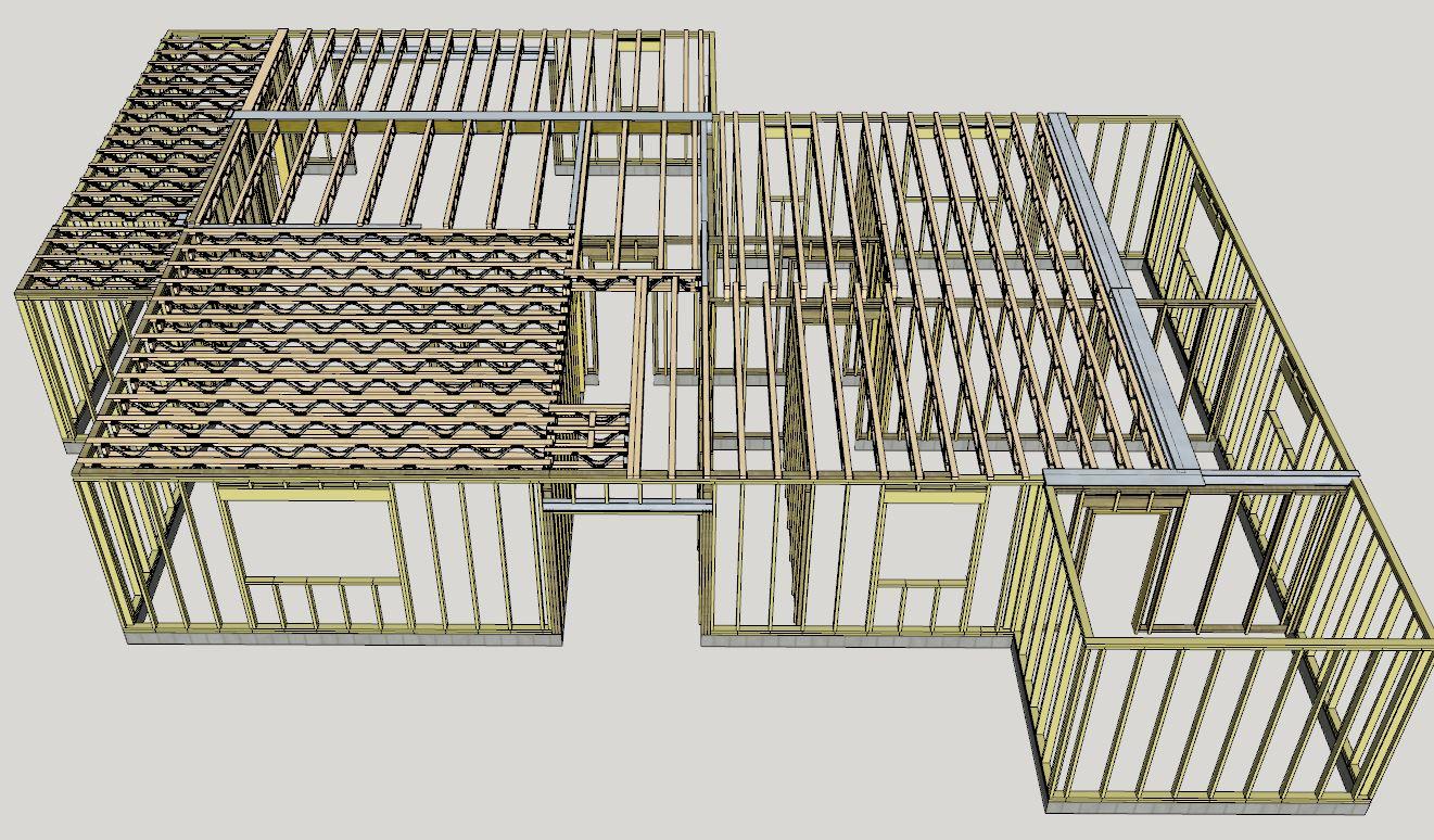

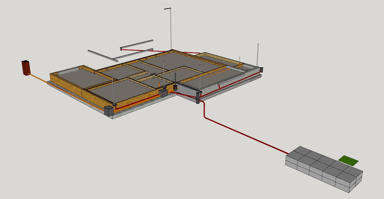

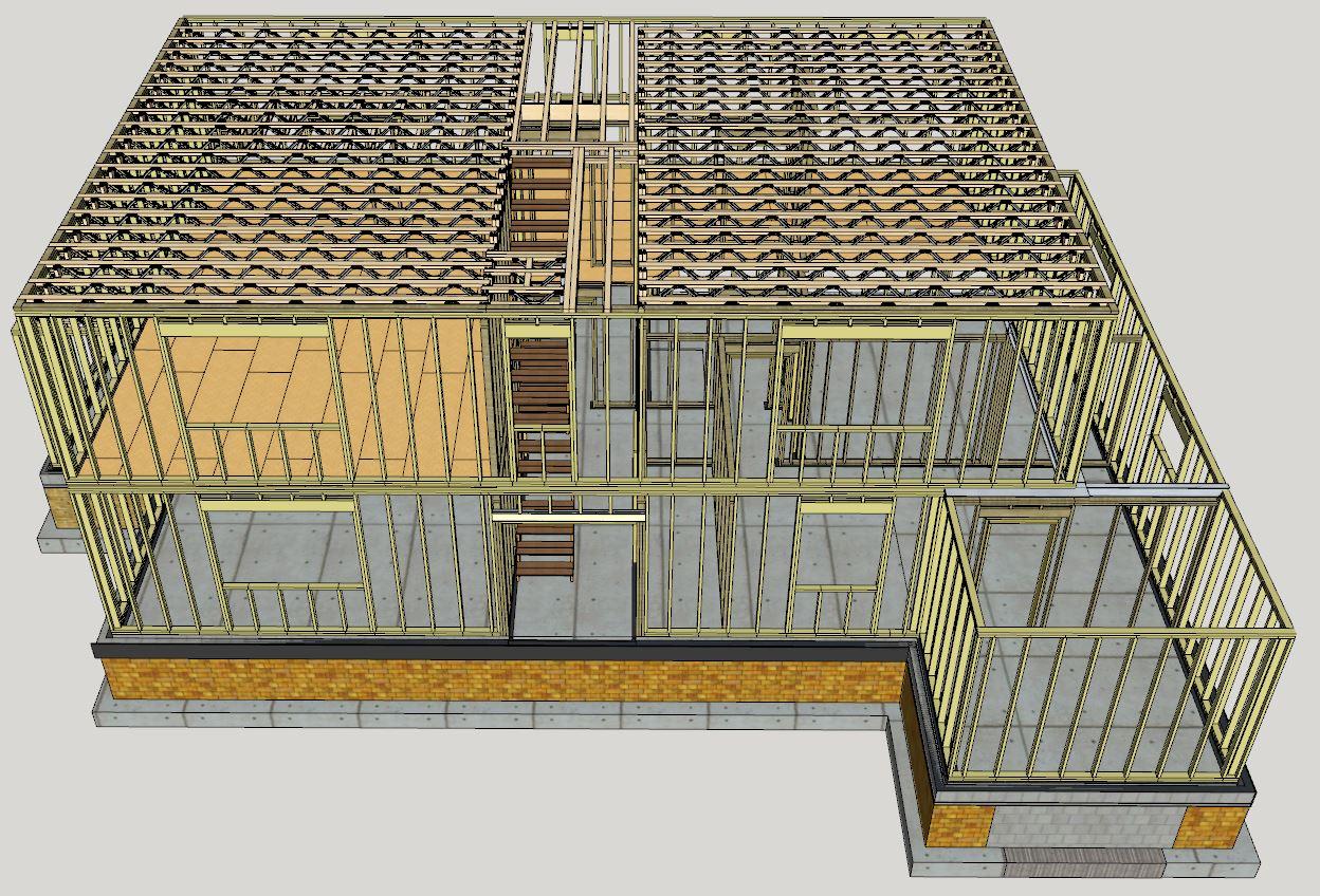

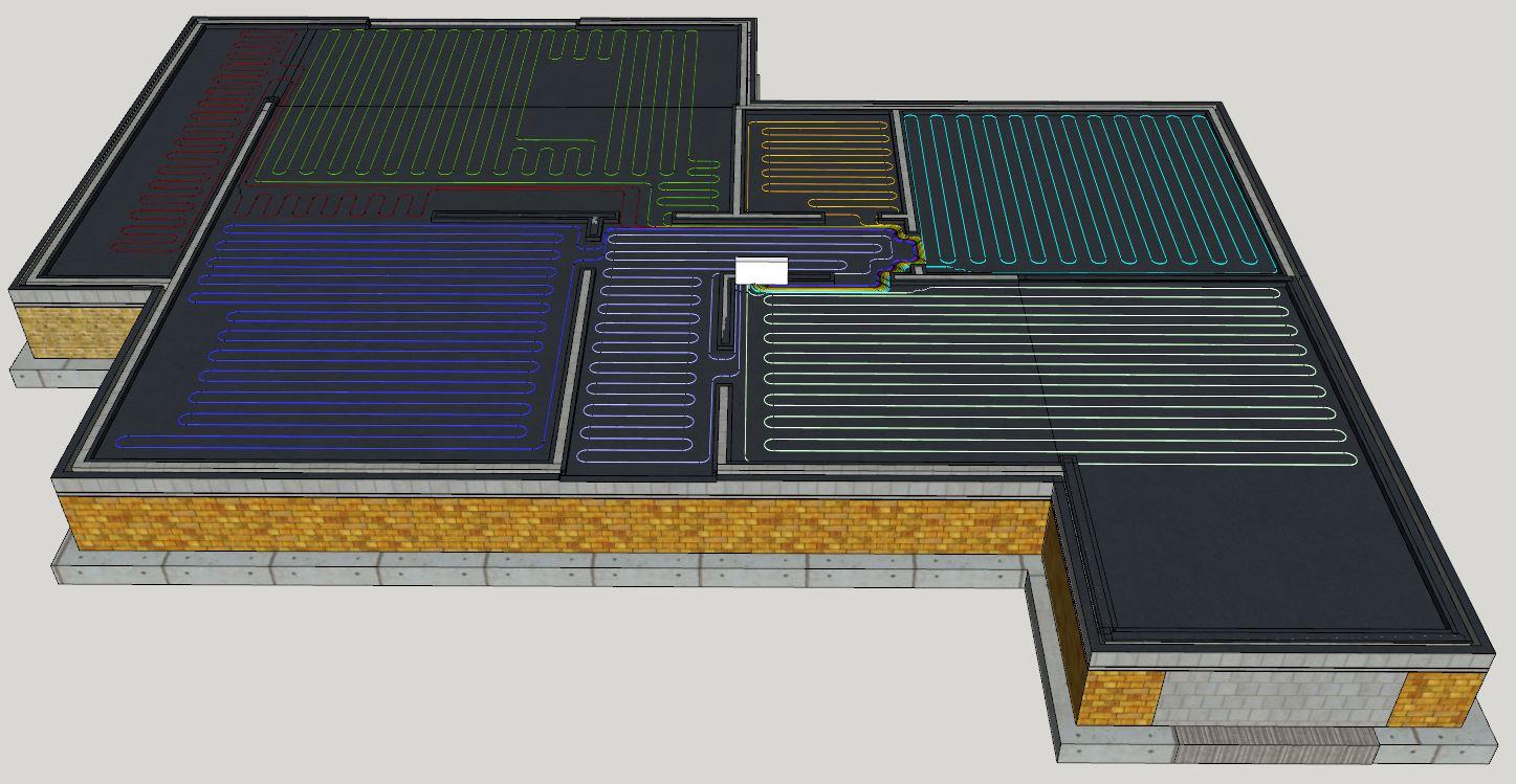

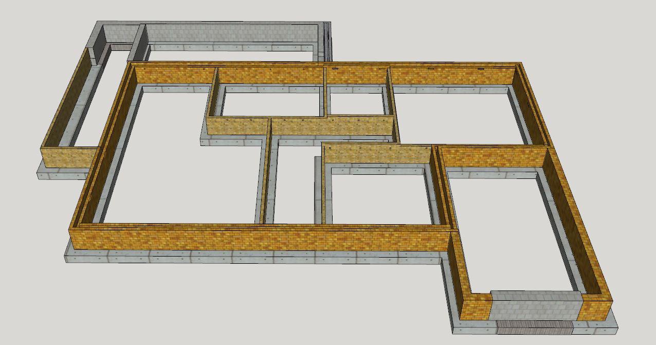

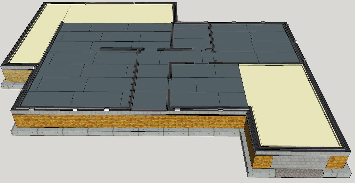

PhilC Posted January 5, 2024 Author Share Posted January 5, 2024 (edited) Some pics, work in progress still Edited January 5, 2024 by PhilC add planning drawings 2 Link to comment Share on other sites More sharing options...
LiamJones Posted January 5, 2024 Share Posted January 5, 2024 2 hours ago, PhilC said: Some pics, work in progress still Nice, they looks awesome, what software are you using? It’s far more than I did, I just had sections of key areas and a floor plan! So I’m sure BC will be happy Link to comment Share on other sites More sharing options...
PhilC Posted January 5, 2024 Author Share Posted January 5, 2024 Sketchup make 2017 free version 1 Link to comment Share on other sites More sharing options...
