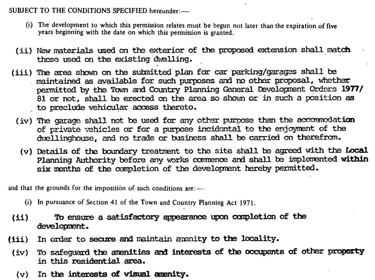

johndeere Posted January 2 Share Posted January 2 Hi We are converting an internal garage which needs PP due to it being a condition of the original PP to build the extension in the 80s. Anyway, we are keeping the roller garage door and building a stud wall 60cm back from it so the room is going to be 4.5m x 3m. It already has a window to the front of the house so visually from the outside nothing is changing, it’s literally going to be stud walls, raising the floor and insulation. PP seems to be site plan and location plan which I can buy online Then a before and after floor plan to scale. Then elevation drawings to scale but do I need these if nothing is changing visually? If it’s just a scaled floorplan, I feel like I can do this myself to save the architect fees? Thanks Link to comment Share on other sites More sharing options...

johndeere Posted January 3 Author Share Posted January 3 Thanks all, sounds like the Removal of PD condition + appeal might be the first port of call as this will not require drawings anyway. These are the conditions listed against the original extension: Link to comment Share on other sites More sharing options...
johndeere Posted January 3 Author Share Posted January 3 Fee seems to be £357 including VAT for Removal/variation of conditions Link to comment Share on other sites More sharing options...
kandgmitchell Posted January 3 Share Posted January 3 No doubt the purpose of the original condition was to ensure there was sufficient parking on site. As part of the application I would add a blockplan showing that even without the garage being available there was still adequate parking within the site. Ideally I would look up the relevant car parking standard for your size of house (i.e number of spaces for bedroom number) and show how you still satisfy that standard once the garage is discounted. Link to comment Share on other sites More sharing options...

kandgmitchell Posted January 3 Share Posted January 3 So what will be your reasons for amending or removing the condition? Link to comment Share on other sites More sharing options...

Alan Ambrose Posted January 3 Share Posted January 3 >>> Just submit the application and see what the LPA say. Left to their own devices, the LPA may just repeat whatever guff they had in the original '80s permission. Hence, I think it's best to try and get some informal engagement with the case officer if possible with the argument that time and PD have moved on since then. Link to comment Share on other sites More sharing options...
