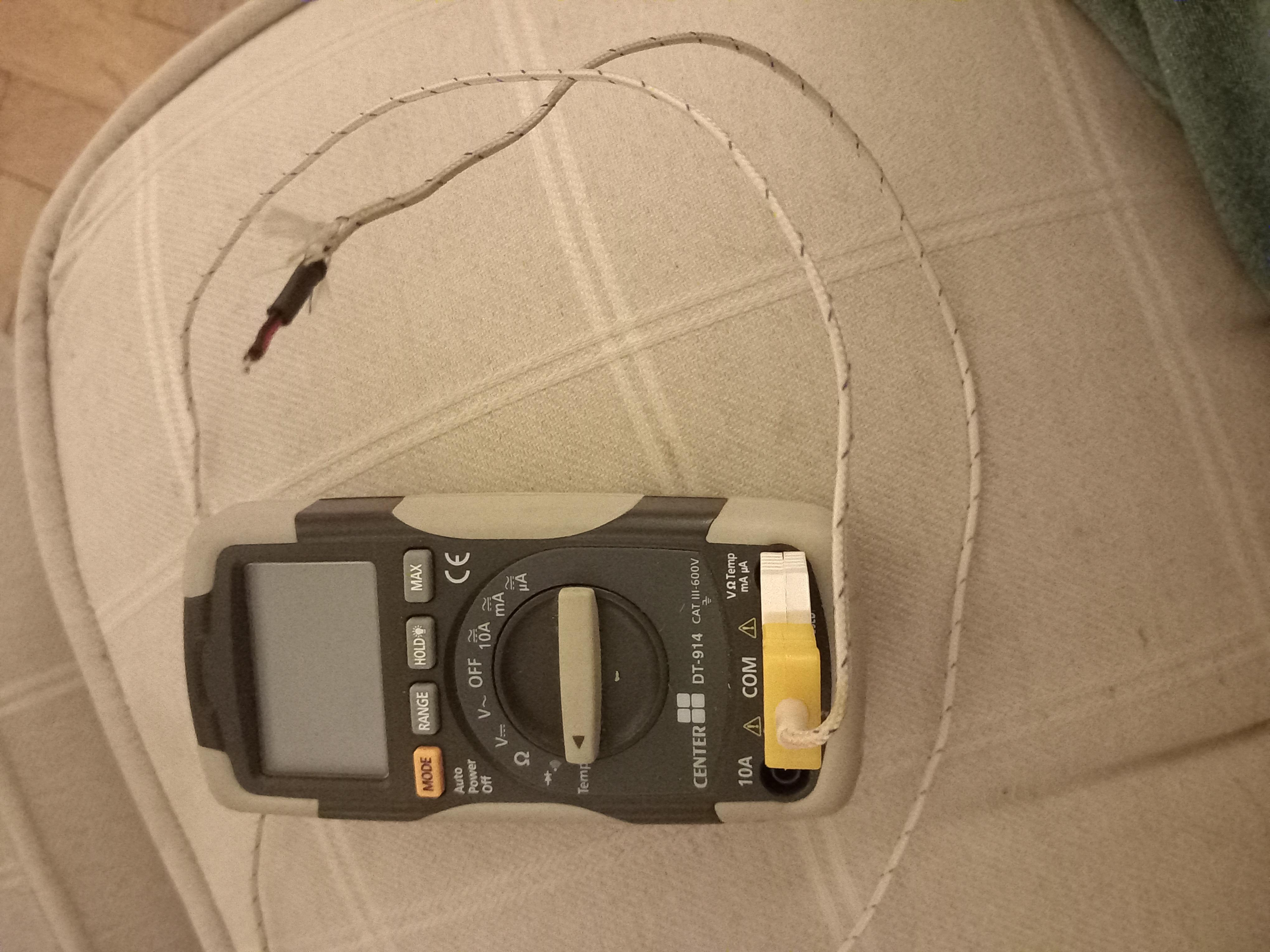

Dee Posted December 19, 2023 Author Share Posted December 19, 2023 2 hours ago, SimonD said: Be patient My biggest flaw!! However, I have balanced the system in the past from scratch and it worked perfectly but for unkonwn readons its decided not to. its a big house, and as the flow branches off in all directions I find it tricky to establish the order by which the rads heat up...is this critical? Boiler is a very recent Baxi 400 with a heatrea sadia tank. Photo attached of the multimeter I'm using. Nearly all of the LSV are literally barely cracked open atall and the rads are sooooo hot, is this normal?? Your process is invaluable and the first few steps I've never considered, so I will start there... (most Googles don't even mention those steps). We had the system put in 18 yrs ago so I can't recall much about the spec. Thankyou so much! Link to comment Share on other sites More sharing options...

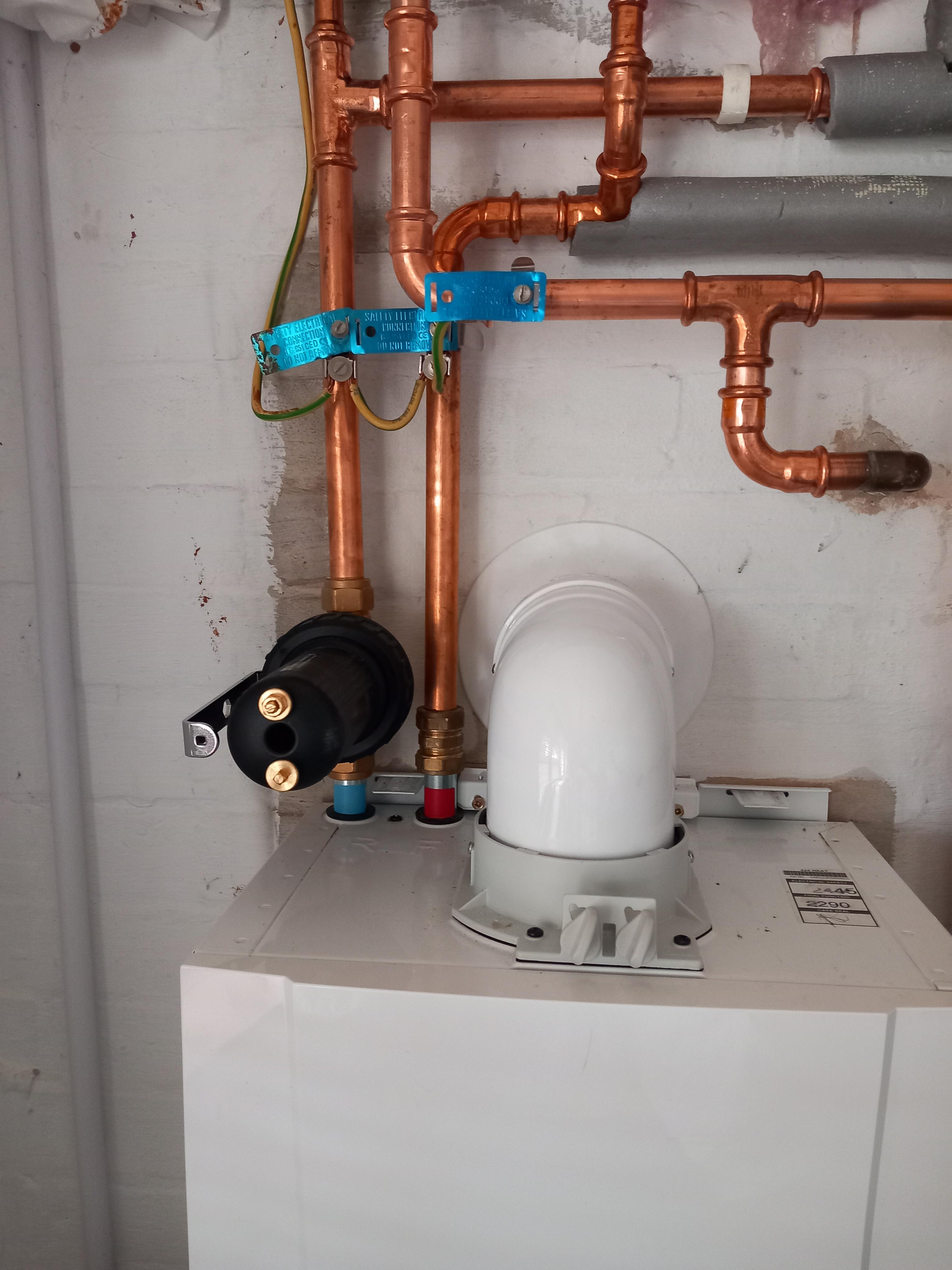

SimonD Posted December 28, 2023 Share Posted December 28, 2023 17 hours ago, Dee said: Aha! I have 18 hot rads!! My concern is though the temp diff varies massively from 1⁰ on rad #11 upto 23⁰ on rad# 9! On 14 rads the TRV pipe is hotter than the LSV side and the LSV on rads furthest away from the boiler are open no more than 1/8th if that. In fact I would state that all the LSV are open open no more than 1/8th. Does any of this matter? Hope you all had a peaceful Xmas....Dee Great progress! What are your flow and return temps at the boiler? These are going to be the most important because you want to make sure the boiler is in condensing mode for as much time as possible. It needs to be under 54C but just below 50 is better. 1 Link to comment Share on other sites More sharing options...
Dee Posted December 28, 2023 Author Share Posted December 28, 2023 Are they the pipes with red and blue tape? Is that black thing the pump? Link to comment Share on other sites More sharing options...
SimonD Posted December 28, 2023 Share Posted December 28, 2023 3 hours ago, Dee said: Are they the pipes with red and blue tape? Is that black thing the pump? Yes, it'll be the pipes with red/blue tape. The black thing is what looks like a Magnaclean Atom system filter so not your pump. The pump is probably in your airing cupboard with the hot water cylinder. 1 Link to comment Share on other sites More sharing options...
Dee Posted December 28, 2023 Author Share Posted December 28, 2023 5 hours ago, SimonD said: It needs to be under 54C but just below 50 is better. The hot pipe from the boiler is reading 56⁰.....how do I get it below 50⁰? Link to comment Share on other sites More sharing options...
SimonD Posted December 28, 2023 Share Posted December 28, 2023 1 hour ago, Dee said: The hot pipe from the boiler is reading 56⁰.....how do I get it below 50⁰? Measure the temperature of both pipes once the heating has been running for a while as we want to see both temps and the difference between them. Link to comment Share on other sites More sharing options...
Dee Posted December 28, 2023 Author Share Posted December 28, 2023 7 hours ago, SimonD said: Cold pipe is 44⁰ hot pipe is 58⁰ Link to comment Share on other sites More sharing options...
SimonD Posted December 29, 2023 Share Posted December 29, 2023 16 hours ago, Dee said: Cold pipe is 44⁰ hot pipe is 58⁰ So you're not far off. As you've got some rads without much drop, I would be throttling back the flow a smidgen there. You'll only need to turn the LSV a small number of degrees, then wait and repeat as necessary. Then test flow/return temps again. With respect to your pump, do you know what setting this is on? Link to comment Share on other sites More sharing options...
