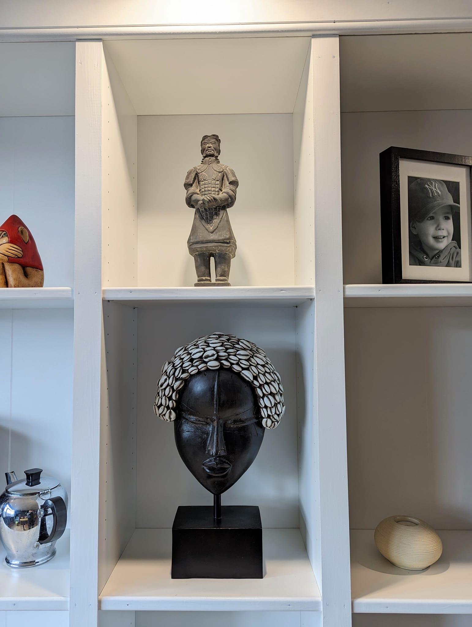

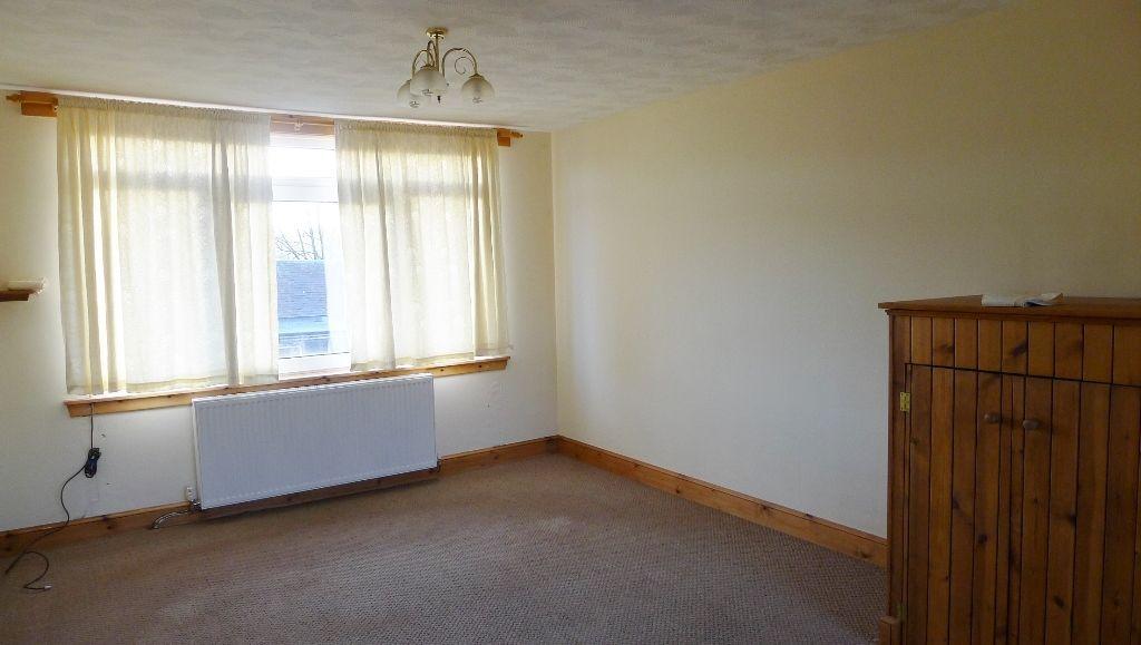

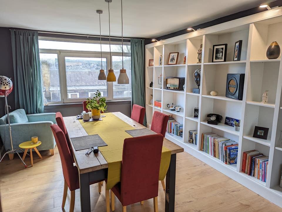

Here's the finished article, with the 'before' pic at the bottom for context. I'm pretty pleased with it, given the cost. The edge facing strips give the impression that it has been made with solid chunky timber and the round edge shelf cover strips also hide the fact it is made with particleboard.

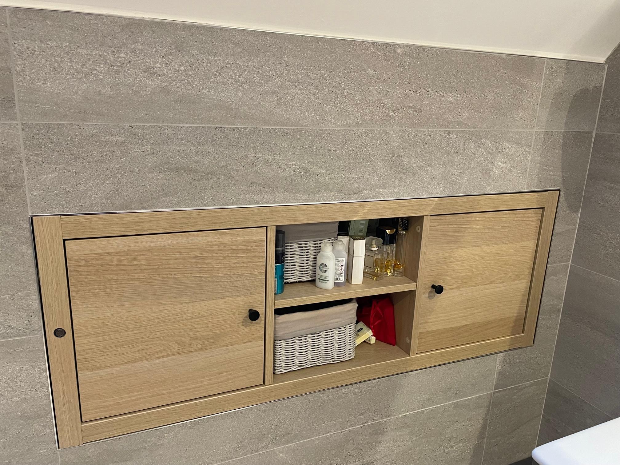

This is my Kallax IKEA hack. It's a 4x1 Kallax shelf, cut down to 3x1 (more difficult than it sounds), and then 90mm cut off the back to make it fit in the void in our sloping roof. Works very well - 5 years daily use and it's still as fresh as a daisy.
The small round thing on the left hand side is not a camera (!) but a light sensor for our LED floor flood light. For night time visits...
@Square Feet nice job - looks great and high end -  seen a lot of this kind of thing on TikTok.  Something I’ve always wanted to ask though / discouraged me from doing something similar.  Close up is there not a mismatch between the materials , the shade and texture of the ikea manufactured and melamine -v-  the hand painted facing timber.   And I always worried the hand painted part would in time fade/yellow and contrast with the melamine ?
It might I suppose, but it looks ok so far. It wouldn't be a big deal to freshen it up if it did start to look odd, but I think that would be many years off, if at all.
