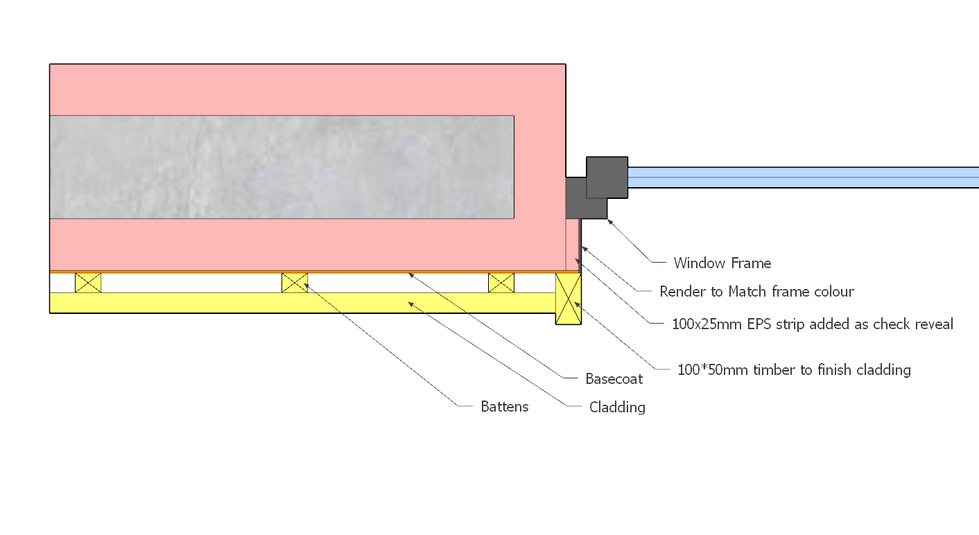

Andrewb Posted December 12, 2023 Posted December 12, 2023 Good evening, I'm currently working towards getting a survey done by my window company, so trying to get the openings into their finished state and apply a render basecoat. I've been looking at the reveal details and have done some sketches, so it would be great if I could get any feedback on them. The exterior finish is render on the ground floor and timber cladding on the first floor. There are a few windows which are vertically aligned on both floors. The openings in the nudura walls are identical width on both floors, but I'm keen that the cladding upstairs does not obscure the window frames so that everything lines up. Chamfering the EPS seems to be an option to me, but I wondered if others had any thoughts? Any comments on any other aspect also welcome!

Iceverge Posted December 15, 2023 Posted December 15, 2023 I would go the other direction. Add a 25mm strip of EPS onto the window reveal to cover 25mm of the frame. Thermally window frames are really weak and should ideally be hidden behind insulation. Render the reveals on the rendered section as normal and render the reveals on the clad section in a colour to match the window frames. You can have a common detail throughout then.

Iceverge Posted December 15, 2023 Posted December 15, 2023 Nice one @FM2015. See my idea for @Andrewb. Should be easy to execute and would be thermally superior to the first detail. I would do wider than 25mm frame overlap if I could. Use one of these to add the render.
Andrewb Posted December 17, 2023 Author Posted December 17, 2023 Thanks very much for these ideas. Having a common detail and the window bead for rendering both look good. I'm in Gloucestershire near the Severn, a little bit exposed, but not massively. The width of the fixed bit of my Norrsken window frames will only be 29mm, so I don't have a lot of space for an eps check reveal plus bead and I'd end up obscuring it completely, whereas I'd quite like to see a little bit of the frame ( though i do note the thermal points). I'm thinking of skipping the eps, but using the bead to render up to the window and as above skipping having timber in the reveal. However I've seen other threads suggesting rendering all the way through behind the window frame to aid sealing the window. I could still do this - first base coat, then fit window, then fit bead and second base coat and then final render?
