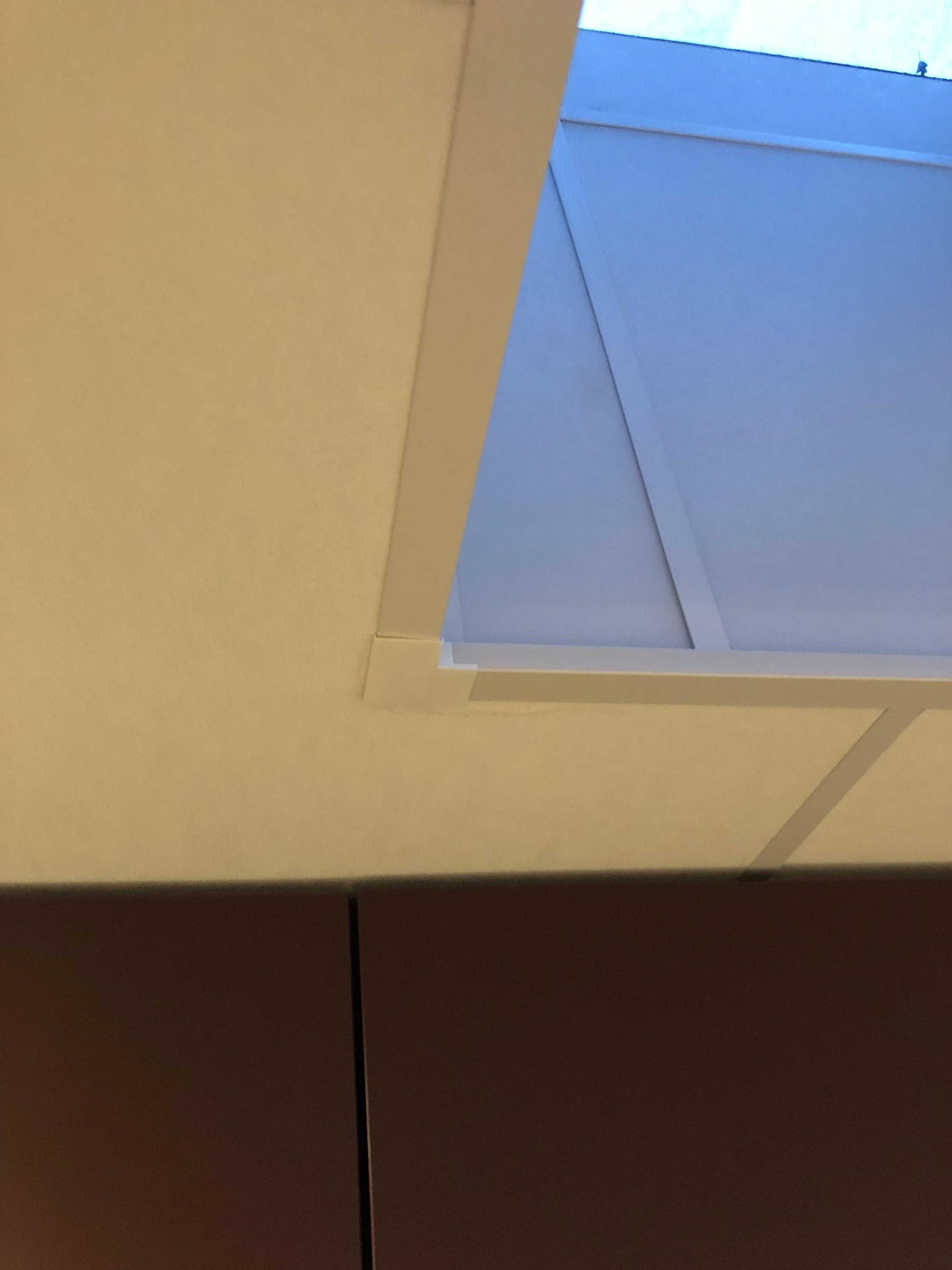

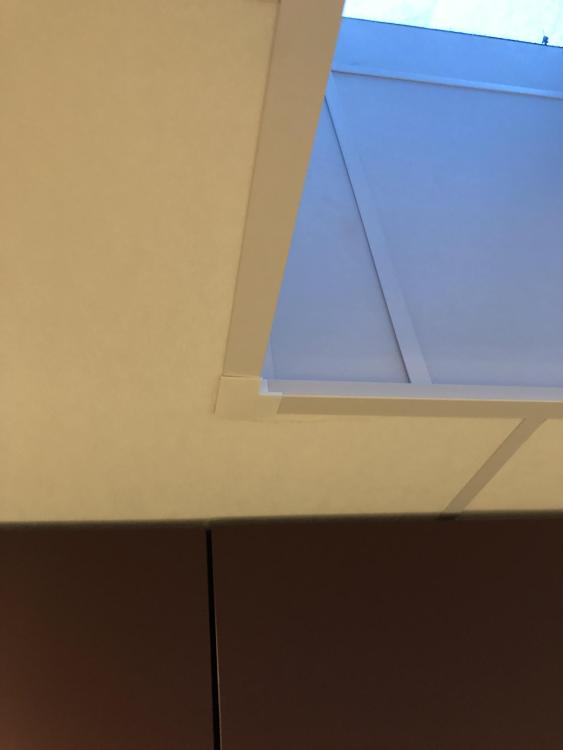

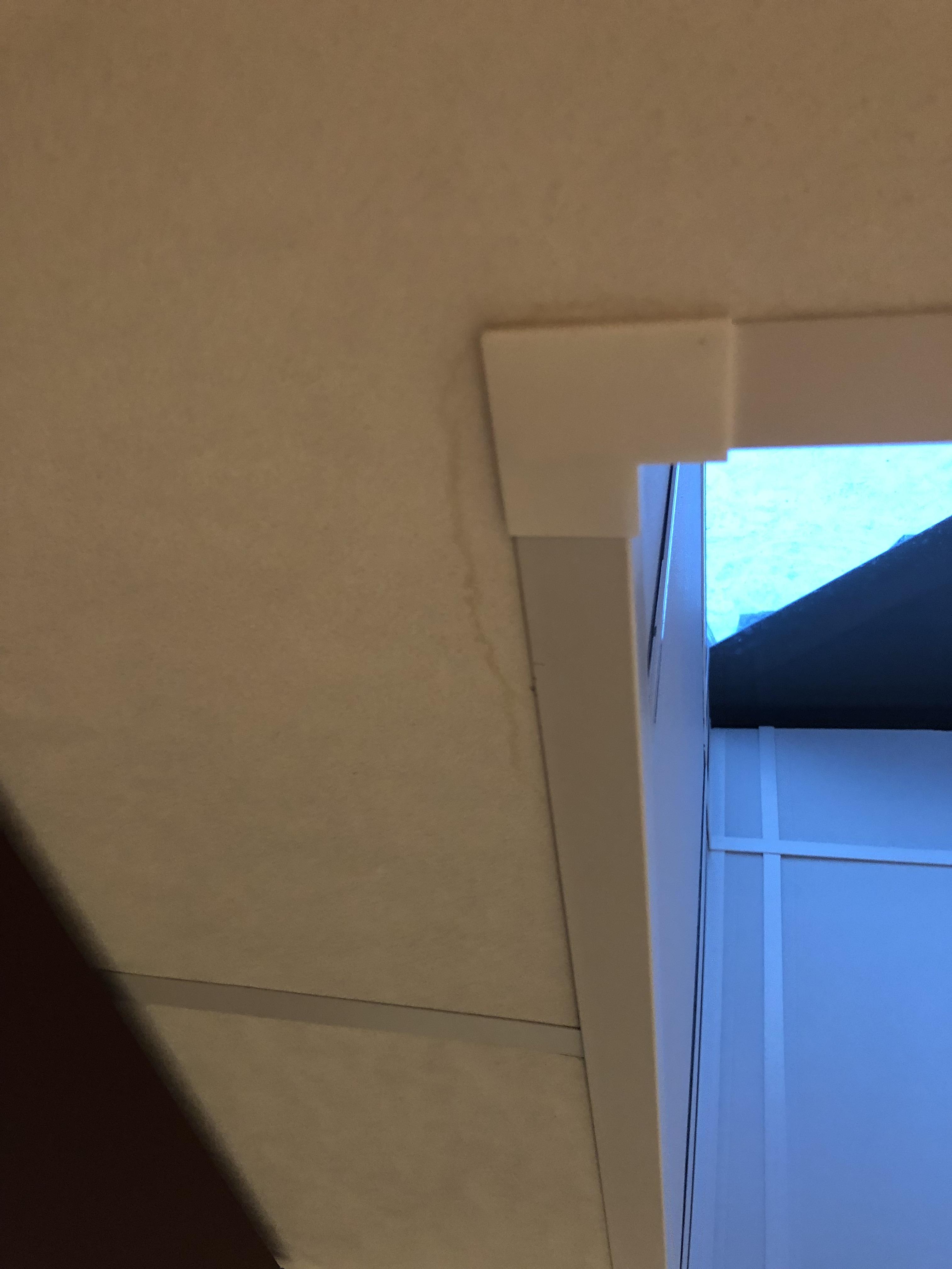

Pocster Posted December 10, 2023 Posted December 10, 2023 Not an issue yet . Roof light well is tile backer board with foil backed ceiling tile stuck to it . Ceiling had to be fire resistant tiles ( just a fibre glass backing ) Whilst not a major issue yet can only assume will get worse . I could get this tile out - but then what ? . Try and ‘line’ in the Lightwell backside ? . Cover back of replacement tile in foil ???

Pocster Posted December 10, 2023 Author Posted December 10, 2023 19 minutes ago, Mr Punter said: Suspended ceiling tiles get water stains really easily. Is there any way you could help prevent the condensation forming in the first place? Celotex? That’s kind of what I’m asking . Should I celotex the area on the upstand in the light well ? . Can just about get my hands in there …

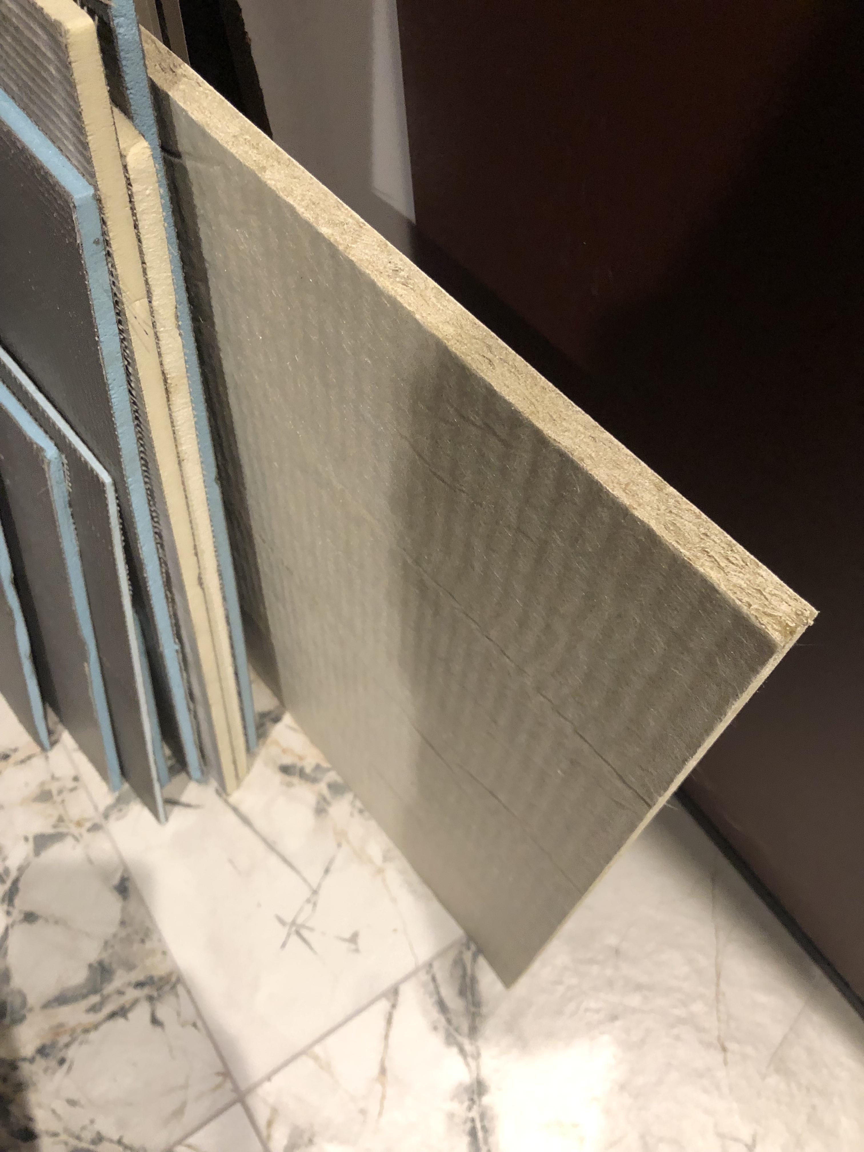

Mr Punter Posted December 11, 2023 Posted December 11, 2023 You may only need a couple of sheets of 25mm. Cheapish.
Pocster Posted December 11, 2023 Author Posted December 11, 2023 2 hours ago, Mr Punter said: You may only need a couple of sheets of 25mm. Cheapish. I’m only going to initially do that one side . I can’t do up to the glass as that is in the roof / floor . So just in the ceiling void . Maybe 30 cm by 60cm - something like that . Probably though buy 1 whole 25mm sheet
