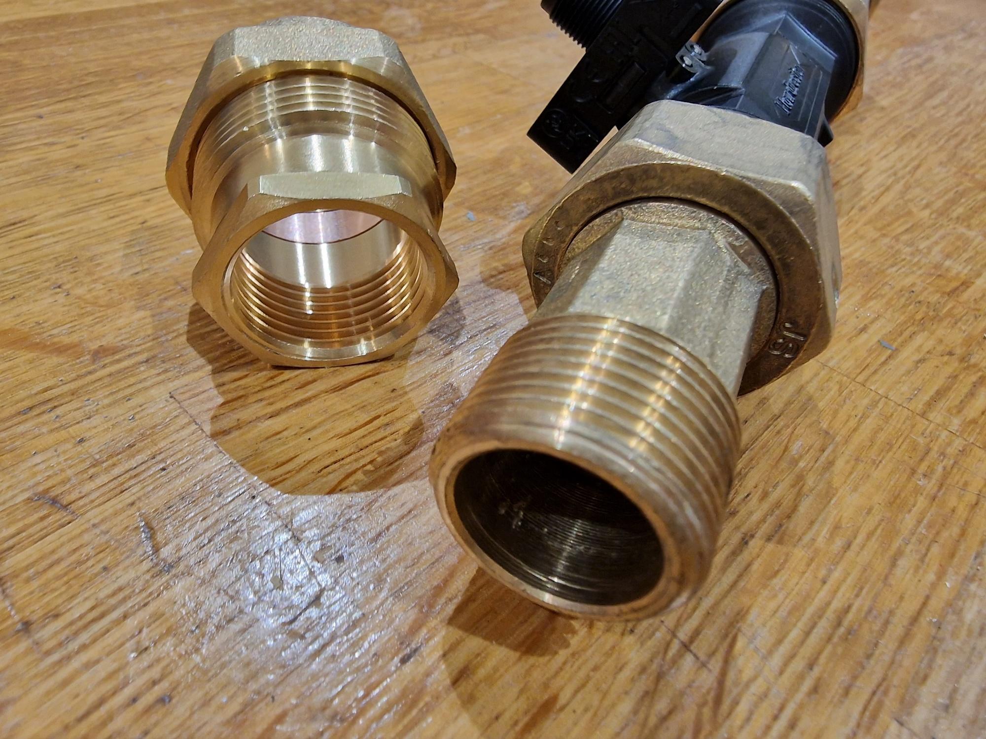

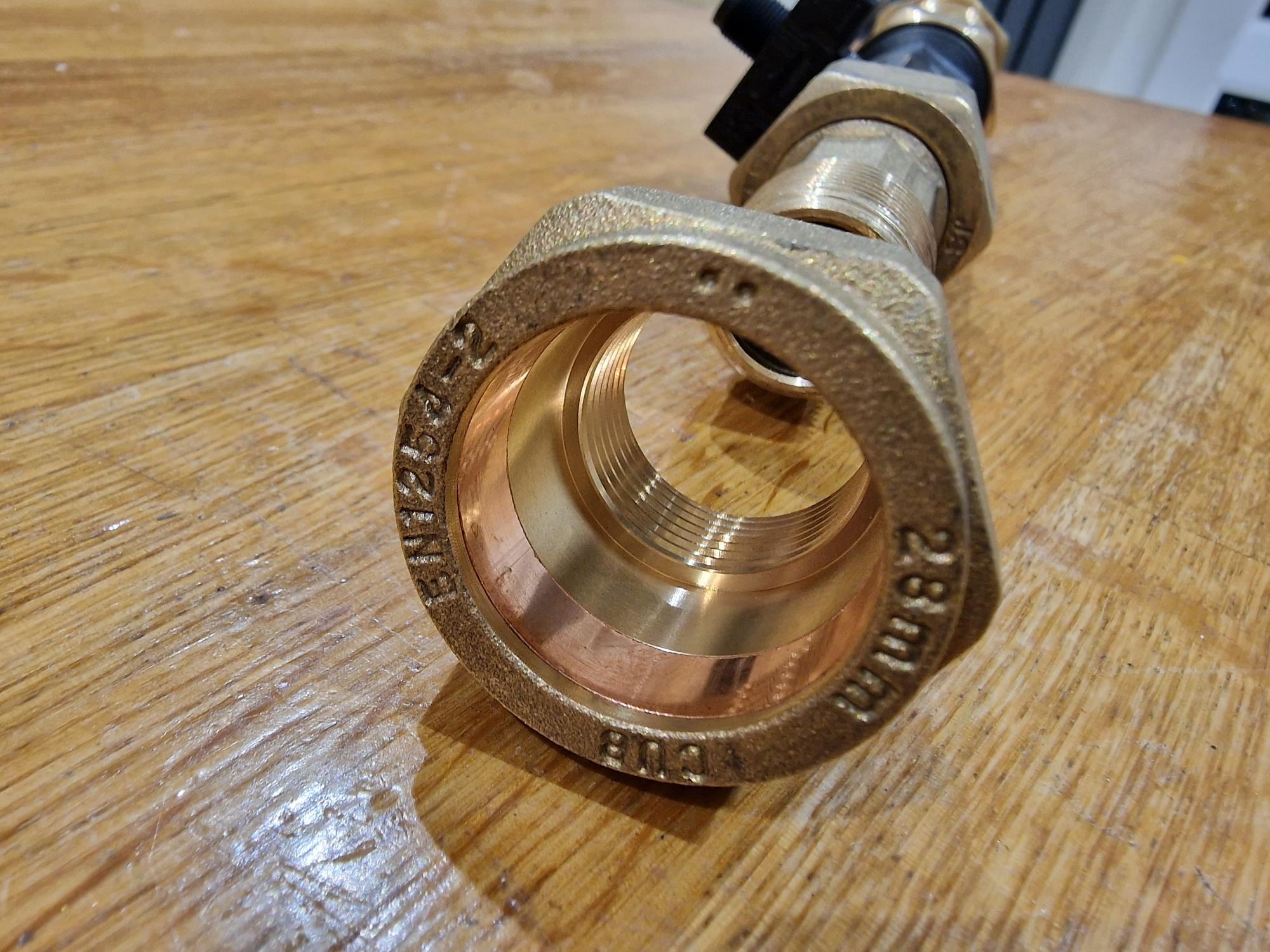

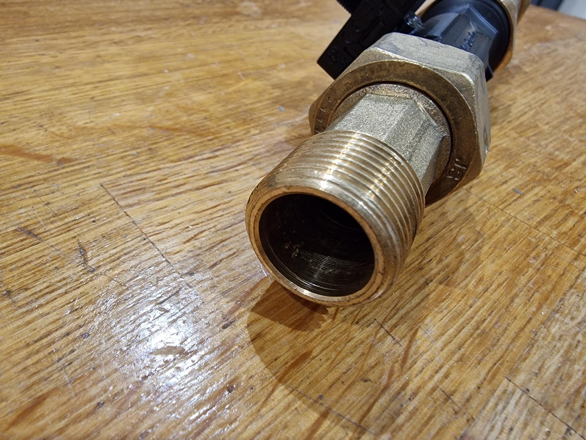

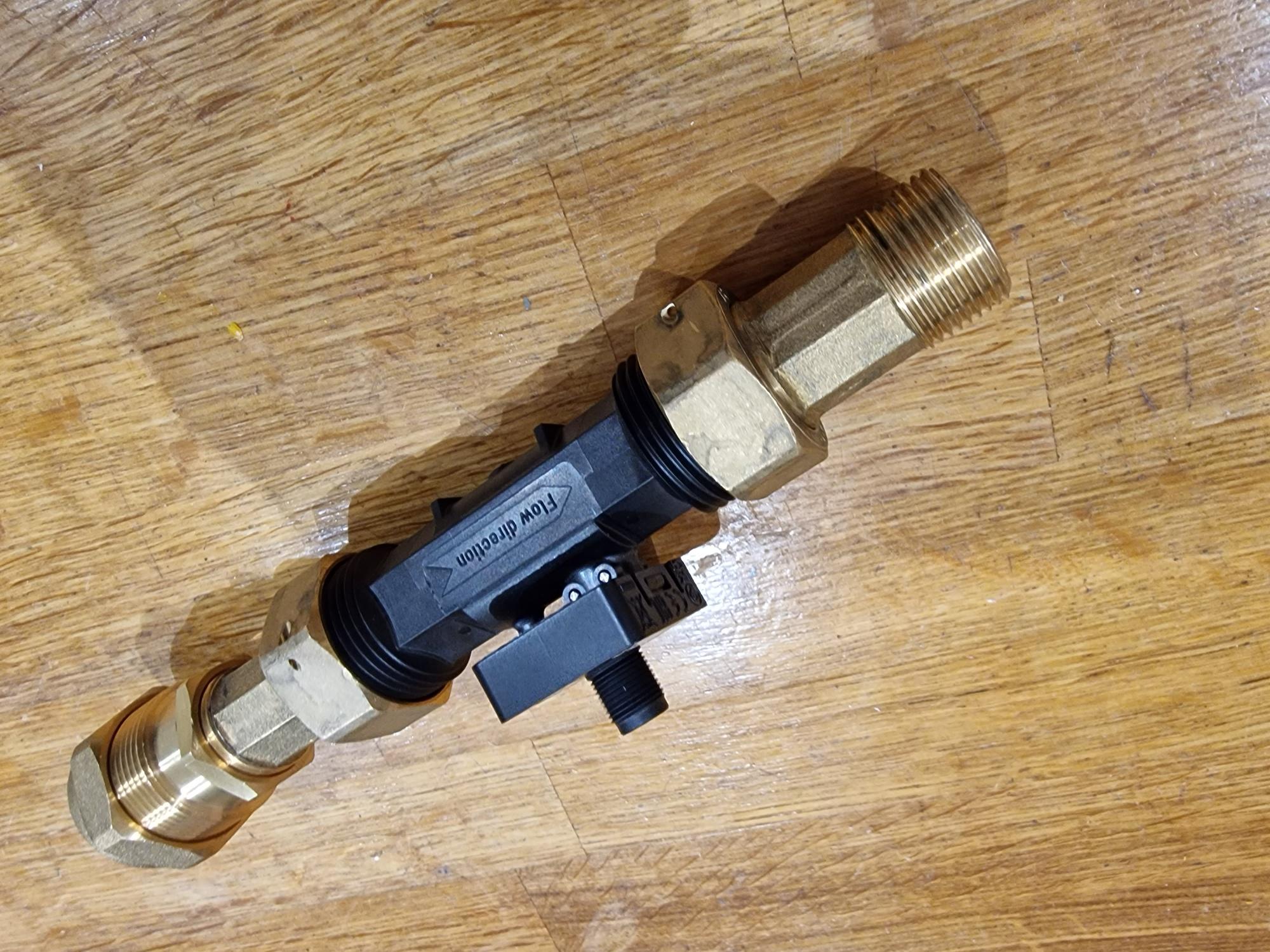

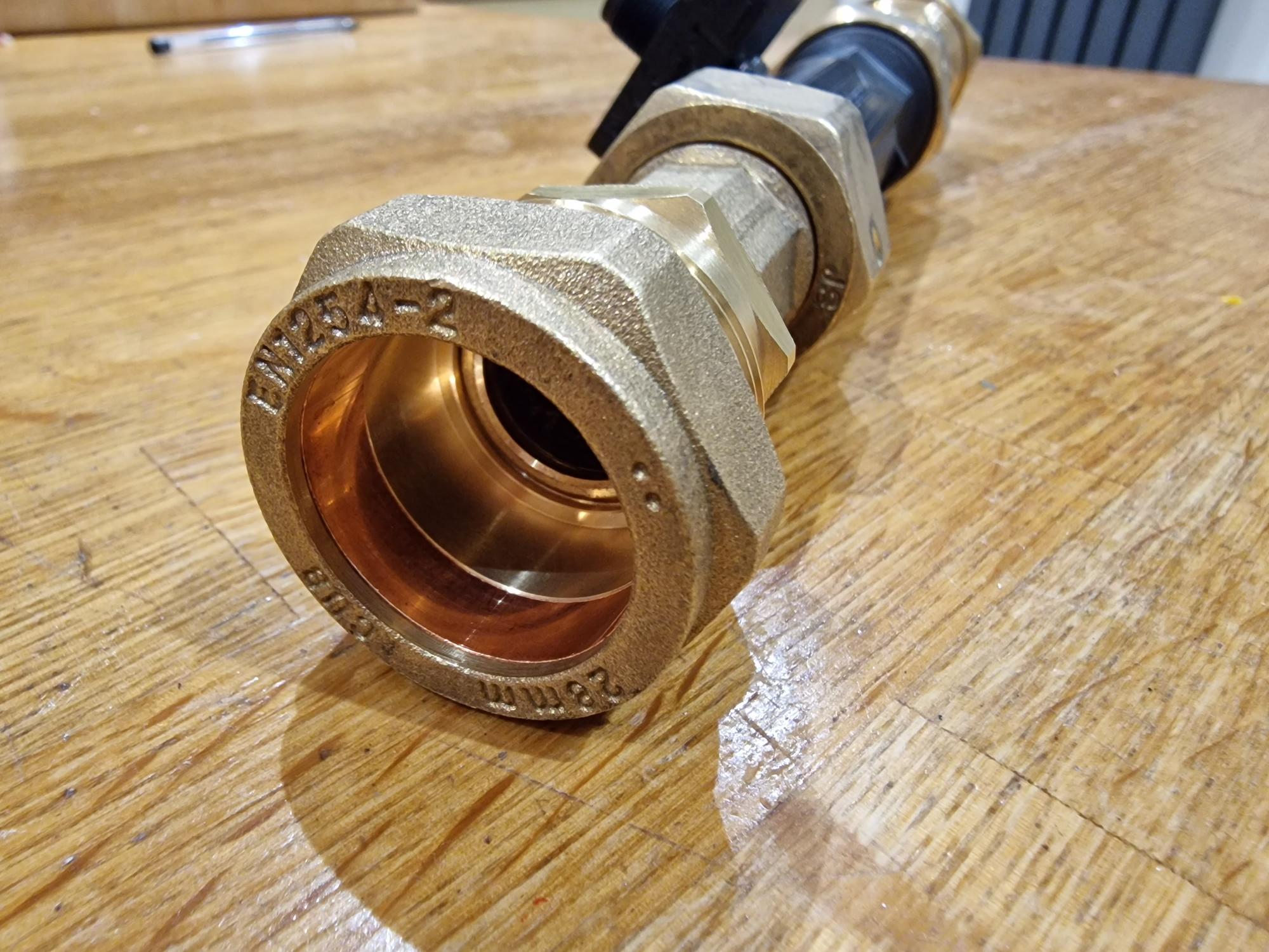

eniacs Posted December 6, 2023 Posted December 6, 2023 See photos. The gismo is a water flow meter for a heat pump. It has the same fitting as a water meter would do - 1 inch bspp plastic threads. I've bought unions which use a fibre washer and these seem to sit ok and look like it will seal. The problem is the unions came with a 3/4inch bspp male thread. I've bought a BSPP female to 28mm compression fitting, but there doesnt appear to be anywhere for a washer to go, so how on earth can I seal this? Or have I bought the wrong fitting? Note - I've already destroyed 1 flow meter getting this wrong... Thanks
markocosic Posted December 21, 2023 Posted December 21, 2023 Generic stuff available at Screwfix https://www.screwfix.com/p/flomasta-pipe-sealing-cord-80m/2272v 1
JohnMo Posted December 21, 2023 Posted December 21, 2023 Wrap the thread in PTFE tape. Do around 15 time around, sounds a lot, but does work. Wrap clockwise, and run your fingers around the PTFE tape to smooth it off and push it into the threads. Or Screwfix do a liquid PTFE, apply tighten and then leave while you have a coffee to harden.
markocosic Posted December 21, 2023 Posted December 21, 2023 Try the string and you'll be a convert away from PTFE I promise! Liquid seal is good if - if - you have the time to wait for it to cure and you don't then disturb the joint. The waxed string on the other hand can be busted/moved a little bit after fitting (e.g. to realign a fitting) and will still hold pressure.
