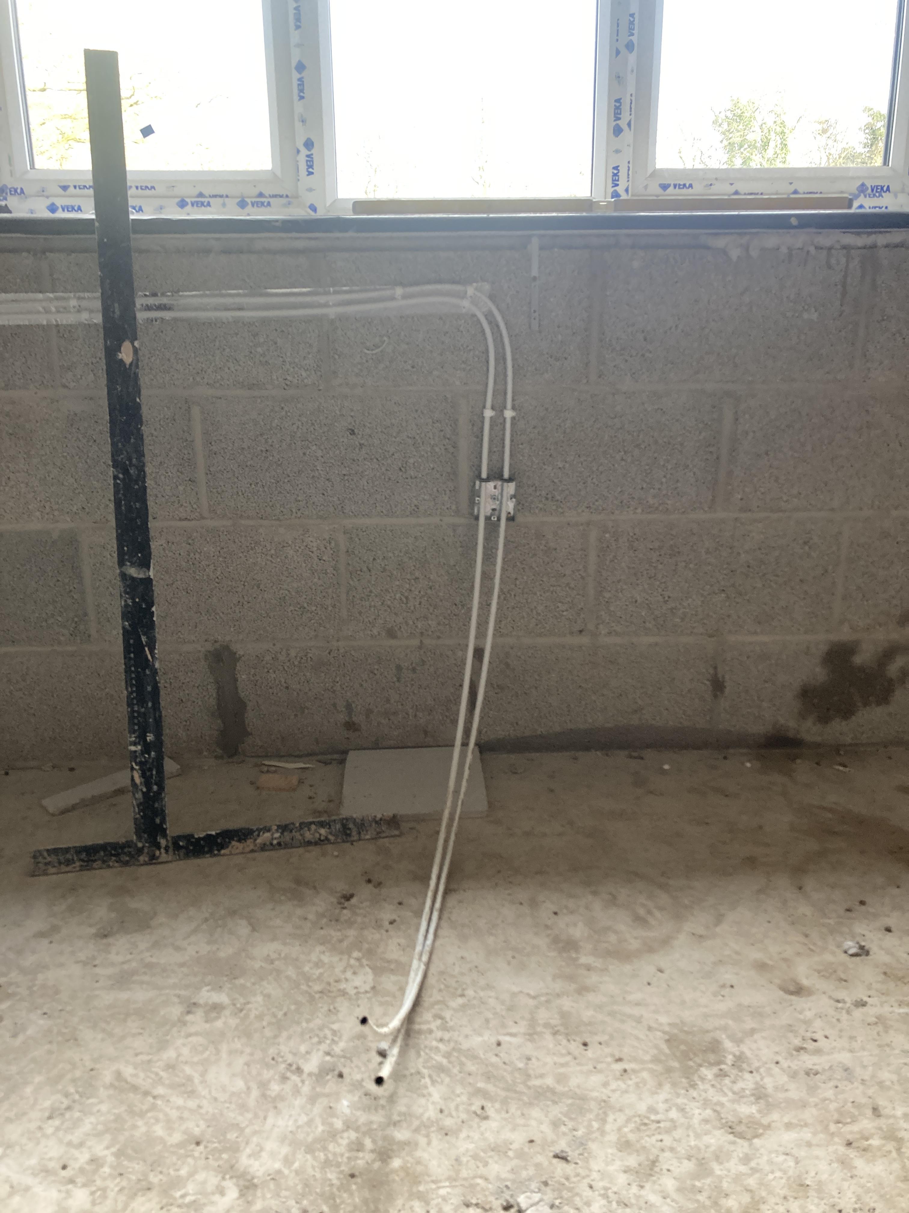

RichJ Posted December 5, 2023 Share Posted December 5, 2023 Hi I've seen a few posts on here where it's been mentioned that if you're using Pex-Al-Pex pipe, you can bring the pipes up from the floor in the centre of radiator... looping the pipe round and down behind the radiator then into the TRV/lockshield. Has anyone got any pics of what this looks like when done? My plan is to convince the missus this is a good option rather than going with copper from the tails to the floor. Link to comment Share on other sites More sharing options...
nod Posted December 5, 2023 Share Posted December 5, 2023 1 hour ago, RichJ said: Hi I've seen a few posts on here where it's been mentioned that if you're using Pex-Al-Pex pipe, you can bring the pipes up from the floor in the centre of radiator... looping the pipe round and down behind the radiator then into the TRV/lockshield. Has anyone got any pics of what this looks like when done? My plan is to convince the missus this is a good option rather than going with copper from the tails to the floor. 1 Link to comment Share on other sites More sharing options...

RichJ Posted December 10, 2023 Author Share Posted December 10, 2023 Thanks for the photo Nod. But how would you connect the plastic pipe to the lockshield/trvs? I'm assuming it's not into the bottom of the valves like copper pipes coming up from the floor would do. Link to comment Share on other sites More sharing options...
dpmiller Posted December 11, 2023 Share Posted December 11, 2023 90deg chromed pushfit reducer Link to comment Share on other sites More sharing options...
