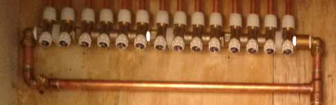

  12. Hi I'm trying to work out what I need to implement a DHW manifold setup. I have a query re the hot water aspect. I'm planning to run a 22mm cold mains feed from the main stop tap down to a Viessmann 100 combi, tee'ing off just before the boiler (in 22mm) to a cold DHW loop like shown in the photo (photo obviously lifted from another post on here). The DHW loop will be made up of 22mm copper and Wavin Hep2o manifolds. The hot DHW will come from the 15mm output from the boiler and run in 15mm to a hot DHW loop. In contrast to the cold DHW, the hot DWH loop will be made up of 15mm copper and Help2o manifolds. My question is, if I just feed the hot DHW from the boiler straight into a manifold with no loop in the pipework so the water can only flow into the manifold from one direction, will this prioritise hot water to the ports closest to the inlet? Is this a means of say prioritising the feed to the shower?
