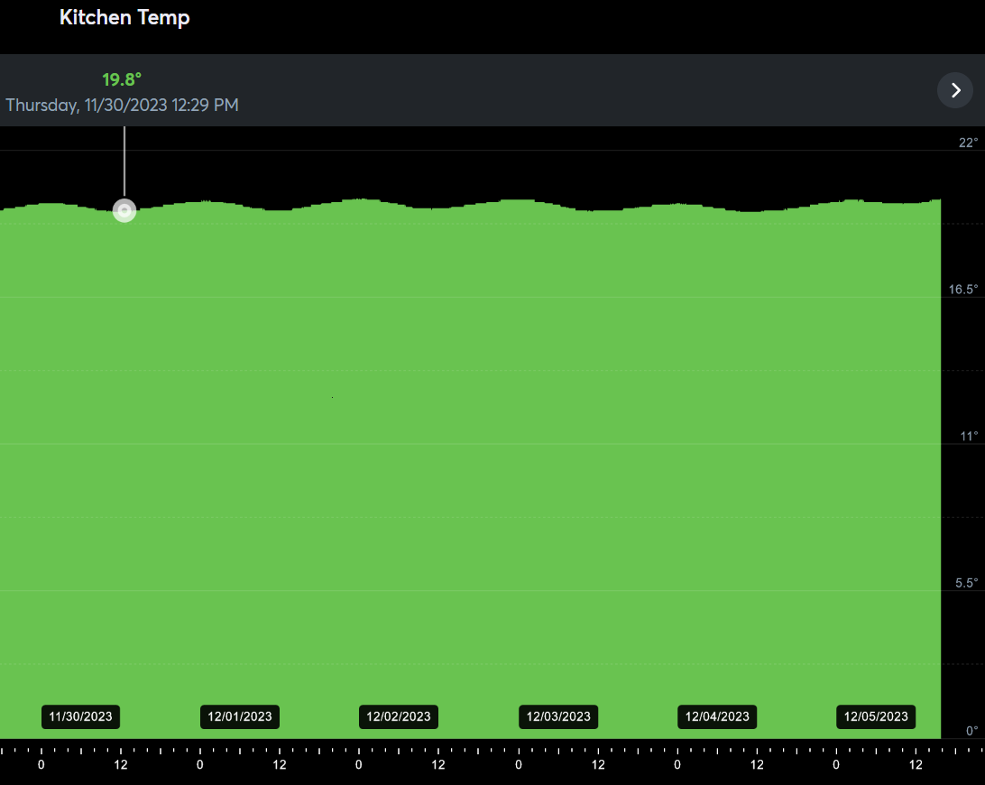

jack Posted December 5, 2023 Share Posted December 5, 2023 5 hours ago, Maxwell_Montes said: whilst the floor isn't cold cold, its just warm enough when the system runs but I'm doing it for hours to get to 24c, but as I said when it turns off, that temp creeps up for a bit. How thick is your screed (or slab, if the UFH pipes are in that)? Ours are in the slab underneath about 70 mm of polished concrete overlay, and it takes 3 hours for a change of 0.1 °C to be apparent at the floor surface. The floor surface takes about 12 hours to increase by 0.3-0.4 °C once it starts rising. Here's the slab temperature under the kitchen island over the last few days, with the ASHP running 12 hours a day. Lowest temp was 19.8 °C, highest was 20.2 °C: Admittedly this is an extreme case given we run our flows temps quite low (25-28 °C depending on outside temps), but UFH does react very differently to radiators. Link to comment Share on other sites More sharing options...
