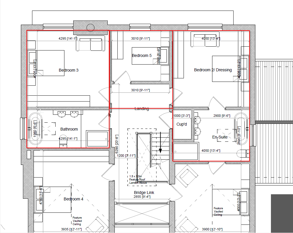

richo106 Posted December 4, 2023 Share Posted December 4, 2023 Good Evening, as you can probably tell by my latest posts that I am working in the loft! My next dilemma is the loft boarding, I have 8 x 2” (200x47mm) @ 600mm centres ceiling joists upstairs and I am planning to install 200mm isover spacesaver in between the joists and then the same ran over the top perpendicular. What would be the best way to board the loft when insulating this way? Legs? Never used them before but I just feel they maybe be quite flimsy. Is there a way to firm them up at all? The only thing I am not too keen on is tongue and groove floorboards as they are pain to get access beneath if needs be. But if that’s the best option then so be it. Many Thanks Link to comment Share on other sites More sharing options...

richo106 Posted December 5, 2023 Author Share Posted December 5, 2023 Thank you @S2D2 and @Redbeard I will be going with the Loft Legs XL Sorry for more daft questions, do you glue the boards together? And I'm guessing you can screw into the loft legs to fix the boards done Would it best to use the larger sheets? 18mm chipboard - 2400mm x 600mm I have around 66m2 to do (see attached picture) Link to comment Share on other sites More sharing options...

S2D2 Posted December 5, 2023 Share Posted December 5, 2023 10 hours ago, richo106 said: Thank you @S2D2 and @Redbeard I will be going with the Loft Legs XL Sorry for more daft questions, do you glue the boards together? And I'm guessing you can screw into the loft legs to fix the boards done Would it best to use the larger sheets? 18mm chipboard - 2400mm x 600mm I have around 66m2 to do (see attached picture) Yes I used 2.4x0.6m 18mm sheets, staggered joins and you screw the boards to each leg. No glue, didn't see the point and in case of access. Link to comment Share on other sites More sharing options...
